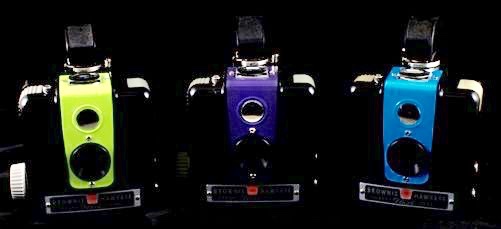

I have a few that I have flipped the lens in and painted custom colors, obviously inspired by Randy of Holgamods:
https://www.flickr.com/photos/60348236@N07/albums/72157633773953911
