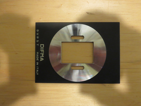

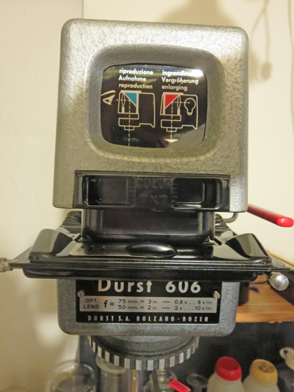

In this time of Covid where I have more time on my hands, I thought it might be a could time to analyze and evaluate an older Durst enlarger that came into my possession about 3 years ago which I rescued at a rummage sale and the church begged me to take it for $3 or it was going to the dumpster. It was mostly complete except for a “Ixopla” lens board for the 75mm lens. Later I acquired a “Difma” 35mm glassless adapter for the negative carrier.

Durst 606 Enlarger
Designed for exposing negatives 6 cm X 6cm or smaller.
1958-59 model…mine has 4 inch extension at baseboard to make column taller at 30 ¾ inches. Max height with head is 30 1/8 inches.
Made in Italy. Original price was $99.50 w/o lens.

Features:
1. Reflex housing…makes it compact and easy to take apart and clean.
2. Has 75 watt PH 211 bulb. Can use 150 watt bulb.
3. Internal Red safelight filter above the lens controlled by lower knob.
4. 7mm X 7mm filter drawer above bottom condenser. Somewhat stiff.
5. Comes with dual negative cups for long roll film…can be detached which I did.
6. Has two condensers with 2nd one attached to the negative carrier “Ixoneg”.
7. “Ixoneg” Negative carrier normally has glass for negative flatness. With “Difna” glassless insert for 35mm it makes it easier to center neg. For 2 ¼ leave glass in or purchase “Audix” glassless insert. Also has two knobs for masking and framing negative. Taking glass out is easier than putting it back in…somewhat tedious…two tiny screws with a small bar secures the glass and the “Difna”.
There is a device to hold individual negative…a plus. Being a normal glass carrier it is more subject to dust. The 2nd condenser will swing out when putting in the negative or if the carrier is already inserted in the head , there is a lift handle to allow insertion and negative orientation.
8. Centering 35mm negative is a little tedious especially when using all glass negative carrier.
9. Has round handle friction drive to raise head up and down…very slow but secure with no lock knob.
10. Focusing is using helical method…no bellows…a little slow but accurate.
11. “Ixopla” lens board can have 75mm lens mounted in reverse so as to make small enlargements.
12. Can tilt head 15 degrees for distortion control.
13. For extreme enlargements can swing around head to project on the floor.
14. Bulb can be moved around for Max brightness and evenness and secured with knob.
15. For 35mm enlarging using the 50mm lens with the "Ixotub" which is greatly recessed, I have lever attachment to adjust aperture by feel…it is nearly impossible to use this lens without this device.
16. Inserting lens board can be tricky…best to insert and move disk back and forth and sideways a bit before turning the set screw.
17. Overall with its quirks it is a VG enlarger…perhaps not as user friendly as an Omega B22.
18. The 4 inch extension appears to have been machined properly and it is probably not a Durst option…can be removed if desired but much shorter bolts will be needed.
19. Cosmetically and mechanically it is all VG. Also very complete with all the necessities. Baseboard is VG as well.
20. Takes down well and is quite compact. Can be set up in minutes. Can be easily stored away in a box.
