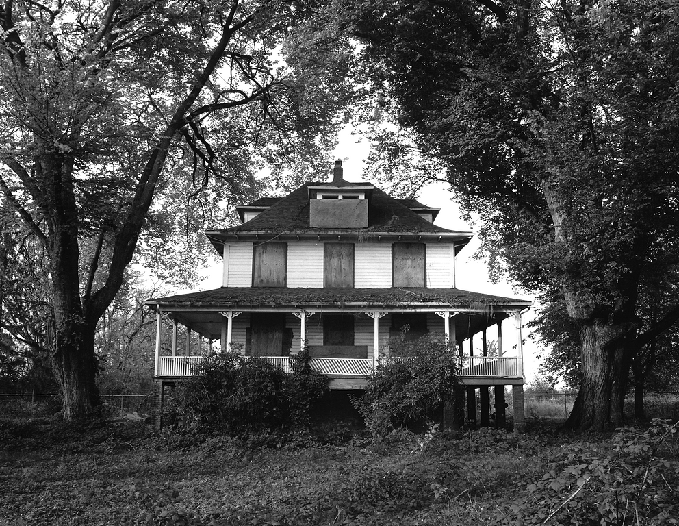

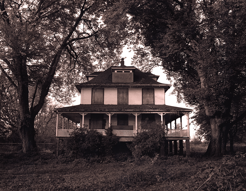

Here is a simulation of the effect of toning.
Without any warming:
With warming:
