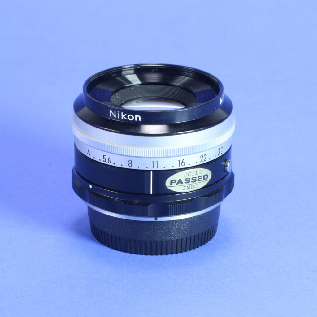

My Bellows-Nikkor 105/4 arrived yesterday, and I couldn't be more happy with it's condition: Basically no signs of use. I didn't realize it had the f-stop markings in the opposite order of normal Nikkors, but in actual use you turn the aperture ring in the same direction as normal (to the right to close the lens down): The f-stop markings are on the lens body rather than the aperture ring, which inverts the numbering order to maintain the traditional Nikkor stop-down direction. The aperture has detents every 1/3 f-stop which is very unusual, and goes all the way down to f/32 (diffraction!). It is of course not an Auto lens as it was intended for a bellows, and instead has a separate stop-down ring which allows for composing wide-open and then easily stopping down to the pre-selected aperture.
The Bellows-Nikkor aperture has 12-blades, and remains almost perfectly circular at every f-stop. Very few F-mount Nikkors had more than 9-blades as the body-activated Auto stop-down mechanism of the F-mount would struggle to handle the number of blades that S-mount (rangefinder) lenses often had. The older Bellows-Nikkor 135/4 (derived directly from an S-mount design) actually had 15-blades, but the 12-blades of the 105/4 seems more than adequate.
This is a very high quality lens, even nicer than my oldest Nikkor (a 105/2.5 P "Sonnar", probably from 1970). My Bellows-Nikkor is the last version (with lens data markings on the outside) from 1972, and is the 140th one manufactured. I will try it out on my PB-4 next, and in particular want to see how much coverage it provides with shift/tilt movements.

hope you enjoy.
I saw one spec. sheet on that bellows lens with a 23°20' angle of view. Seems like that is only going to just cover the frame at infinity, if that is true.
Interested to know how it works with bellows movements at close range.
IC, I've had a PB-4 for, um, 56 years. The movements are pretty useless.
For using the PB-4's movements at infinity, I have my Nikkor 120/5.6 AM-ED, which has more than adequate coverage (even though it wasn't designed for infinity usage, and doesn't cover adequately cover 4x5 at that range), but want to try out the Bellows-Nikkor at higher magnifications, where it should have enough coverage for movements. Will let you know how it goes! In any case, the Bellows-Nikkor is a very nice little piece of glass-history.
Finally was able to quickly try out the Bellows-Nikkor with the PB-4, and as I had always suspected, it's of very limited use at infinity:
  • It _will_ focus to infinity..
  • ..but the bellows is almost entirely collapsed (maybe 2-3mm short of fully collapsed), so NO movements are possible at infinity
  • Even at closer distances where movements are possible, the image circle is pretty limited, so it will quickly vignette
  • The Nikkor 120/5.6 AM-ED is _much_ better for playing with the PB-4, and will even allow for (almost) full movements at infinity (though it is of course not optimized for that range)
That being said, the Bellows-Nikkor is a nice little piece of history and finely made. I will have to see if it can give good results (within its limitations)
