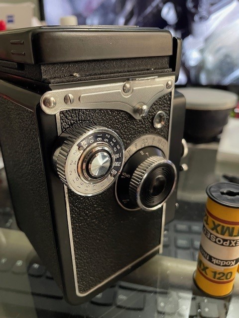

Hello all!
Found this beautiful-looking Yashica D TLR.
All speeds sound different (I know that sound does not mean accurate), close to what I understand they should be based on other mechanical cameras I have… again, I am aware it does not mean they are accurate.
I have one question related to the self timer… I place it on X, and after setting speed and cocking, I activate the self timer last, and shoot. The timer “works”, albeit longer than normal, with some erratic movement (runs-stops-runs)… I am assuming it might be a dried up lube issue.
Any feedback greatly appreciated; will be testing this weekend and I will be sure to share images.
Thanks!
Laurent

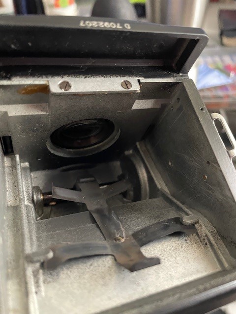

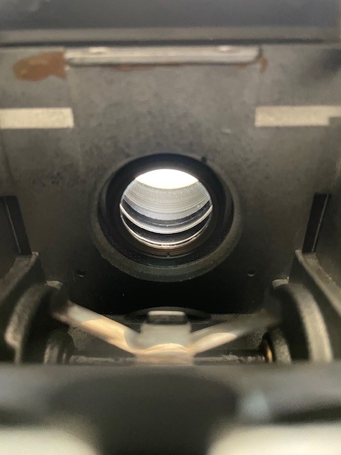

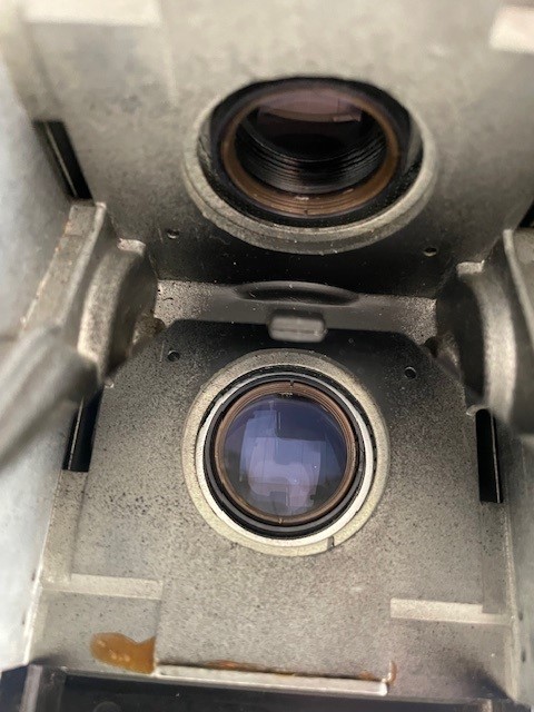

Promised pics...
Laurent
Oct 15, 2004
1,829
France

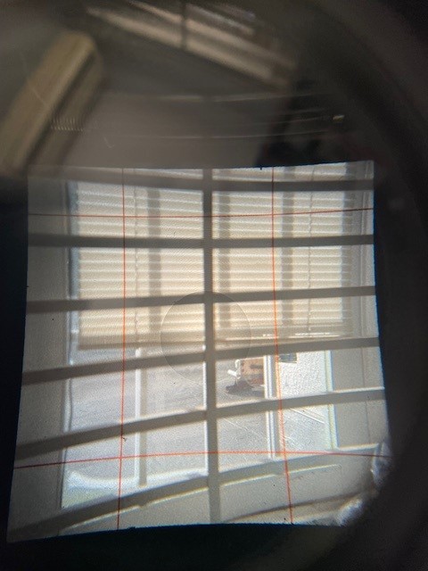

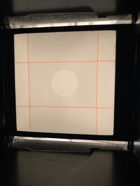

Thanks ! "Nice camera, I forget about the red grid oj the ground glass,,it's a feature I liked on my Mat.
Are you in the process of thorough cleanup? Took me some time to understand the first two pics
Maximus966
Maximus966
May 21, 2024
74
Puerto Rico
Yes, already cleaned and ready for this weekend's tryout.
The first two pics are the inside of the top lens/mirror area. All cleaned up, mirror super nice, lenses were very nice in and out, and viewing screen is impeccable. I really think it is not worth fiddling anymore with it for now, as it seems all is good (other than the erratic self-timer issue). Seems someone had cleaned the camera before and forgot a strand of cotton in there on the mirror bracket.
Third pic is with the mirror in place, thus why you see the upper lens and its mirror image...
