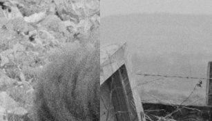

Here you go - 100% crops of 135 on left at 6300ppi, 120 on right at 3200ppi, Hasselblad X5 with the USM turned off correctly. Scanned as 16bit TIFF, post process adjustment for black point only & saved as JPG, whites kept unclipped. That buckshot grain you display above is characteristic of an overly aggressive USM at the scanning stage. For what it's worth, ID-11 1+1, the 135 dev'd to a fairly stiff CI somewhere in the mid 0.6s, the 120 to mid-low 0.5s.
For whatever reason the upload has been somewhat altered by the site software - I can send you the actual file if you're interested.

I don't think you know Dead Link Removed. Suffice to say that short of a well done drum scan, you will really struggle to find a better scanner. The image on the left represents a section of what would be a print 20x30 inches at 300ppi output or 60x90 inches at non-retina screen dimensions. The files are exceptionally sharp with realistic grain when appropriately printed.
Maybe under a condenser enlarger you might see 'crisper' grain, but the proof of the pudding is what it looks like when printed at 20x.
