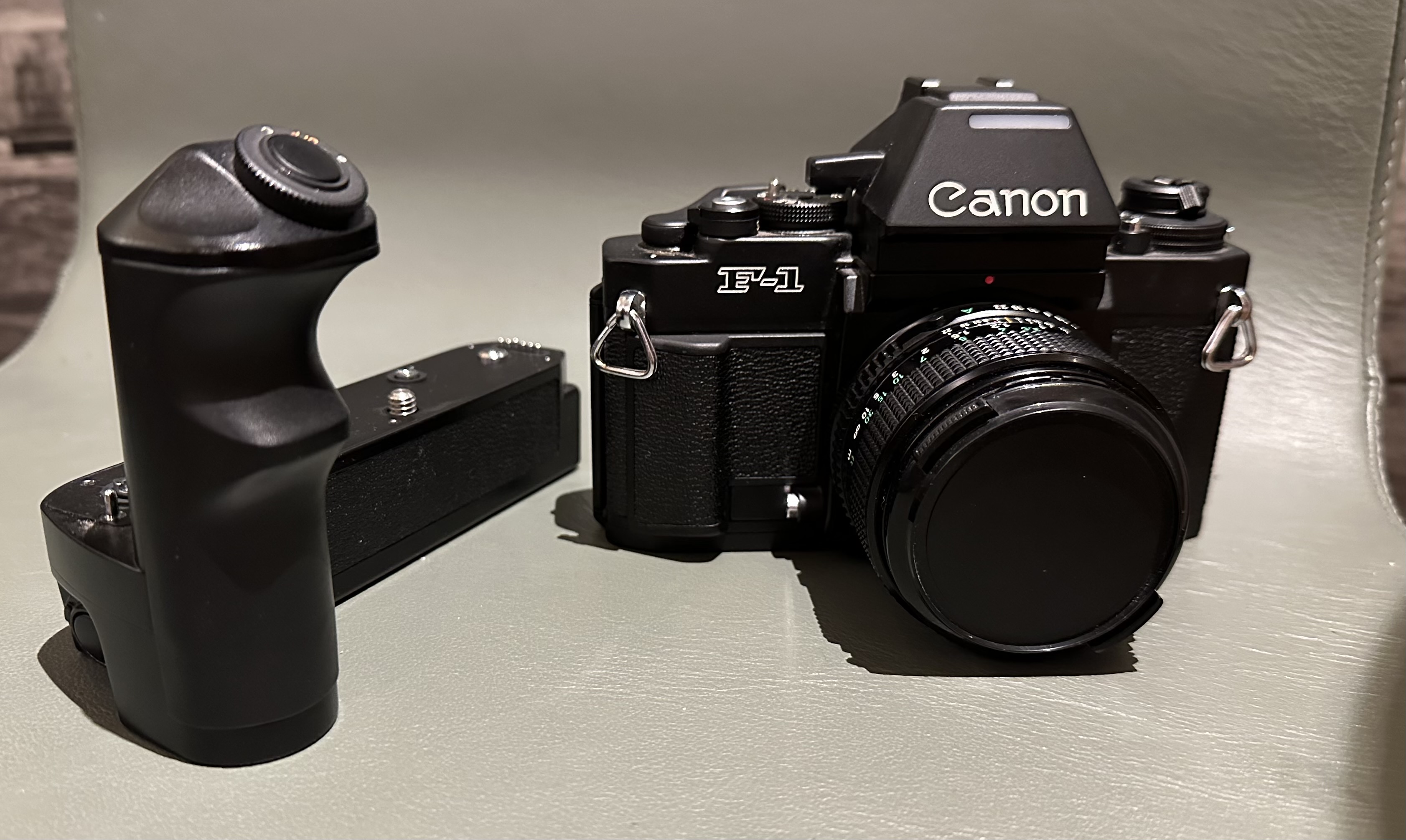

I took a chance on this at an online auction. There was no descripion other than Canon F1 with motor drive, and one photo. I asked the seller if it worked, which he said it did. It got here today and the thing is MINT! And mint is not a word I use lightly. It looks like it just came out of its box and was never used. The date code suggests it was made in 1991. It came with the PK focusing screen.
Unfortunately the mirror comes up too slowly so I’ll spend another $250 on a CLA. I ”only” spent $380 on the camera, so considering the condition I think it’s well worth it.

Oh, I will. A 100 shutter actuations or so and the mirror is moving better. Will do a test roll tonight.
You may find that "exercising" the mirror may bring it back to full functionality. If it only has limited actuations for a camera from 1991, this may be a solution.
Thanks! Yes, it’s now working perfectly. I suspect it might change if it gets cold though.
