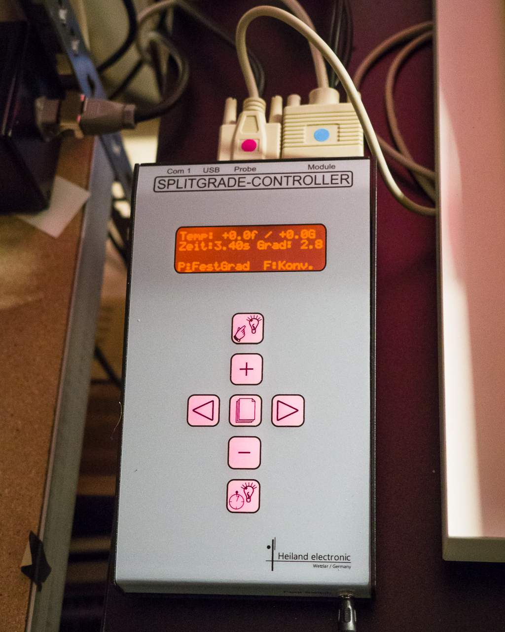

The Heiland module is quite important for me: My dark room is in my brothers basement boiler room. Thats a 20 Minute drive and of course I like to ask ahead about coming over. It is quite a time constraint but my only option. If I had my darkroom in house I could just do a quick print on a workday evening, whenever I felt like it. No problem with my Nova slot processor. It's always ready. But I'm limited to the weekends and holidays. The split grade controller will hopefully save me a lot of valueable time and help me to get more done, and that would make it money well spent.

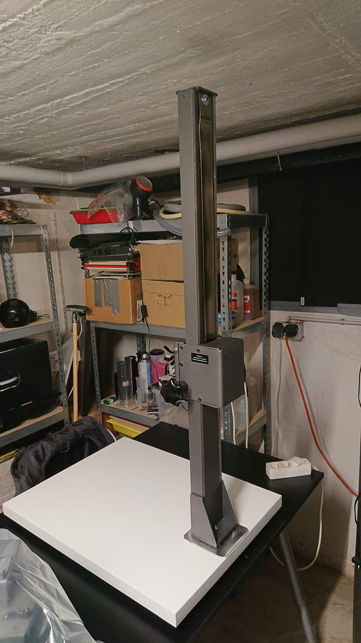

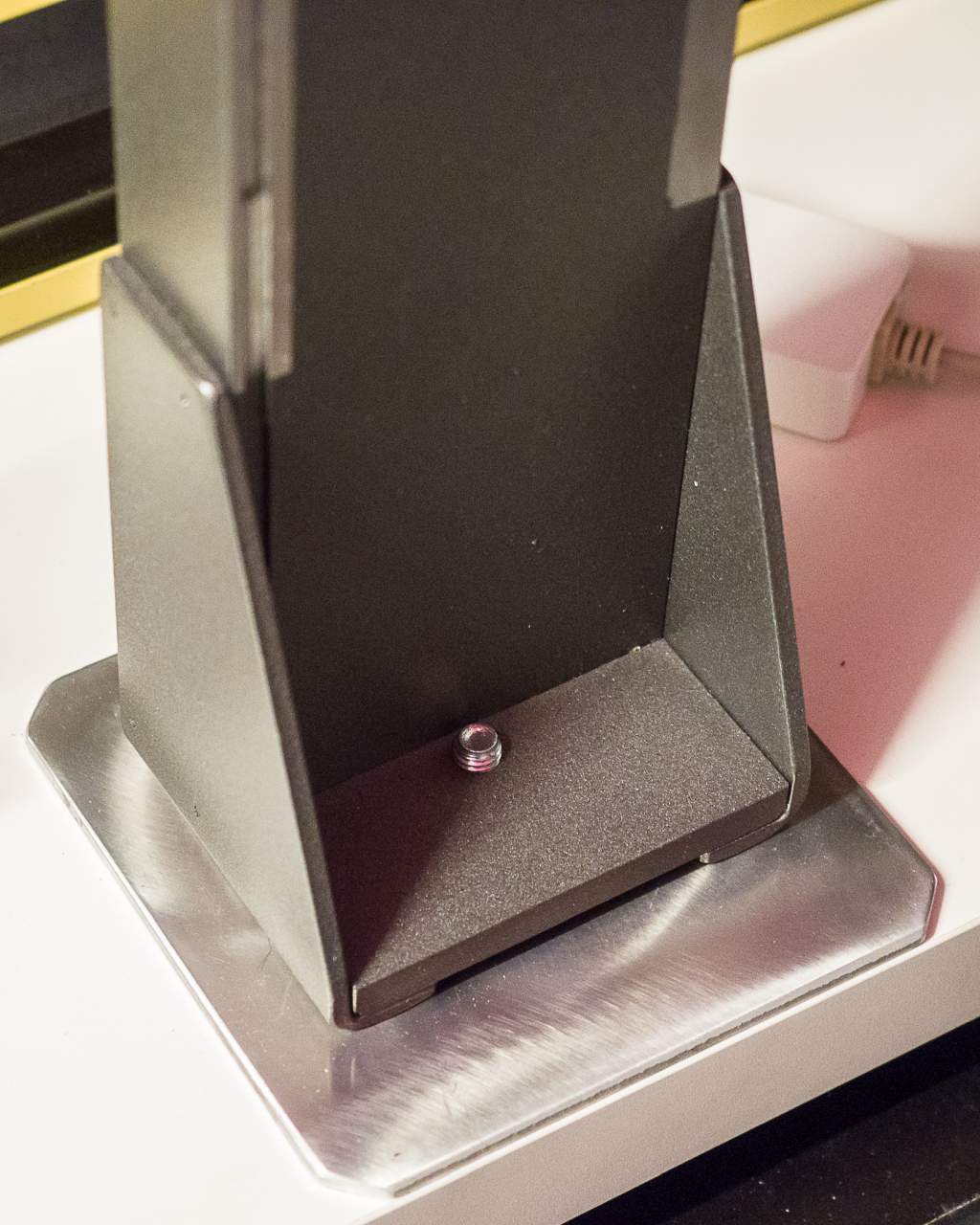

Setup was easy. There were three large pieces and various small accessories. The baseboard, the column with lift traveler and the head.

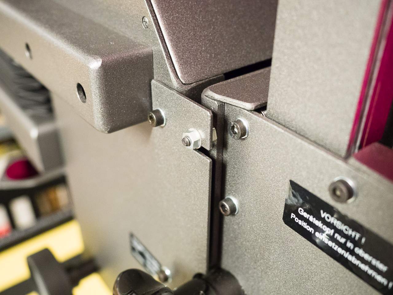

The column is attached to the base board with only one large screw. The screw, using a large washer, goes through the board from the bottom and screws into a threading in the foot of the column. There is no metal counter plate on the bottom of the board, only a metal plate on the top. The column can be placed in any orientation. I guess only straight to the front and, perhaps, straight to the rear (for floor projection) make sense.
The traveler has four small, threaded bolts which go into four small cutouts on the head. Gravity will hold it in place and the assembly is fastened with four nuts. You can switch off gravity, now.
Really simple. Though Mr. Kienzle, as well as a notice sticker, warn that you should have the traveler in the top position when mounting the head. If the autobreak were to release accidently things could go ugly. Mr. Kienzle used a screw clamp as a safety instead of working in the top position.
At my current (adjustable) table height and the concrete ceiling as it is, I cannot extend the enlarger to the top position without smashing a hole into that ceiling.

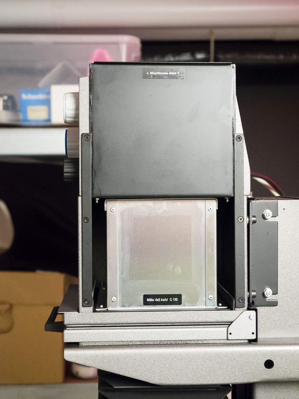

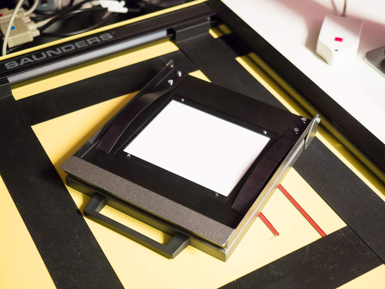

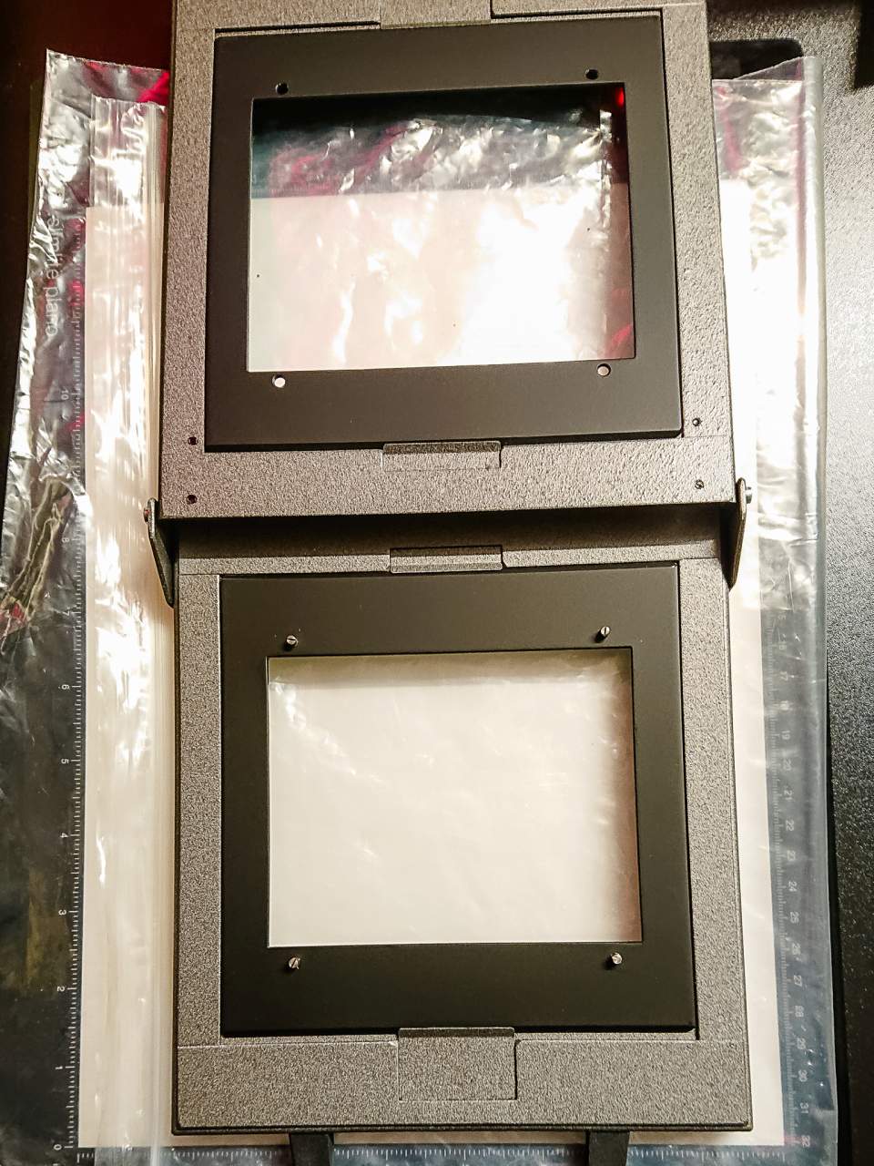

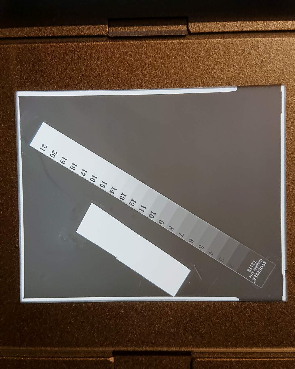

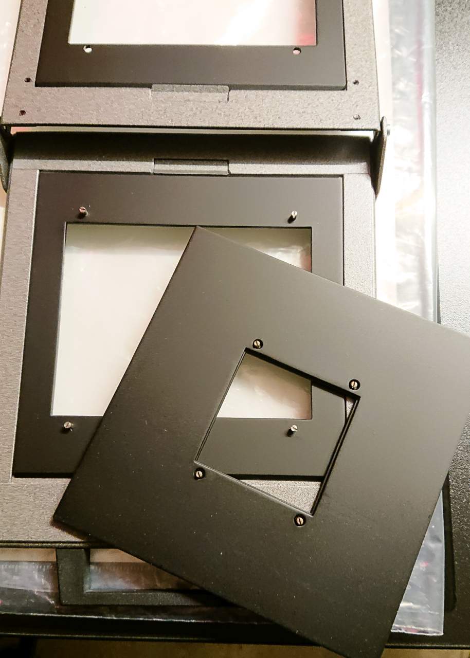

Al the rest is pretty standard. The film holder has a recess in both parts. These take either the universal glass sheets, or glassless metal masks. I chose the basic model without adjustable masking blades.
The cut out in the filmholder itself is exactly the size of a Fomapan 4x5 sheet, which I used to gauge this. With the glass inserts it should be possible to print the film borders of sheet film.

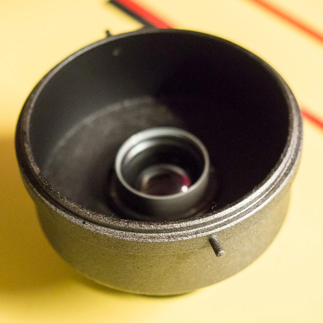

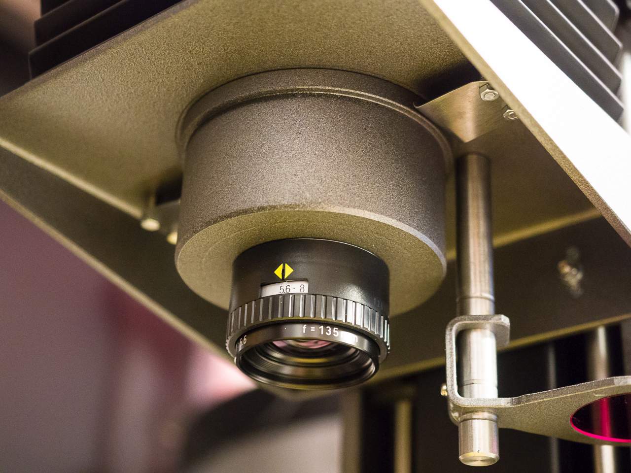

The 135mm and 80mm lenses are screwed into a lens cone for each respective size. The cone is bayonet mounted into the lens board. Very easy, on the fly. The 50mm lens goes into a 'lens board', which is recessed inside a cylindric lens cone. So the lens board is more or less flush with the lens standard of the enlarger. The cylinder around it allows me to grab and bayonet mount the assembly. An actual flat circular board simply couldn't be handled as easily.
On my LPL I had to umount the lensboard by opening the retaining screw, unscrew the lens from the board, flip the board and screw in the other lens. Then mount this assembly. That was easy enough. But now I have all three lenses mounted on their respective cone and simply grab and change with the convenient bayonet mount. The bayonet is similar to incandescent light bulbs with bayonet mount, common in the UK.

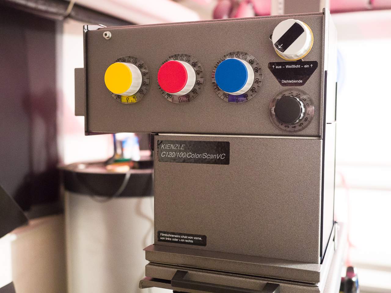

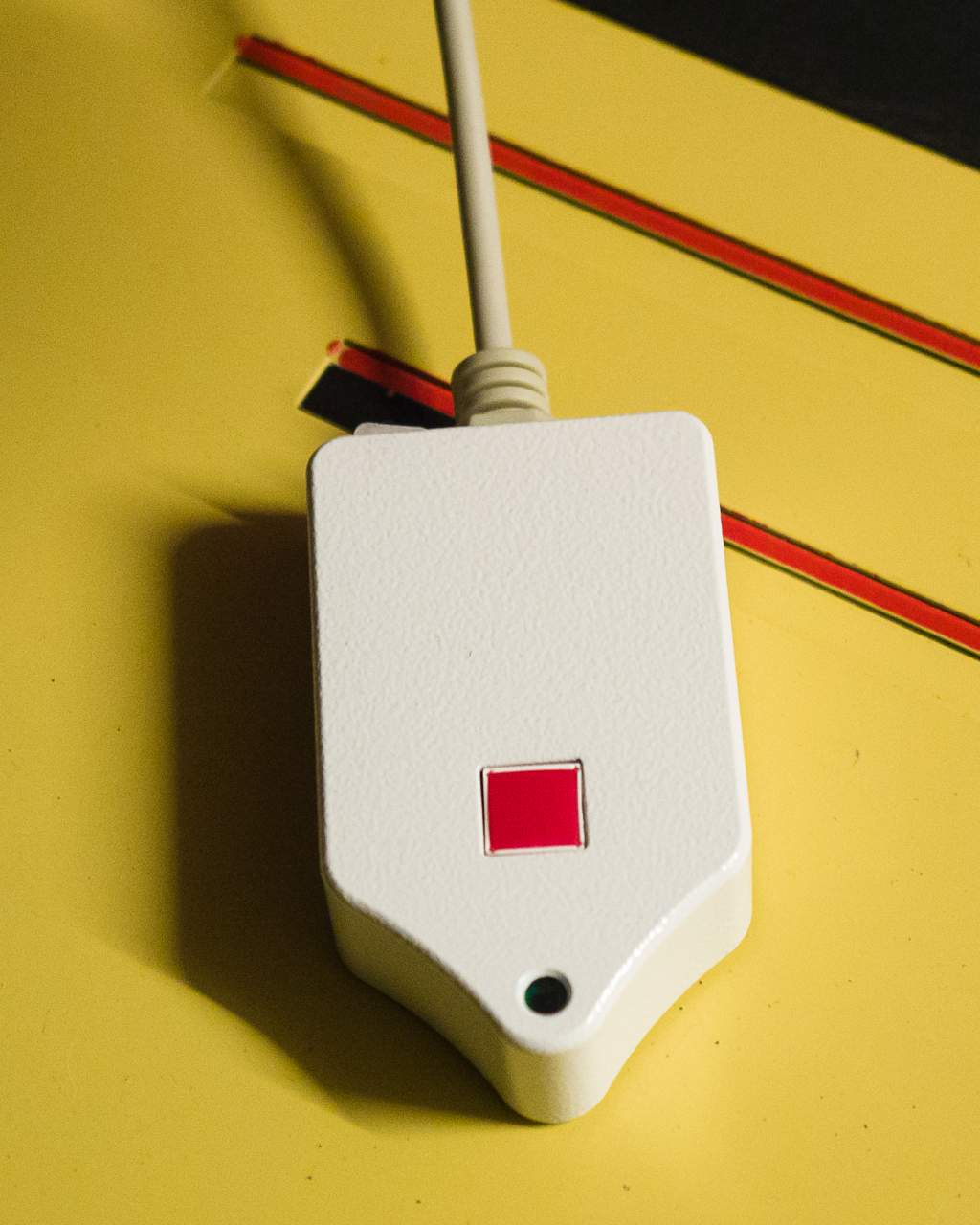

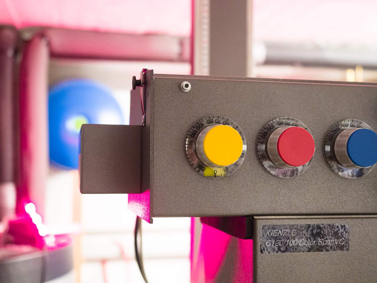

I ordered the C120 model with filters for colour printing and also a motorised split grade module, which is controlled by the Heiland splitgrade controller. There are two cables coming from the head. These are neatly zip-tied together for part of the length. One is the power cable for the 12V 100W halogen light. The other comes from the box with the stepper motor and connects to the Heiland controller via Sub-D 15 pin connector. The powersupply (old fashioned transformator) and my safe light plug into the relay switched 230V sockets coming from the controler.
Thats pretty much it.

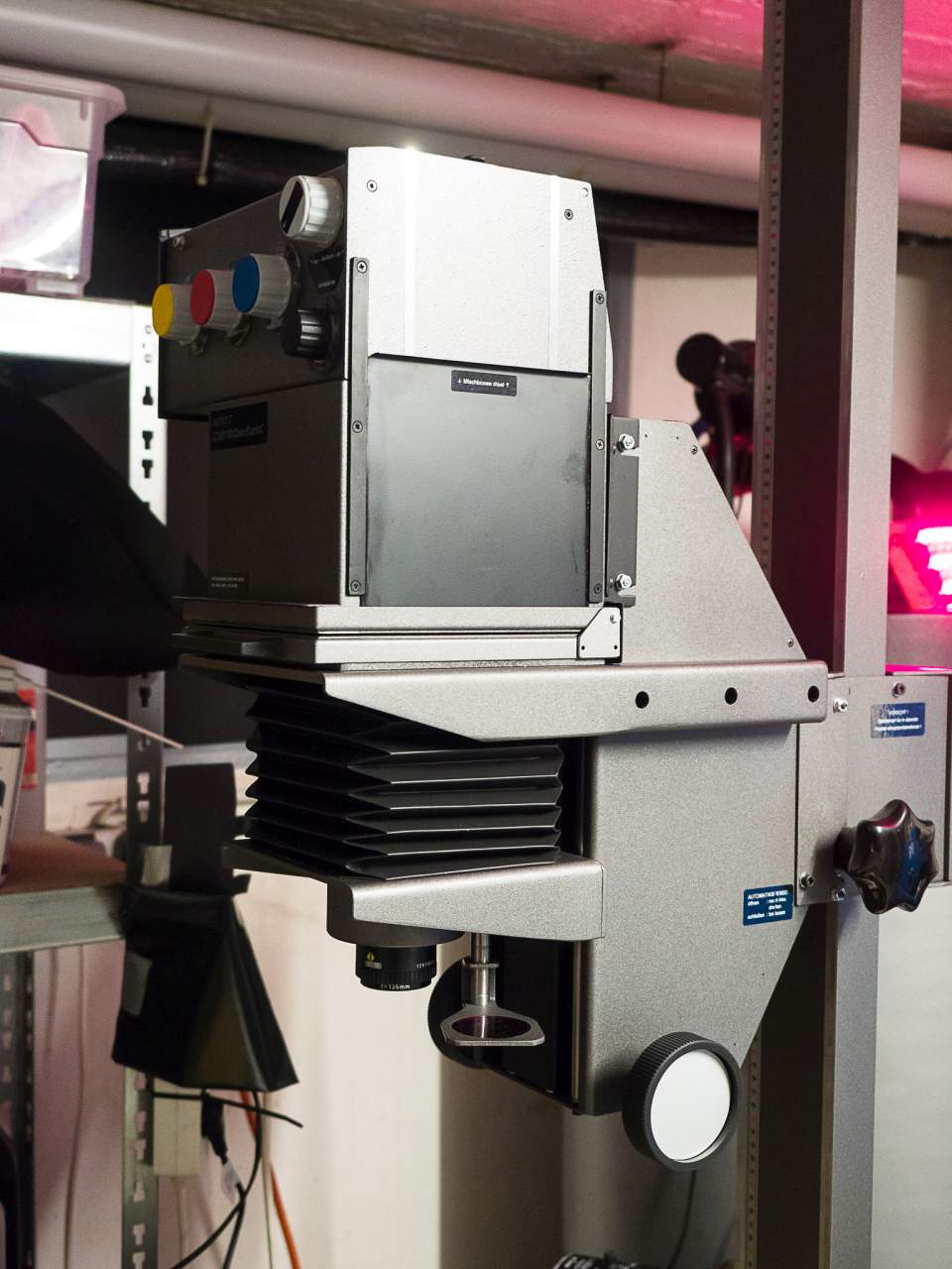

Act 4 - A look at the assembled enlarger
I was quite happy with my LPL, which is a fine enlarger, IMO. But I bought this one new and configured for my needs. So it is really MINE! :smile:
I like the finish of this device. The paint is textured. Most components look like they were made from sheet metal bent to various shapes and welded or screwed together. Mostly pretty thick sheet metal, around 3mm I'd guess. The head should weigh around 13kg. Total weight around 35kg. I didn't weigh it myself.

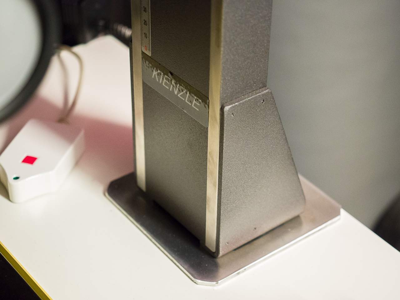

The column is a simple, long box shape. Probably welded from four thick steel sheets. It is relatively slim, this is the compact economy series, after all. But very sturdy. I just don't see how it would flex. Of course the whole enlarger will move when you touch it. I think this the flex of the attachement to the base board. It is quite a bit thicker than my LPL base board, has a smooth white finish and is as wide as my Saunders VT1400 easel.

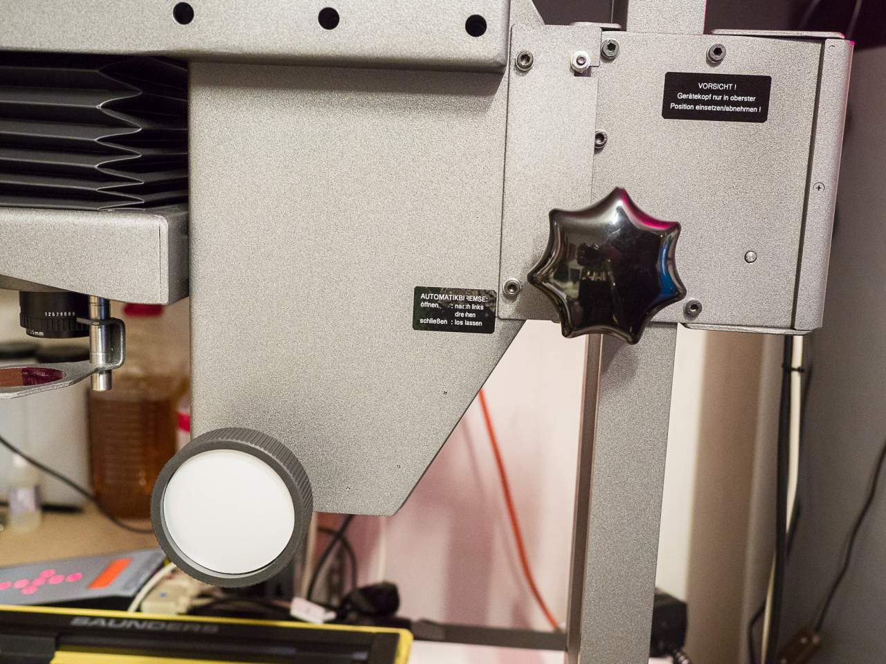

To move the head up or down you turn the spring loaded autobreak knob a small amount anticlockwise and hold it. Movement is very smooth. Gently release the knob and the break is set. I did not remember the head moving as I set the brake. But I keep forgetting to deliberately check for this when in the dark room. Unlike the screw-in type brake of my LPL. The head would rise a little, and I noticed everytime.
The focus wheels are quite large and, like the autobrake, can be grabbed with my fingertips or my whole hand. Focusing is precise enough for me. I didn't order the fine focus option and happy with that decision. I managed to handle the much smaller knob of the LPL. Sometimes I gave it a slightly powerful but well measured 'nudge' with my fingertips to get the final tiny correction for perfect focus. No such martial arts required here.

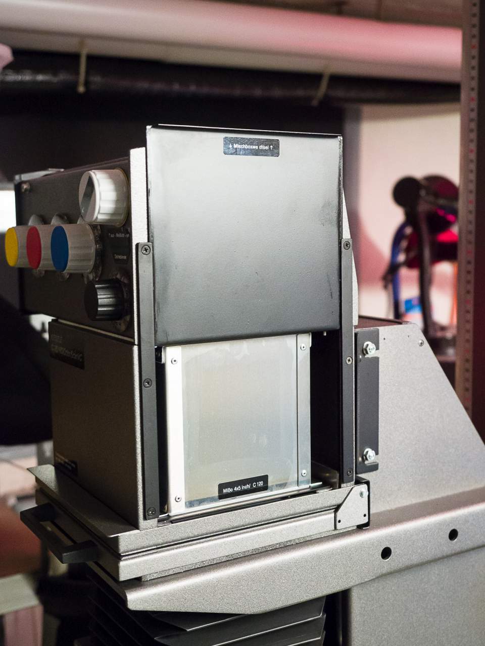

The film holder can be inserted from three sides. But when doing so from the side the open back of it will allow light to escape. I taped some black photo cardstock over it and that contained it. A small price to pay for the flexibility.

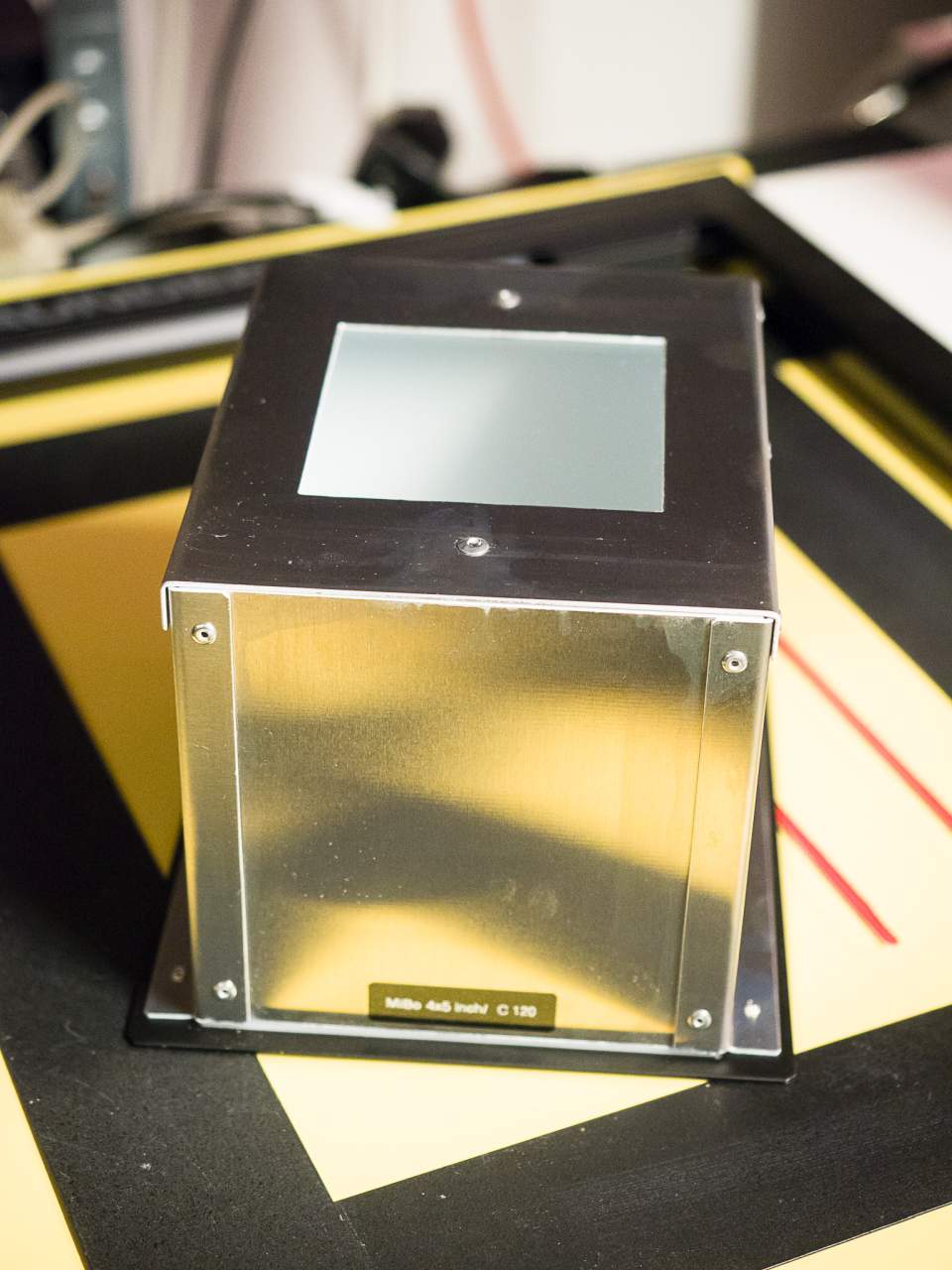

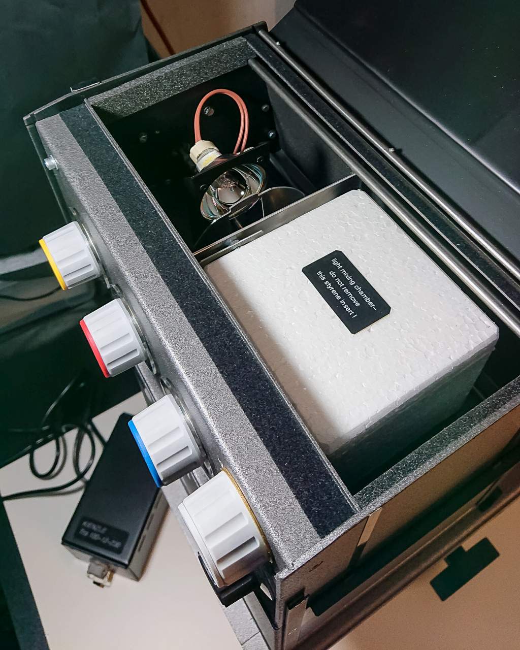

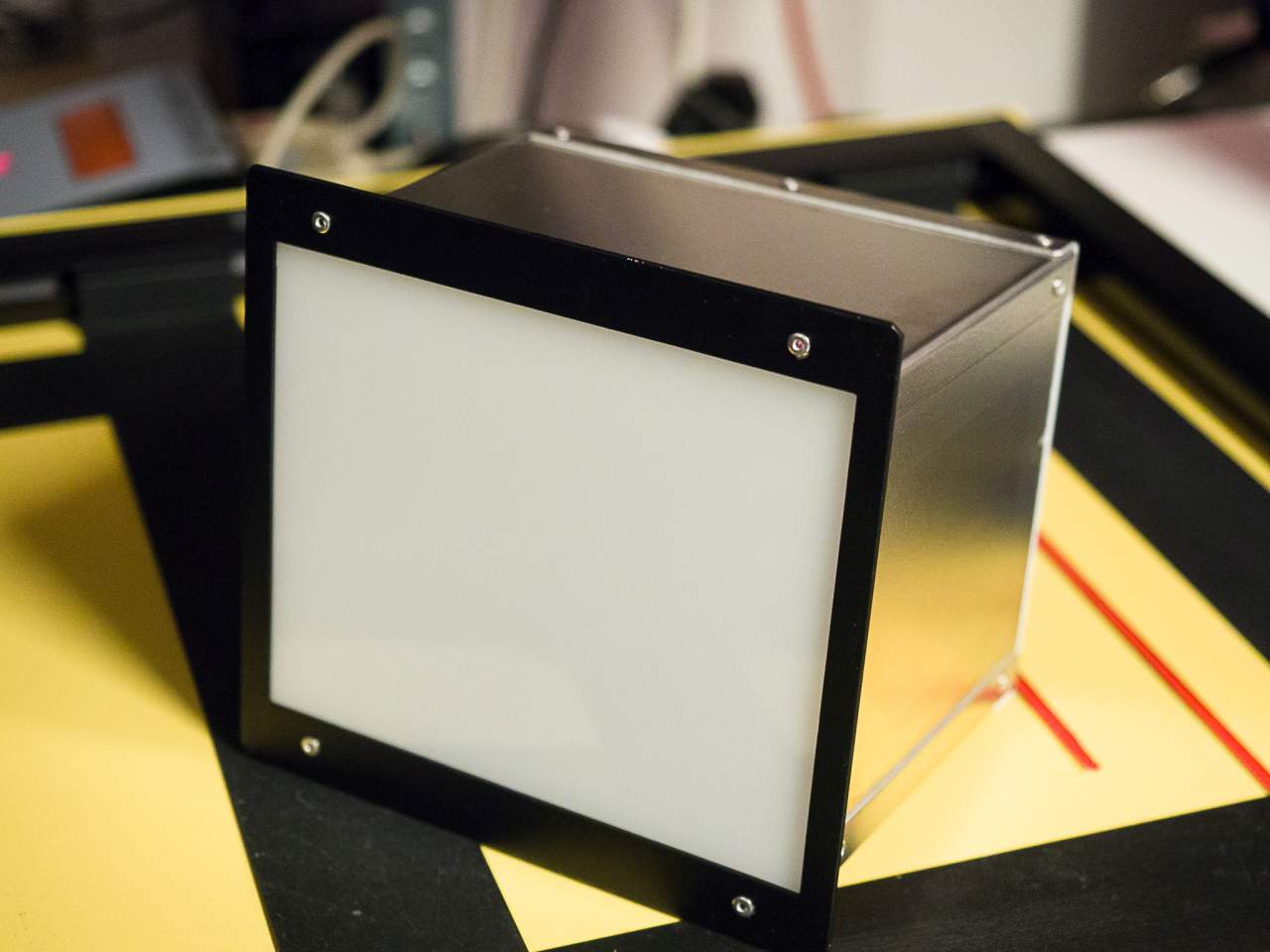

Another nice feature is the light mixing box. There is a sliding door on the side. It stops in the closed and the open position. No need to lock/unlock. Just slide it open and slide out the mixing box. The film holder has to be removed as well, though, for the box to come out.

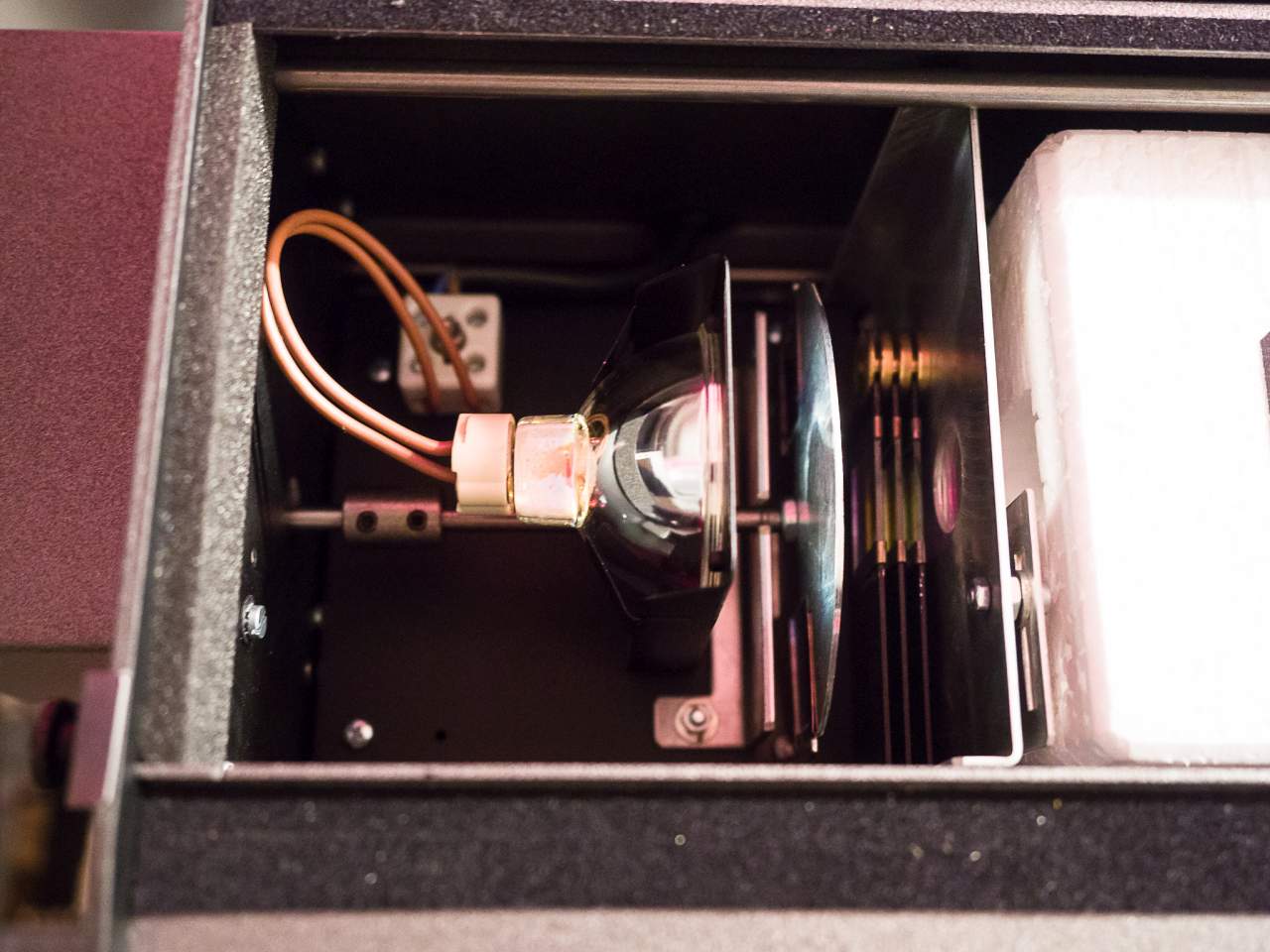

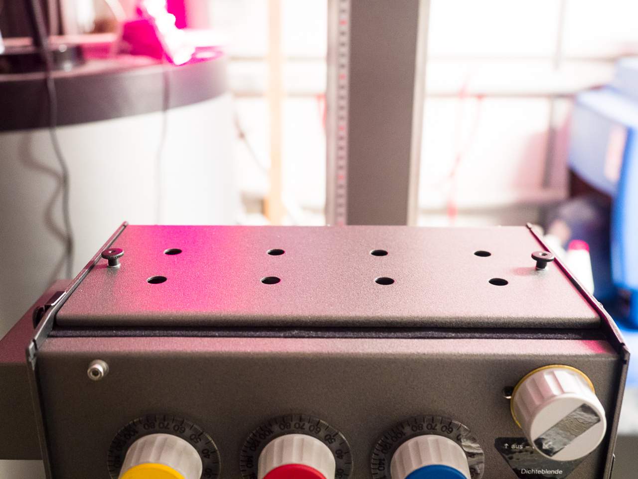

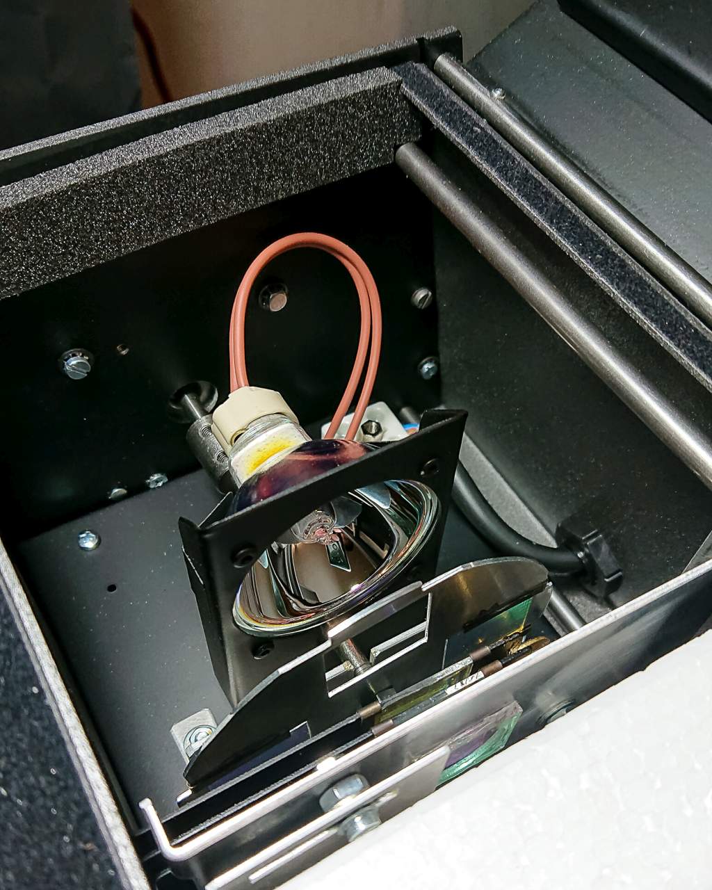

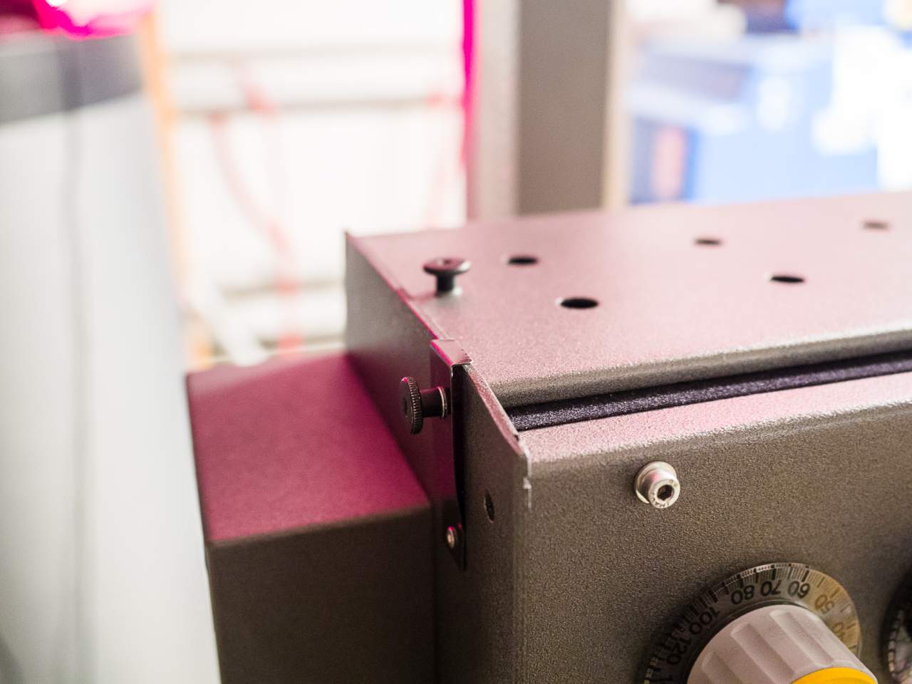

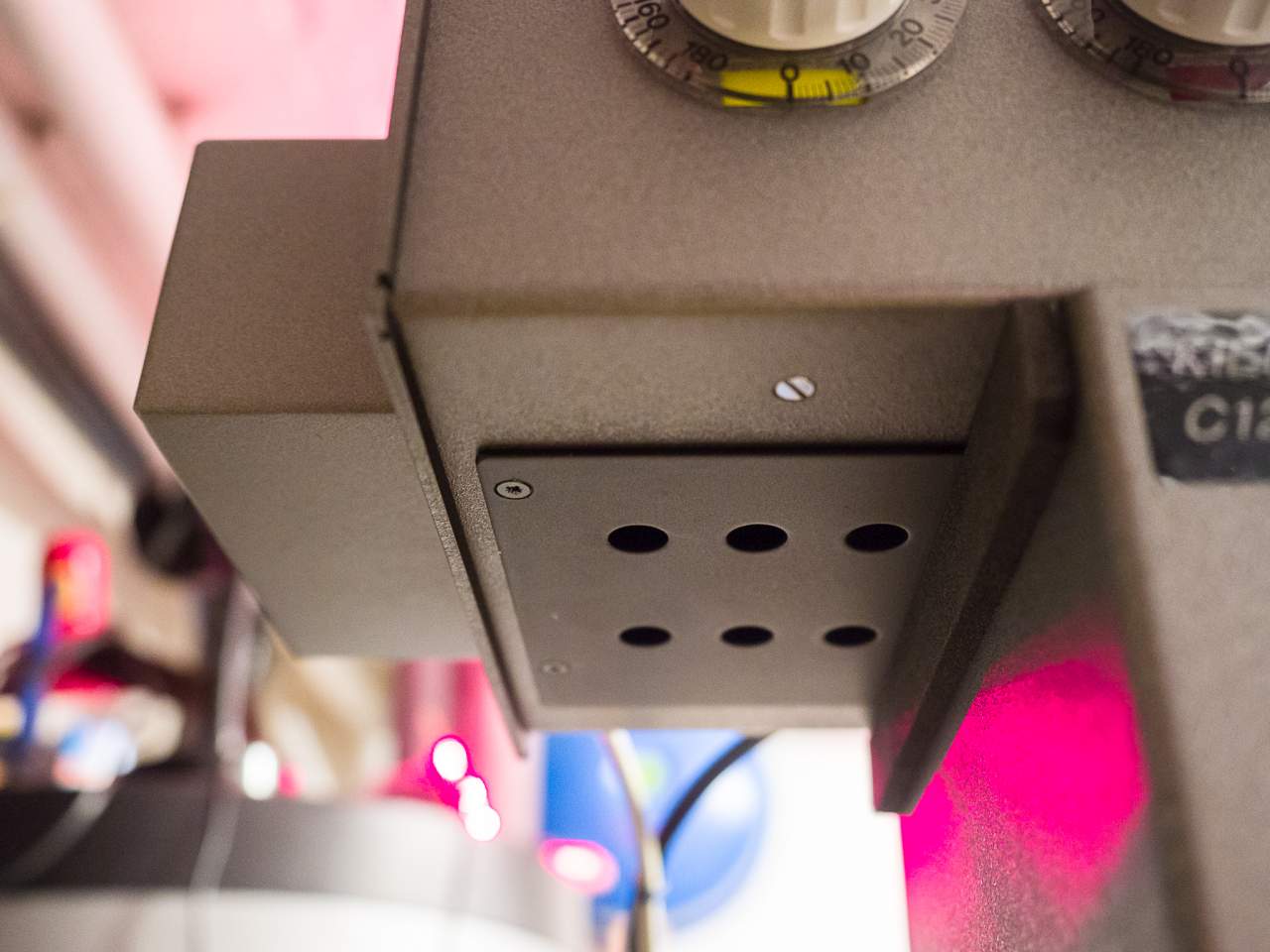

Speaking of it. The very top of the head is the lamp house. It is wider than the part underneath and protrudes to the left. And then there is the box with the splitgrade stepper motor permanently attached on the left of the lamp house.
The lamp is mounted horizontally on the left. The light path goes through the motor driven wheel, holding the split grade filters (Y/M), and then through the colour filters (Y/M/C) and a metal aperture with IR-filter glass into a styrofoam mixing chamber. From the bottom of that chamber the mixed/diffused light will enter the top of the removable mixing box, which defines the usable negative size. The styrofoam box is not removable, only the the metal mixing box below. I ordered the optional stepless ND dial. I don't know how it works, my best guess is a slider between styrofoam box and the metal box.
The top of the lamp house is a lid that swings open. It can be locked, but I don't. The lid has holes for ventilation. Also the bottom of the protruding part, which is where the lamp is, has these ventilation holes. There is a light trap in place for these. When the lamp is on I can see subdued light inside. But nothing I'm worried about. Maybe I'll do a test when colour printing.
I find it interesting that the option of condensor mixing boxes is available for the most common formats. A condensor fed by the diffuse light of the first stage styrofoam box. I wonder what you think about that! Will it behave the same as any other condensor enlarger?

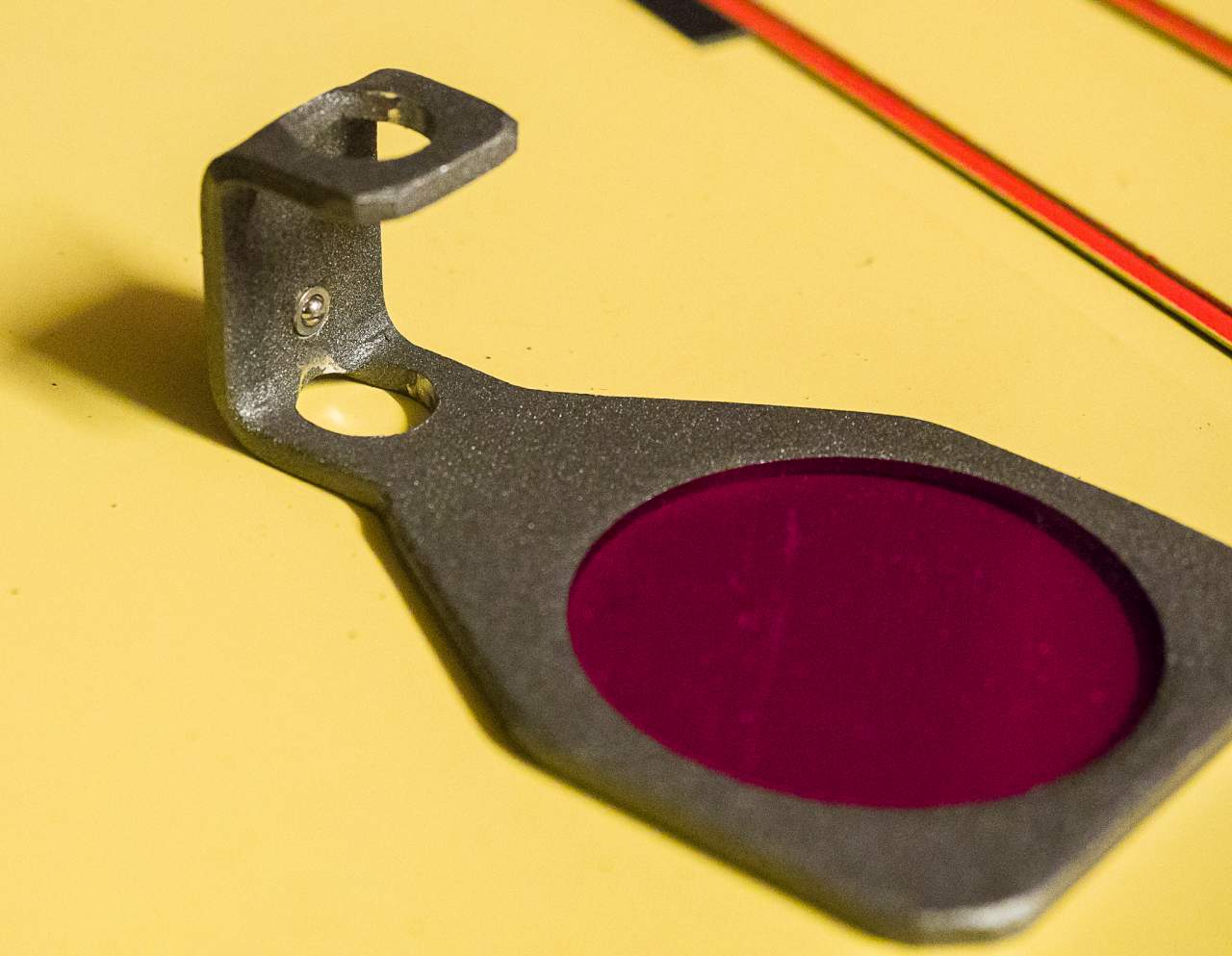

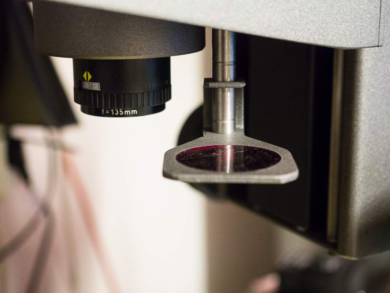

I like the holder for the red filter. It has that simple-elegant look and is pushed onto a stainless steel rod that protrudes down from the lens standard. The rod has a few notches into which the holder will click. But only two or so fit my lens/cone combos. But that's no problem. The holder be freely moved and there are no locking screws. Just slide and rotate it to anywhere you like and it will stay there.

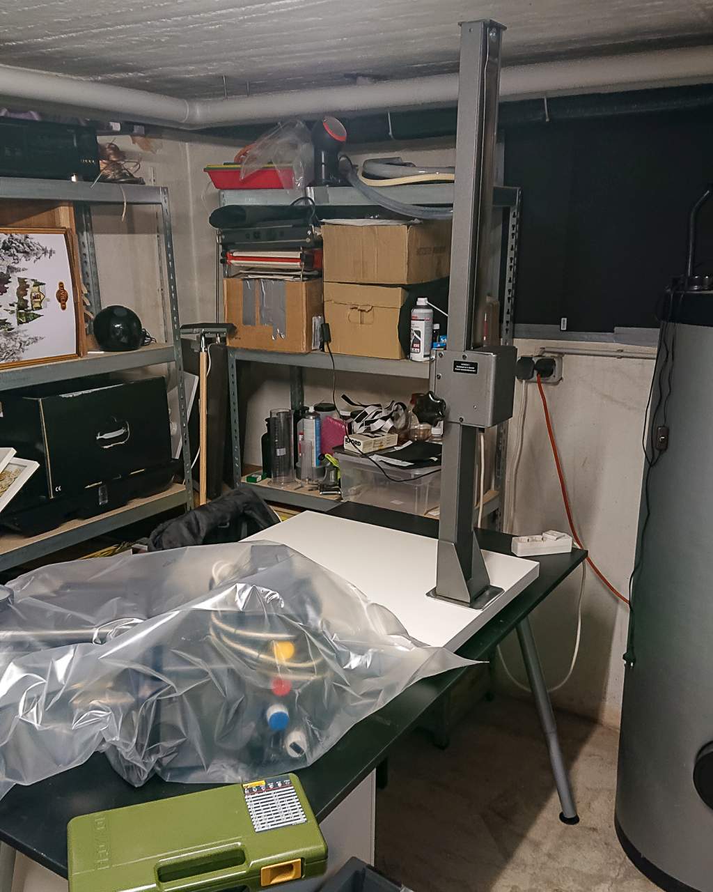

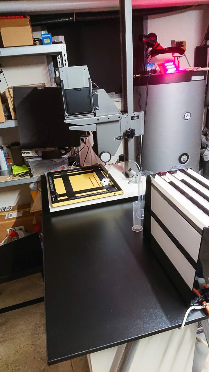

Also to shock you I'll add in two pictures of my darkroom inside a boiler room. The room stays cool all year, even cooler in winter, but gets a bit warmer over time when I close the door. I do sweat a little in the summer. But the heated Nova allows me to have a constant developer temperature all year. In winter the solutions on the shelf, next to the outside wall, get as cold as 12°C. Great for my papers, too.
I have the shelf at the far end and the table to myself. While operating I can spread out a little, but put it all back when I finish. No running water. I carry water into the room. A bucket with an immersion pump is the reservoir feeding the wash slot of my Nova. It drains into another bucket. The 10L bucket is full after 2-3 RC prints.
When I do FB paper it is rinsed/washed for two minutes in the Nova and then no more than 15 minutes in a Patterson washer in the laundry room. I use replenished, neutral fixer and no wash aid. But we have very hard water. No sink in the laundry room, btw. Only a tap and a floor drain. The house was build in the 60s. That is why the ceiling is a little lower than in more modern buildings. One of the few things that can't be upgraded.

Is that a halogen bulb? One would think a modern enlarger would have an LED light source. Especially the EU/Germany. Here in California, you can't even get some tungsten bulbs. I had to have some shipped to someone in another state and then sent to me!
lantau
lantau
Jan 15, 2016
826
Germany
They also offer the split grade with LED light. It's an expensive option and doesn't support colour, for now. I did mention LED sources to Mr. Kienzle and it seems this is where things are going. I also mentioned discussions on here, when at least one member had the opinion that LED aren't a good match with RA4 paper.
I can't judge that myself, but for a combined colour/split grade head the tungsten source was the way to go. I never knew that these reflectors have a dichroic coating, which will let through IR light. The light beam is considered 'cold' light.
We also have restrictions on tungsten lights in the EU. But these are mostly for lighting purposes, which means long running times.
Devices, which rely on the characteristics of the source are not usually restricted. As long as demand is high enough they'll make these. They have a 100h life time.
Congrats on the new enlarger! Looks nice. I especially like the 4x5 holder showing the whole neg. The LPL 4x5 glass carrier crops and it drives me nuts!
Keep in mind that the glass inserts will keep the film a few mm away from the cut out. This may or may not affect the rendering of the rebate. Foma sheets don't have any markings. I haven't used any of my Ilford and Adox, yet. Colour negative sheets will have it, I'm sure.
Classic opalized incandescent lamps for enlargers are due to regulations special-lamps and thus not banned in the EU, still to be obtained from the shelves of a manufacturer.
Not mentioned at their website, only halogen lamps. But we already had a remark in this thread on the lack of information at their site.

Thanks for those links Lachlan. I note Kienzle are using easily available non-exotic lamps for the C120, which is a good idea.
I agree - I think the bulb system ran 12v/ 100w, 24v/ 250w, 36v/ 340w. Though it looks like most of the 250w+ options are now using multiples of ELC bulbs (which have very long life compared to many other similar halogens) - thus 250/500/750/1000/1500w options.
True, their website doesn't seem to contain that info, yet. But it is in their price list. Also they split information between the enlarger pages and another page about their enlarger heads, which can be fitted to third party enlargers.
I'm not sure from looking at the Kienzle website what the available diffusion options are, they mention a 250W(VA) option but not the 100W?
If you find the dedicated page about their Primos heads you'll see the available wattage depending on the largest usable negative size.

When I talked about this not looking like a factory line but hand assembly I guess I ímplied as much. My LPLs outside is made from pretty thin metal sheet. There is maybe a chassis underneath. But these 'panels' have surely been pressed into shape by specific tooling, which gives it ridgidity. Also the LPL column has a more complex profile for ridgidity than the simple rectangular profile of the C120 column.
My enlarger looks like it has been build with more generic techniques. Classic locksmith(?) work. Cut, bend, some edges possibly welded together, and the whole thing made from such pieces. I expect any skilled metal workshop could work on these enlargers in 50 years, even at a remote place. Although I don't see much that could break. Perhaps corrode if you throw it into the harbour. The mechanism for rising the dichroic filters into the light path will be the most delicate part.
My table is set pretty high and the ceiling is quite low. The column still fits. But I can't raise the head all the way. 24cm x 30cm paper is my usual format. I also like 18cm x 24cm. I have an unopened pack of 30cm x 40cm Adox MCP. I consider this my size limit. It is also the limit of my Nova. Honestly, that is already a pretty useless size and it should work with the 100W model. Exposure times, so far, haven't been excessive. Even for 35mm film and this 4x5 box. That being said I was gifted a roll of 65cm * 3500cm Multigrade IV RC paper and a few very large trays. I wonder what I'm going to do with it.
The 12V 100W lamp is the same my LPL is using. I can keep the spares.
Having had an LPL 7700 apart to deal with replacing the lamp socket & getting the front panel lamps back into action (not a quick job - you have to essentially totally disassemble the head), the head interior is a welded sheet metal frame with die castings screwed to it - and an extrusion for the column. Much like most of the 4x5 or smaller Dursts too. I should have been clearer that the comparison was to something like De Vere, who use quite complex castings with multiple machining/ grinding steps to make them ready for assembly - and which cost considerably more.
It's actually a very good way of making very strong & precise metal constructions in low production quantities - you can essentially replace the need for a tooling/ casting operation with a CNC plasma cutter, a bending brake and spot/ seam welding. Interestingly, many of the later big (13x18cm+ ) Dursts seem to have opted for quite similar use of folded, welded sheet metal. Obviously, above a certain production level, castings make more economic sense - but skilled sheet metal fabrication can be just as good for the needed purposes if done well.
