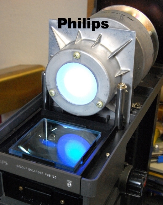

Yes - and it tends to get forgotten that the whole reason Durst used those monster bulbs in the 138/ 184 condenser heads etc was because they were the best way of getting a reasonably high output diffuse source of sufficient size to illuminate the condensers evenly in the 40s/50s. I do like the idea of being able to switch at will between a diffusion and condenser source, simply by changing mixing boxes.

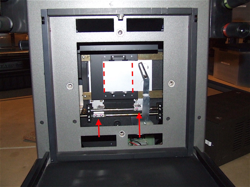

Today I had a look how the ND mechanism is working. It isn't sitting between the styrofoam mixing chamber and the metal mixing box.
It is visible in the images of the open lamp house. Between all the filters and and the styrofoambox is the 'firewall', which seperates the box from the hot space. This 'firewall' has an aperature with an IR filter. Between it and the box you can see a small piece of metal. That is the slider that is being moved by the ND dial. It slides behind the aperture of the 'firewall' reducing the amount of light going into the square opening of the styrofoam box.
The ND slider is moving horizontally, while the CC filters are moving vertically. Just in case anyone is wondering how these can work together.

The Durst system is similar. The two blinds for the "ND" function slide back and forth on those rails. In the picture, the blinds are not actually seen, because they are behind the closed exposure shutter.

My Durst 10X10 colorhead uses ordinary ELH tungsten halogen bulbs. And the ELC bulb mentioned on this thread was also long used for Omega 4X5 colorheads. Easy to get, even in California. The tungsten ban applies to the entire US, but affects only common RESIDENTIAL lighting, none of the specialty bulbs, and is intended to reduce overall energy consumption. It's ironic, because halogen replacements are a much bigger fire risk in ordinary floor lamps etc, and CFL's are a health hazard to eyesight. But even regular screw-in bulbs are legal if they're classified under a special niche like heavy-duty, with thicker filaments and glass, so-called "drop light" bulbs. I have a "wait and see attitude" about LED replacements; they're gradually getting better for display lighting purposes, yet only at considerable expense; but that might change too. For enlarger colorheads, I'd rather stick with a known factor.
