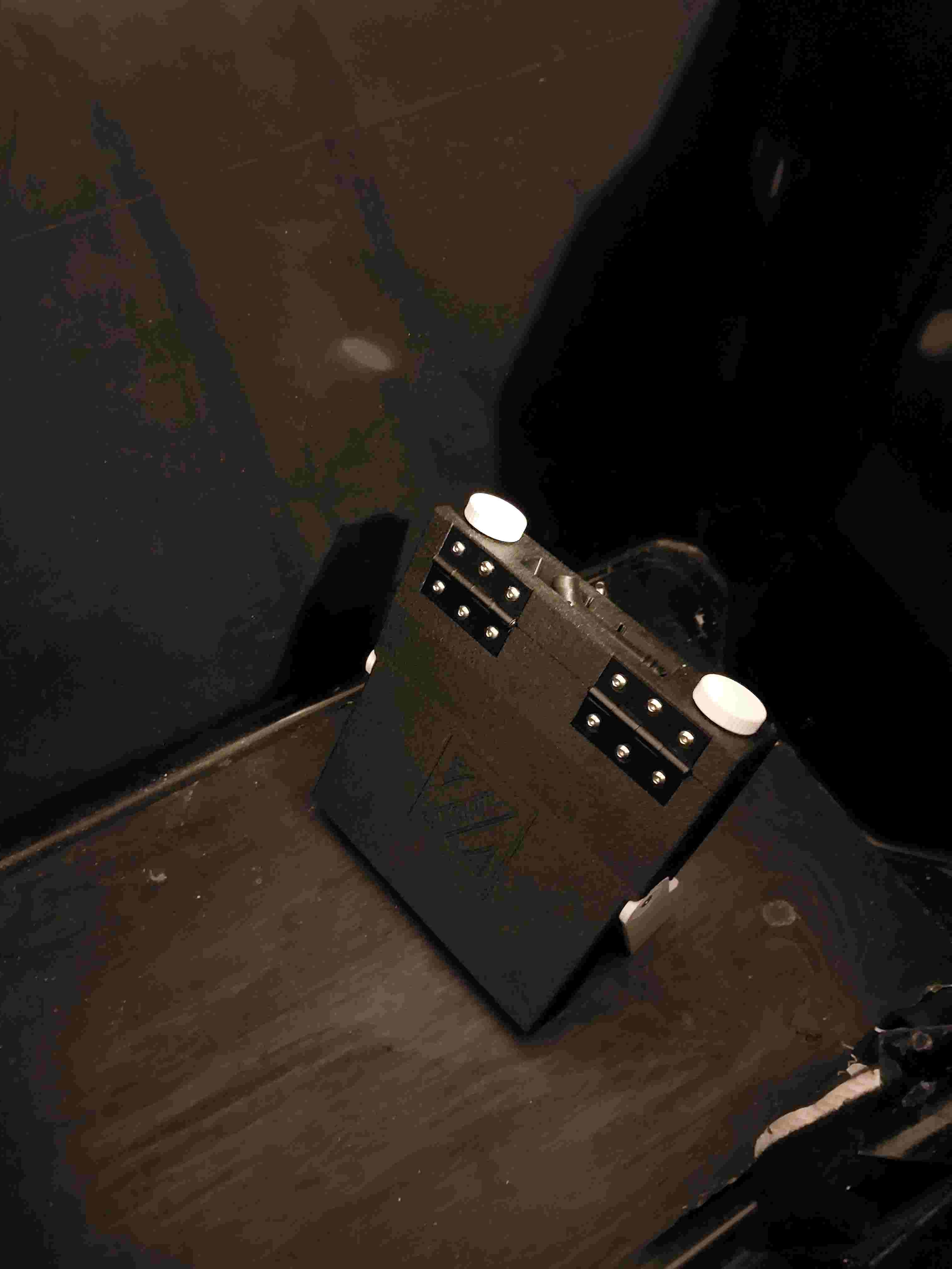

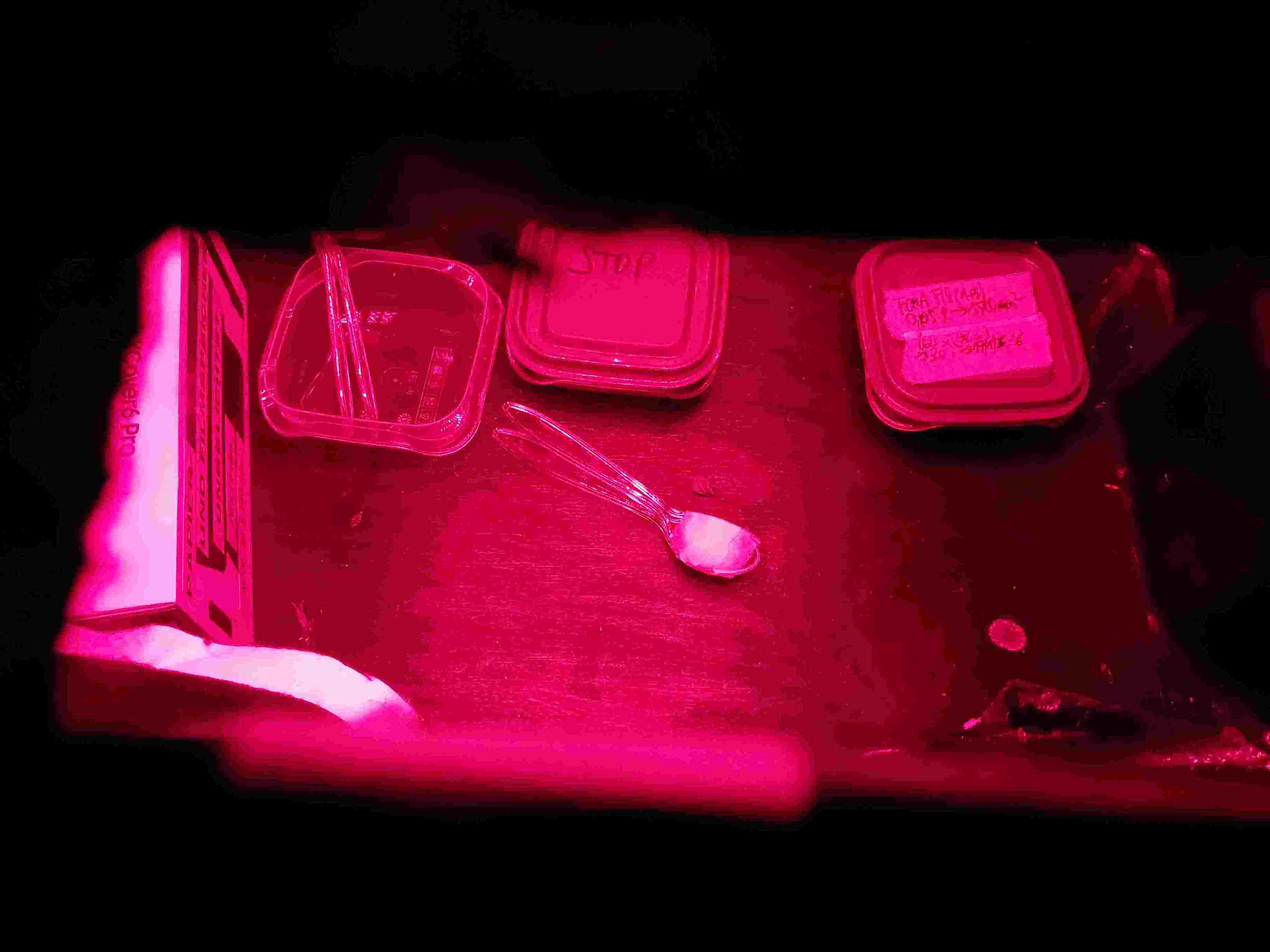

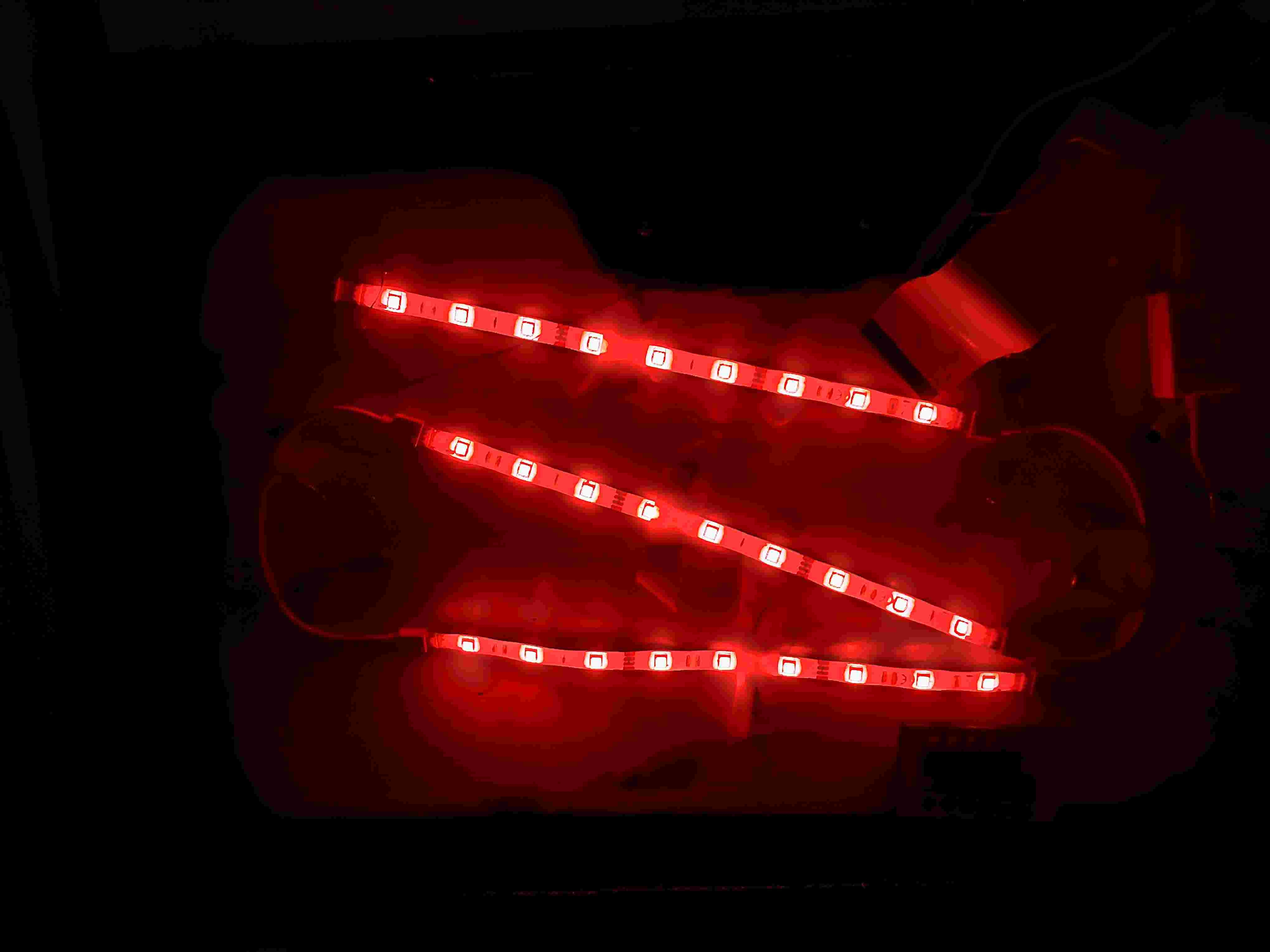

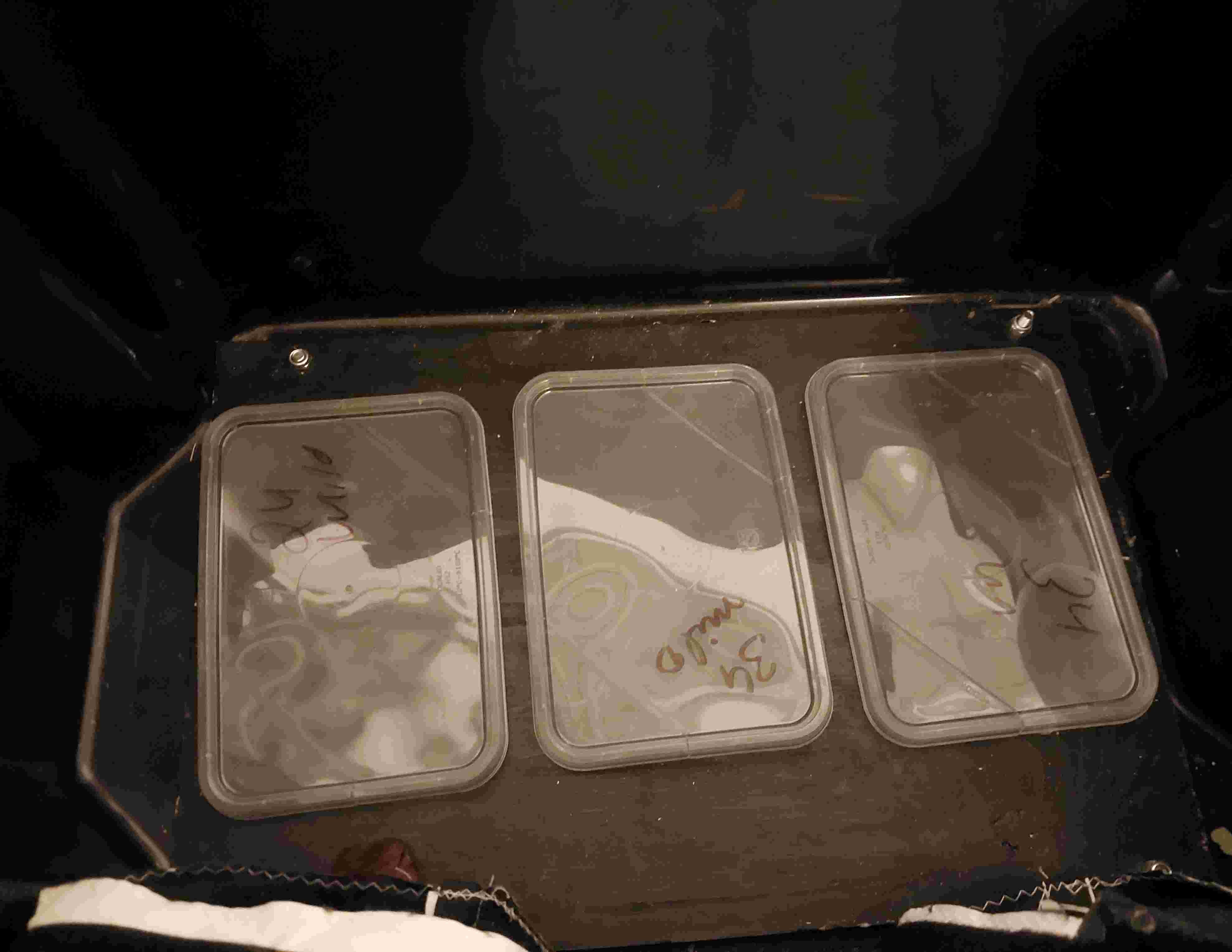

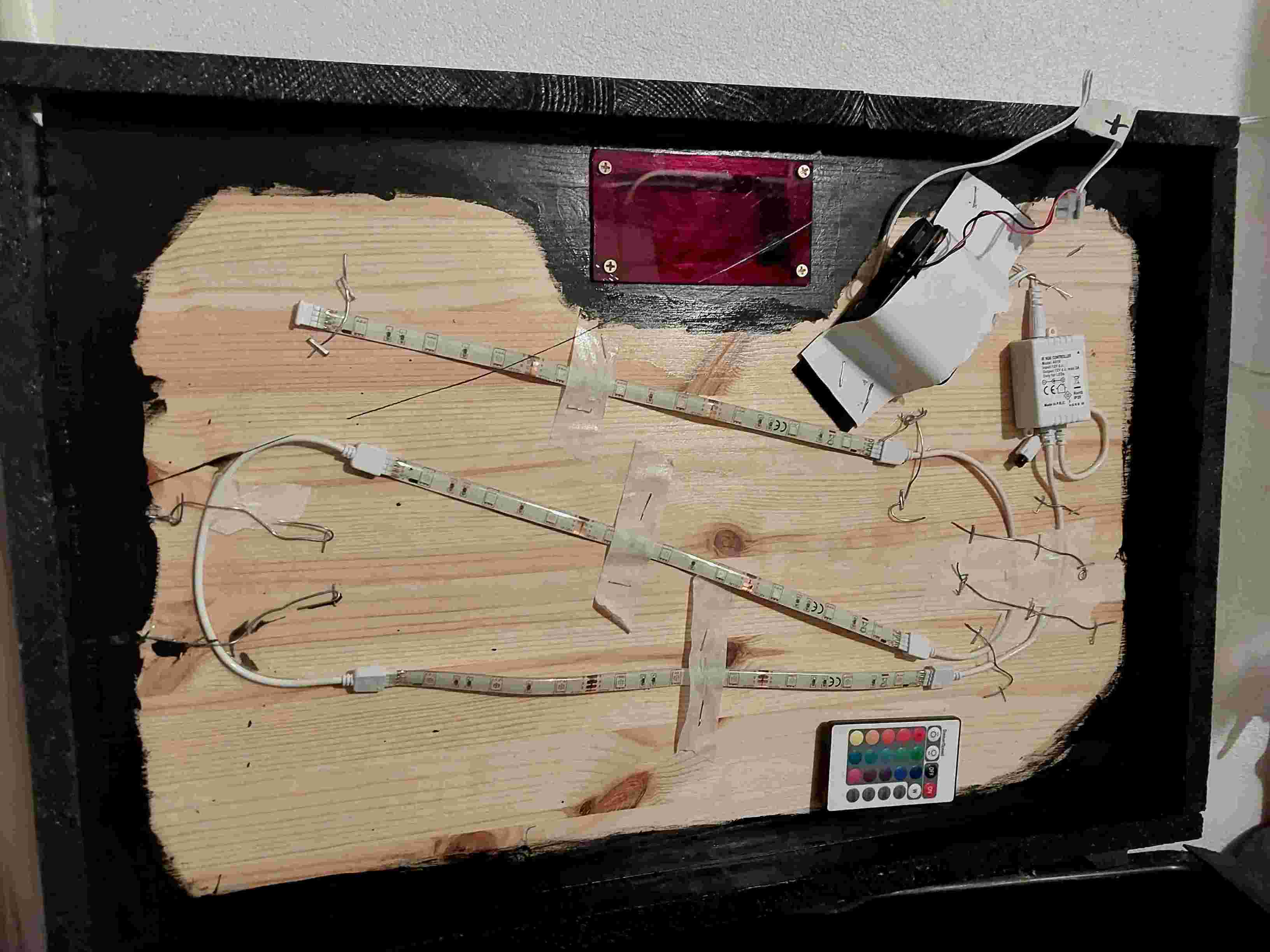

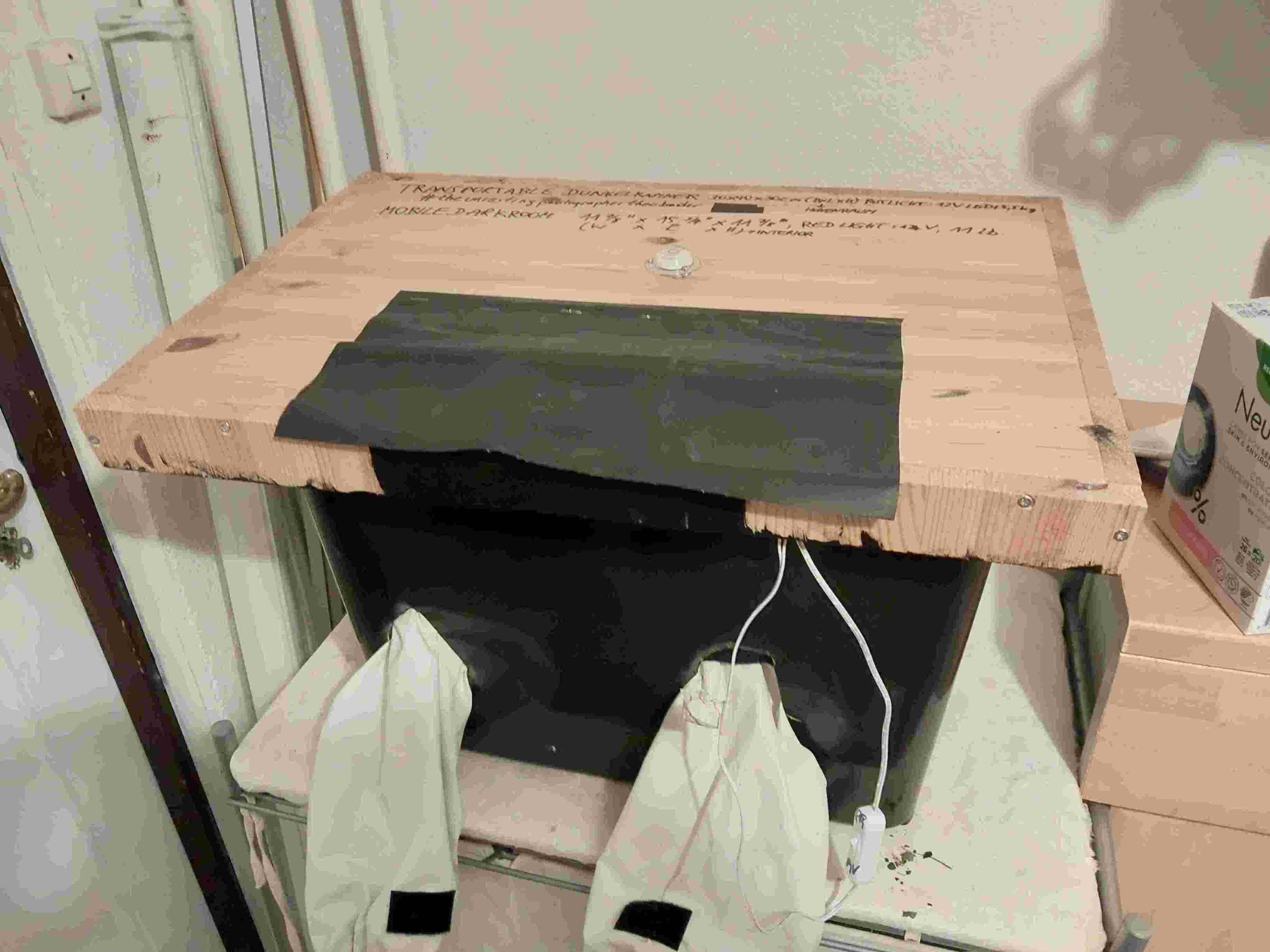

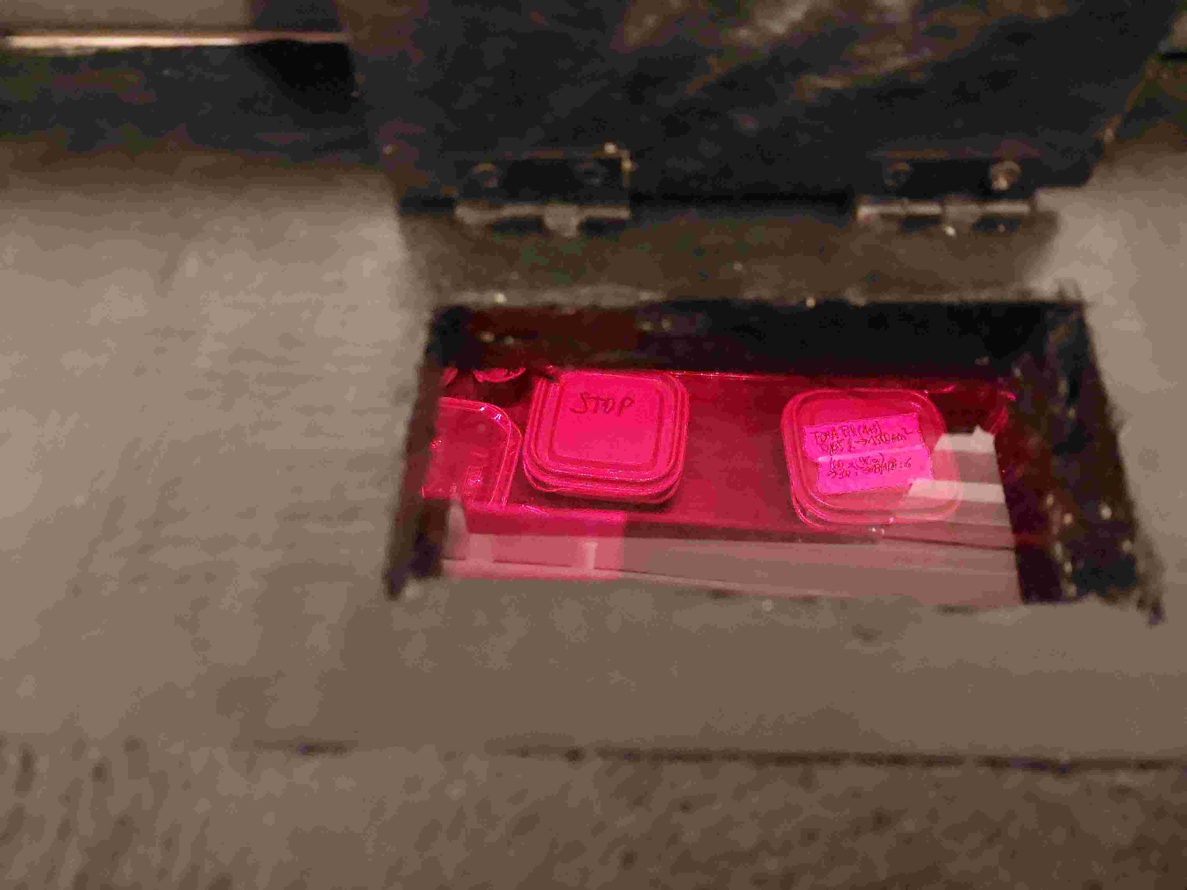

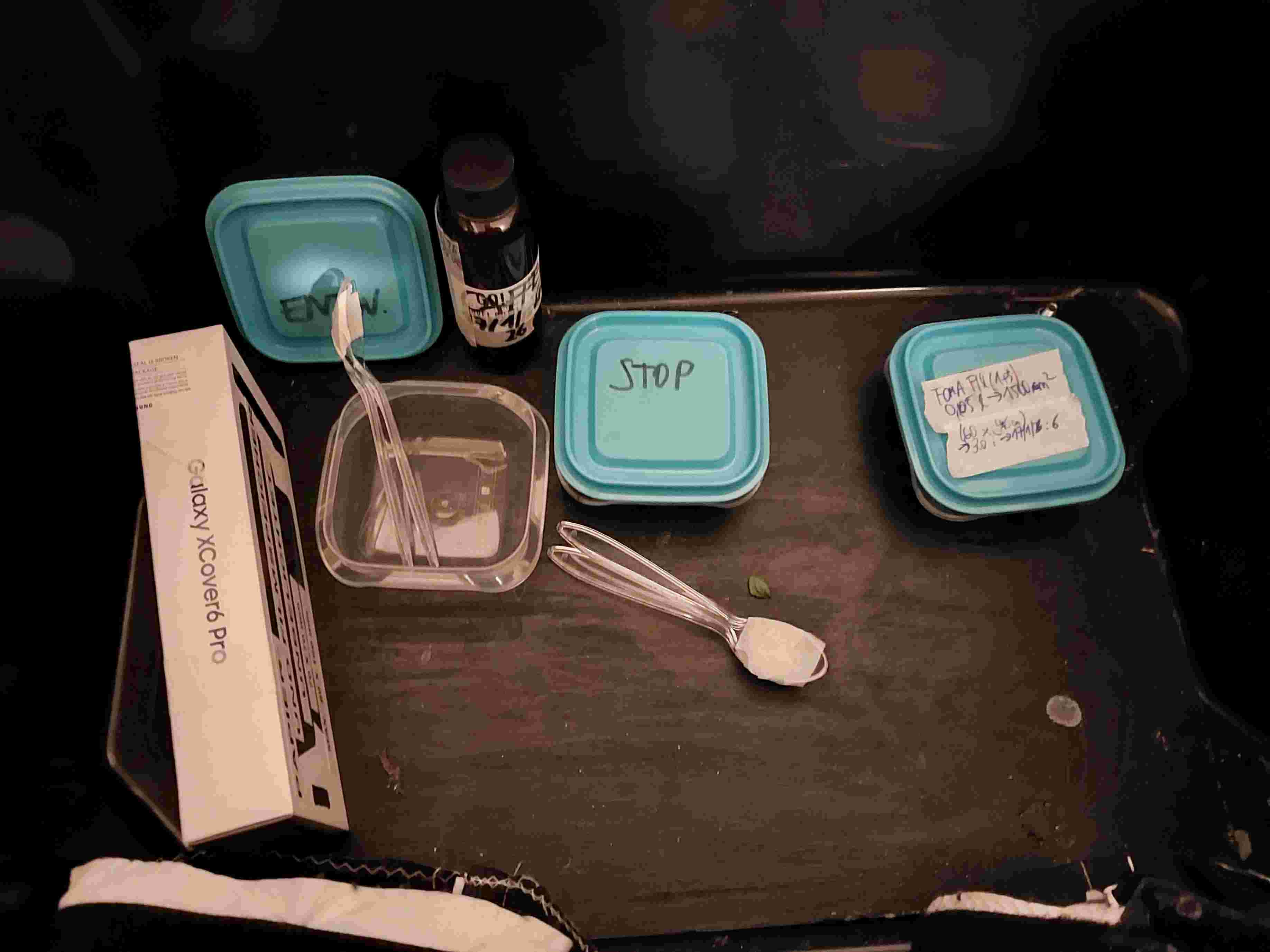

Hello,
When I started with collodium (in 2018) I began to build my own DIY mobile darkroom.
Made of a 33 liters black plastic storage box, some wooden plates, a pice of red plast and a color light (12V LED).Interior dimensions are aprox. 25x35x30cm.Weight 5 kilos.
It works with collodium max. 4x5 inch.With traditional b&w-work up to 5x7inch (2 baths only).
I use it also to load the filmholderes with film and photographic papers, to load the 35 filmcanisters with bulk film.

Sounds nice; looking forward to the pictures. Also interested in how you solved the challenge of getting your hands into the box without allowing light in.
Edit: thanks for adding the images - very creative! You illustrate aptly that it doesn't take a complicated, high-tech approach to just get the job done in a basic manner.

Thanks for your feedback! Your question about the dimensions of an enlarger points out that my term "darkroom" isn't quite accurate. It should perhaps be called a "dark photographic box," unless that term is already taken.

Interesting. What did you make those two long sleeves from? This makes me think of a triangular large format box camera design Ive thought of where two boxes of sheet film could be stored and a third position for the film being exposed. One for unexposed, and one for exposed. With hands in sleeves we can move a sheet from the exposure position to stored, then move a sheet from unexposed to exposure position. The sleeve holdes would be on equilateral triangle sides, the storage and exposure on the rectangular side. This would be a five sided box.

The two long sleeves are made of light-blocking fabric with an elastic band at the outer end to prevent any light from getting in. The sleeves are attached to the inside with black Velcro fasteners.
As you've already gathered, the idea comes from the so-called Afghan box camera, which only has one sleeve.
The second sleeve was necessary because it was virtually impossible to load film into the film holders with just one hand.
This was especially true in complete darkness. Here it is a form of a copy of a changing bag....
Experience has shown that sometimes—for example, when loading or changing film/sheet film—it would be better to have the sleeves lower, near the bottom. On the other hand, this would also require a significantly larger base for the darkroom box.
Your idea with the pentagon is very interesting. You could then modify the plastic box, i.e. , I mean the bottom part.
Are these just rolled up and without stitching? So the fabric is loose at the ends going into the box, so that it is flared outward after going through the hole with velcros on the outiside of sleeve and inside of box? I was thinking about cutting off a sleeve from a dark coat or jacket.
