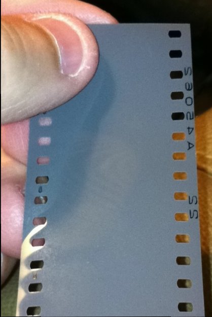

I just bid on 2 old Bakelite Lloyd's bulk film winders. They both look the same age. They were from an estate sale and were really old an dusty. The one that was empty I opened up and the steel stalk in the middle was rusted really bad. The other one was in better shape, and was allot heavier. I opened the film canister tray lid and there was a stub of film. By holding a fresh roll of Tri-X and the other empty winder, I would say there might be between 75-100 feet of unused mystery film on it. So what I did was take a guess and I wound about 10 frames on a spool and shot it today at 200. I just got done developing it in Stock D-76 for 5 minutes to see what would happen. Well the film was underexposed, so tomorrow I will try shooting it at 50 and see what happens. I am trying to date the film and I have no idea. I stopped by my Camera shop and they guy who does the processing says he's never seen this film before and he has been there awhile, as he's the old timer there. The film has no brand or frame lines but of course it has the 35mm sprocket holes. I am wondering what it is. I will post of photo of the film if anyone can identify it... I'm just happy I got free film in the winder to go with the roll of Tri-x I purchased. I will try to post the results of tomorrows test. Fun Stuff. :D

Edge shot of Mystery Film
Ok here is a shot of the unexposed film and it's markings. This is all the markings on the edges. Any ideas..

I have a theory that it is Ansco or Agfa color film, it begins with an 'A' and it also begins with 22, which might be C22, a color film process, long obsolete, film might be 70's color C22.

Well for waht it is worth, those are Bell and Howell Perforations, so it is likly intended for Motion picture use, almost all other 35mm film has the Square kodak Standard perfs.
And you can relax, the little dashes in in between the perfs indicate safety stock. They used that system during the transition to safety and more than 20 years after as information between the perfs does not print through on a movie printer.
The "A" in the footage number Is a code for the type of film, but my two different copies of Kodak Book H-1 don't show it. For comparison a roll of Double X 5222 would have had a C in that position back when they were using the ink numbers. Current production uses a latent image bar code which allows the use of Computer editing. The footage number is used to match the negative with the working positive used in editing so the negative can be cut into the same order.

The film is B&W cine negative. The letter is the film type. Ilford FP-4 cine stock used A, B, or C. Eastman used C for 5222 Double-X, H for 5231 Plus-X, G for 4-X 5224. I don't remember an Eastman negative with A. The number is a footage number. Eastman switched to key code numbers with bar codes flashed on the edges in the 90s, I believe.
Ilford FP-4 cinema negative was ASA 80. It has probably degraded with age, so EI 40 or 50 is a good start.

I don't know the make of the film, but whoever made it didn't do a very good job. The edge markings are backwards:blink:

You Know, my background is not in dating old films. I had put up the undeveloped emulsion, and there were the edge numbers on it. I had also developed the film at 5 minutes at 20C with Stock D76. To test the film I didn't know where I should start with the film, so I shot it at 200. Well after development the film was almost clear but you can still see my faint images on the film. When I first pulled the film after development and rinsing, the film was pretty clear and light. I really couldn't see any lettering per se, but last night I went and reinspected the film with a loupe on the light table. Here are the facts.
"Eastman 18" I believe some kind of early movie film. There are some references online to Eastman on film pre 1925.
S" AFETY- The dot after the "S" but before the "A" shows the film was made in Rochester.
l + % A date code I am still looking up
l "square" "circle" shape.
Bell & Howell perforations (sprocket holes)
The film does not smell like vinegar-not nitrate
I tried to burn the film and it doesn't burn very easily.
It also does not tear easily, but not knowing how other film tears I don't know. I really had to yank on it to tear it so I am guessing that it is post 1950.
The film I believe was made in Rochester of course. Safety film was produced after 1950. There are some exceptions to that rule, but I don't believe for 35mm. Mostly 16mm. There are also perpendicular black tick marks on the edge every 4 sprocket holes which when perpendicular denote that the film is not nitrate base film.The film is B&W. I am still trying to figure out the speed of the film. I shot it at 50 yesterday, but have yet to develop it. I believe that I underexposed the film when I shot it at 200, because it was too light, or that I developed it to short. Even If I had developed it longer, the film base was clear, so that would mean I needed to expose it some more, so after I have developed it today, I should be closer to finding the right speed for the film.
I am still puzzled why the film says "Eastman" instead of Kodak on the side. From what I have read so far, the Eastman side signature was stopped after the late teens or mid 1920's. The biggest question is why is this film in a Lloyd Bakelite Bulk film winder. There is a name etched into the bulk winder.
"T. Egelston". So that is where I am in the Mystery film saga.
