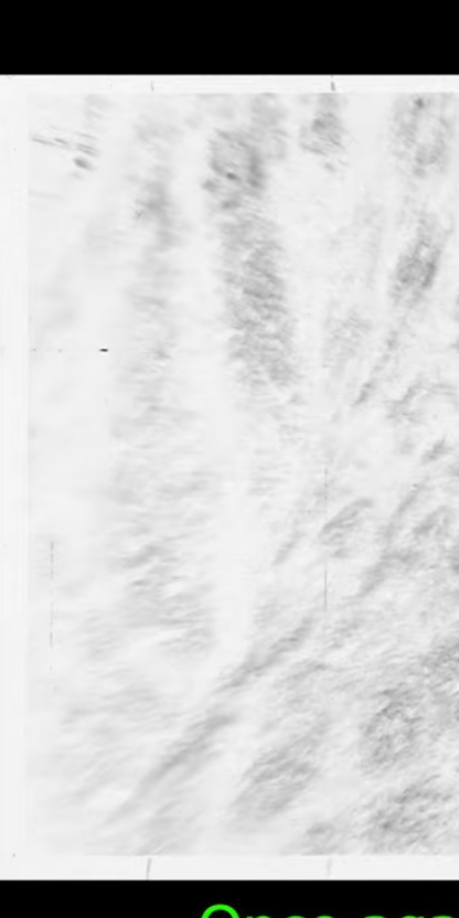

Not sure those are scratches, as they usually scratch emulsion off, so they are light in the negative, and leave dark streaks in the positive.
A dark mark on the negative means it was exposed there, or something sticky there prevented the developer from processing the film. Can you see through the dark spots on the negative, or do they look like unprocessed film?
Too hard to see through scratches. Definitely the whole role was processed properly.

When you show the recent negative, I think you have a couple of vertical scratches on the left side that almost correspond with the stress marks you are curious about.
Mine scratches film too. Your thread has inspired me to head into the "shop" and see if I can rectify the issue. Someone posted the idea about creating a roll of fine grain sandpaper and rolling it through the camera a couple of times. I will try that.

A scratch on the substrate can affect the transparency of the substrate, resulting in less transmission through that part, and a corresponding lighter area in the print.

I have rarely seen dark scratches, and you should be able to tell by examining the negative.
These do not look like scratches,

They look like something dripped or marked the negative while it passed by - were these negatives scanned on a flat bed? If they were scratches, you should seem that on the negative, if they are just opaque spots, that is not a scratch.
These are more scratch like in shape, but I'm guessing they are not:
Vertical lines rarely scratch in the camera, and they are dark. Can you see the scratch on the emulsion, or just a dark line on the emulsion?

This is my thought too. If you bend some transparent plastics you'll see whitening (reflected light) which shows up as opacity on transmission. Could be happening anywhere in the camera even (remote chance) through the backing paper.
Both scratches and the stress marks could likely be alleviated by the placement of rollers on each side of the film mask, but then it would no longer be a Holga... :smile:

I think the important thing with any Holga is to deal with the film going slack by putting a rectangle/wedge of foam in the film and take-up chambers to mimic the roll film springs that Holga don't fit. Keeping a tight roll means the film stays flatter and also stops it vibrating or rubbing against any plastic parts.
My Holga 120 pan has the 2 pieces of foam in it. They were there from the factory.
I used backing paper as a template, cut about 12" of 1200 grit sandpaper and taped it to a start and end leader of backing paper. I then cycled it through my camera 3 times facing the lens and 3 times facing the back. (I honestly can't tell if my scratches are in the emulsion side or not). I'm hoping to run a roll of film this week to see if I solved my issue or not.
I have foam in it, as it was suffering from fat roll syndrome. That solved that issue.
I bought my Holga 120 Pan brand new a couple of years ago, and I have no film scratch issues. I just looked at the film path and felt it with my fingers, and I don't see any parts that can scratch film on the emulsion side.
I also have the two piece of factory-installed gray foam, one each for the take-up and supply side, to add tension to the film. So far the film has been reasonably flat, if I load properly and keep the backing paper tight. It is definitely keeping film flatter than Lomograpy Belair, but might not be as good as Horseman 612 backs.
