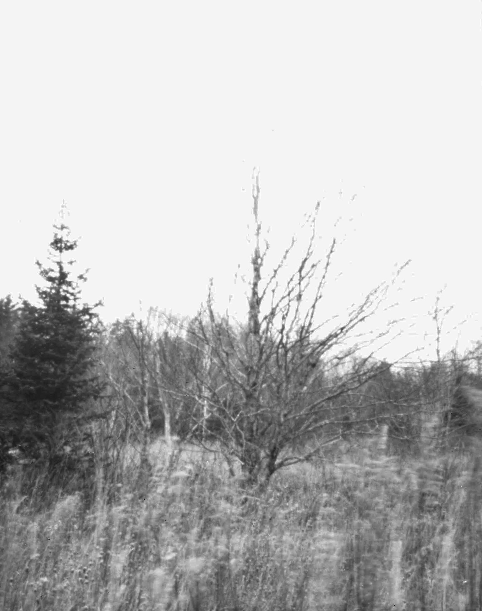

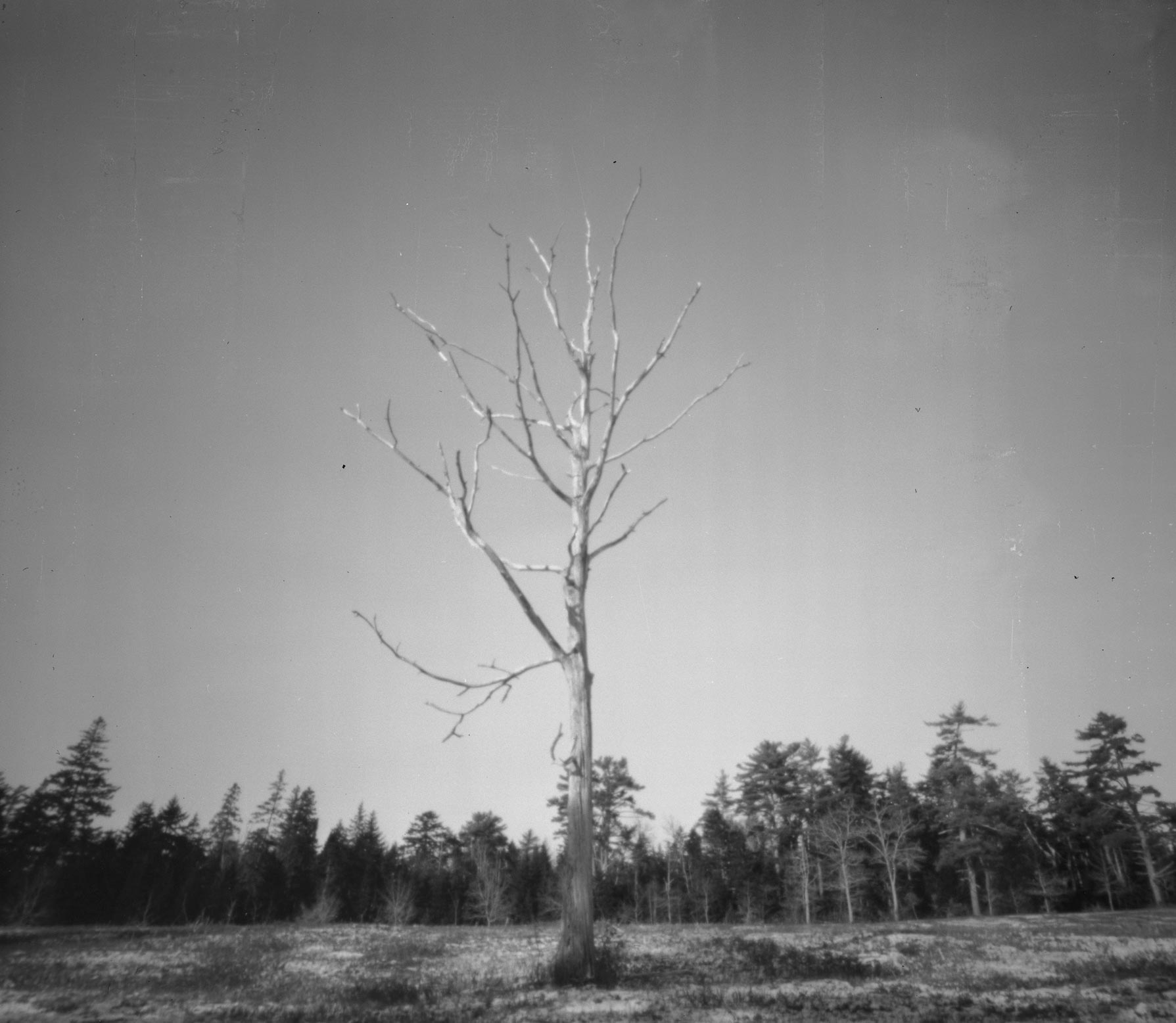

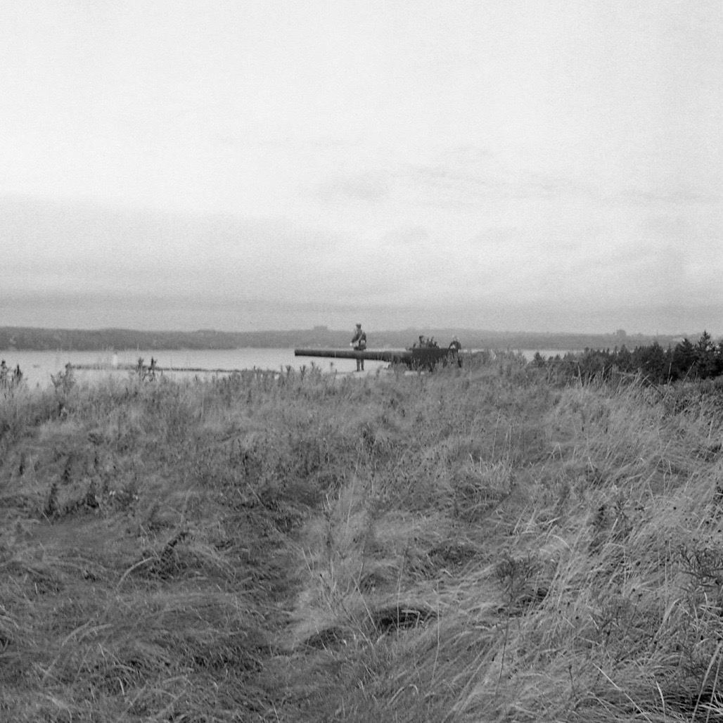

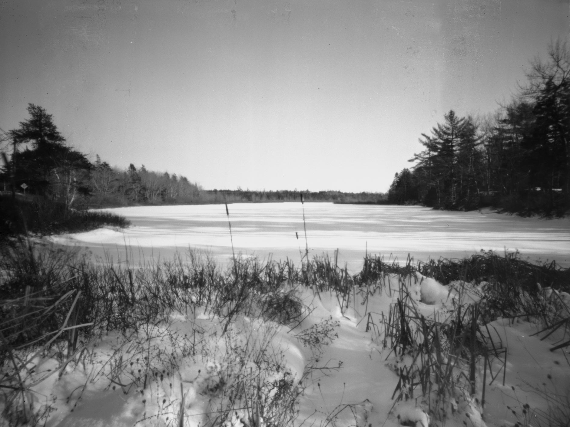

So here are my day 2 results. I think they turned out much better than my first attempt. I just wish I'd cleaned the rollers and topped up the solutions a bit more on the processor. You can really see some gunk that's on the film in the sky. I think I have my film holders all sorted out. Loading the film properly is also going pretty well now. Definitely using the dark slide as the "shutter" has resulted in some clearer photos even though today was much windier. Overall, I'm quite pleased with the results so far!

Hey, those came out nice!
Good job.

I think you're spot on when it comes to that film placement. I must've put it into the same channel as the dark slide or somehow popped it over when I replaced the dark slide on the other side. Either way, user error. They seem to be working much better now though after a bit of practice with that "ejected film" on my end.

Those look really nice. I've often toyed with getting one of these pinhole cameras as a cheap way to experience sheet film. However, I havent done so since I think that would be one step from buying a large format camera. To prevent that I just watch from the sidelines. Your results look quite nice.

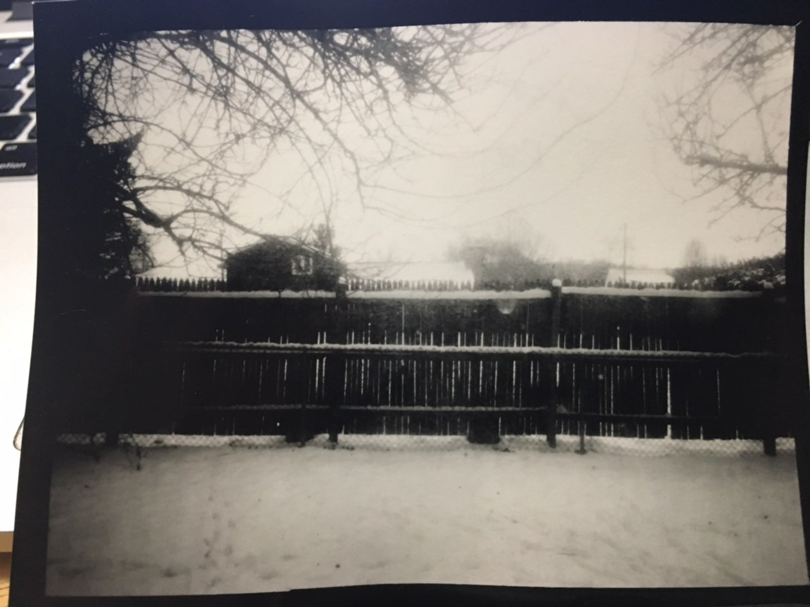

I didn't scan it; it was just taken through a dirty window at my fence. I was just testing the exposure of the paper. I spot metered on the fence and placed that at zone V. It was a 5 minute exposure.

I only pull the slide up enough to reveal the track that the paper goes into, not anything more. That way there is no way to get the paper into the darkslide track.

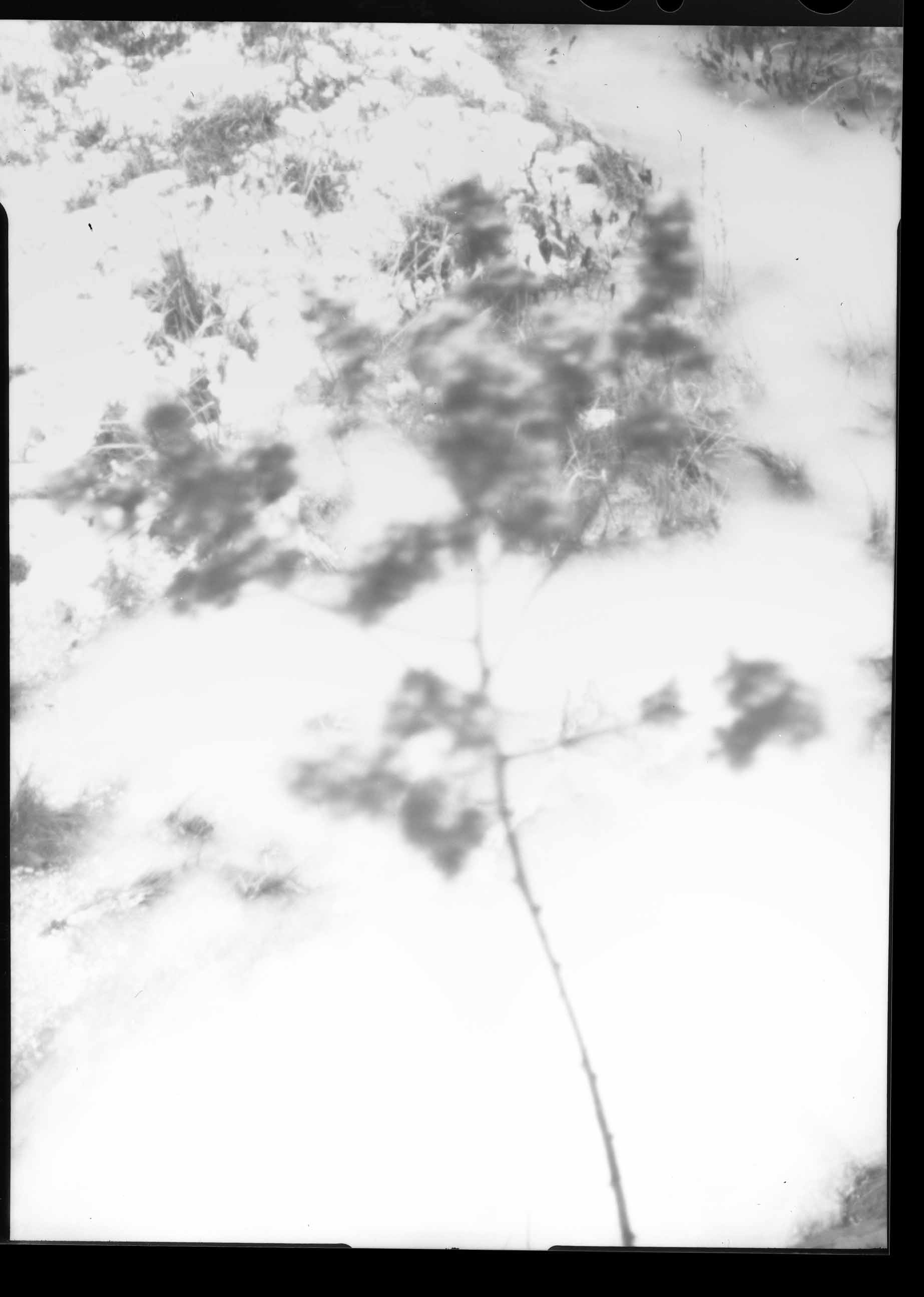

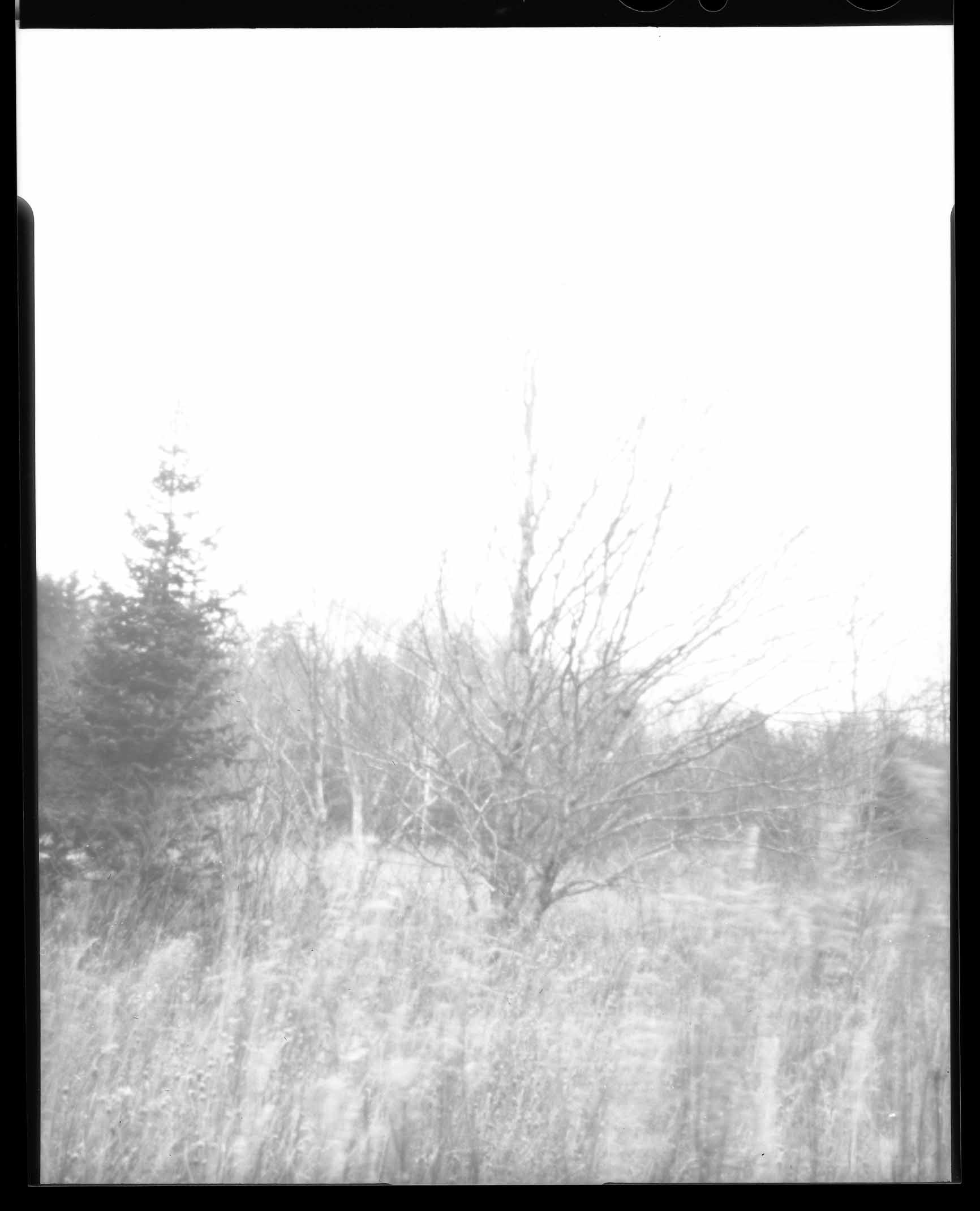

well my day 3 photos didn't turn out very well. 8 minute exposure (compensated for reciprocity as suggested by the app "pinhole assist"). Turned out very overexposed. I've tried to recover some detail with the photo below but this time things just didn't work out.

Was this direct positive paper?
Film FP4+ 125 iso, 8 min exposure on a very dull overcast day. I was using the 150mm cone with F288 pinhole. I had used the pinhole assist app and used the shortest time it had suggested (corrected for reciprocity failure). Here are the photos post scan without any adjustments.

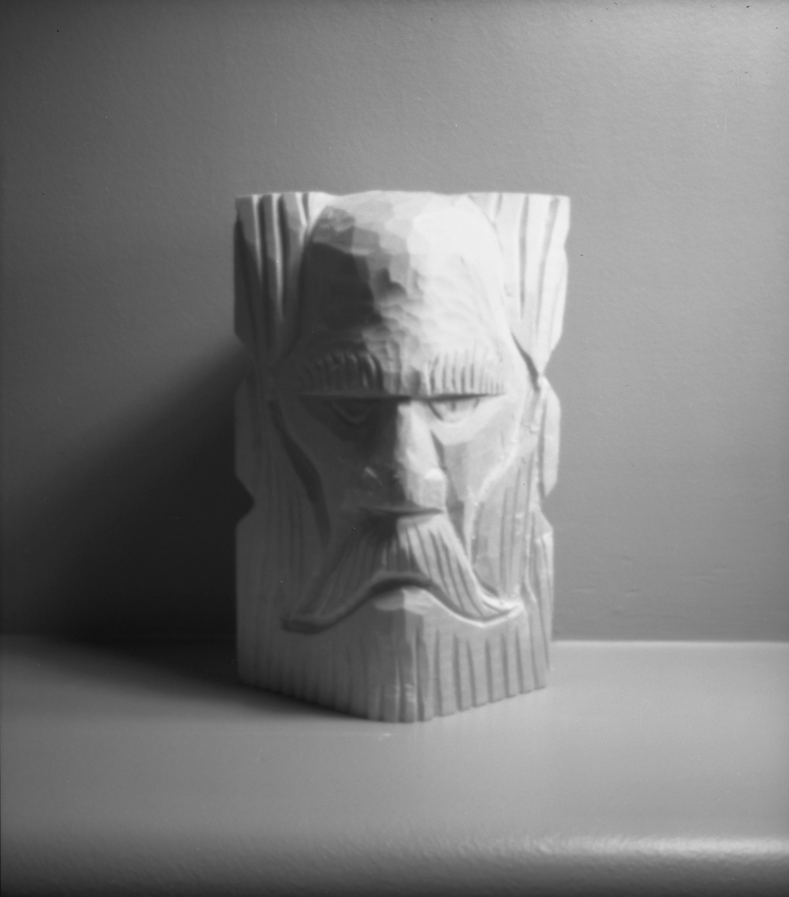

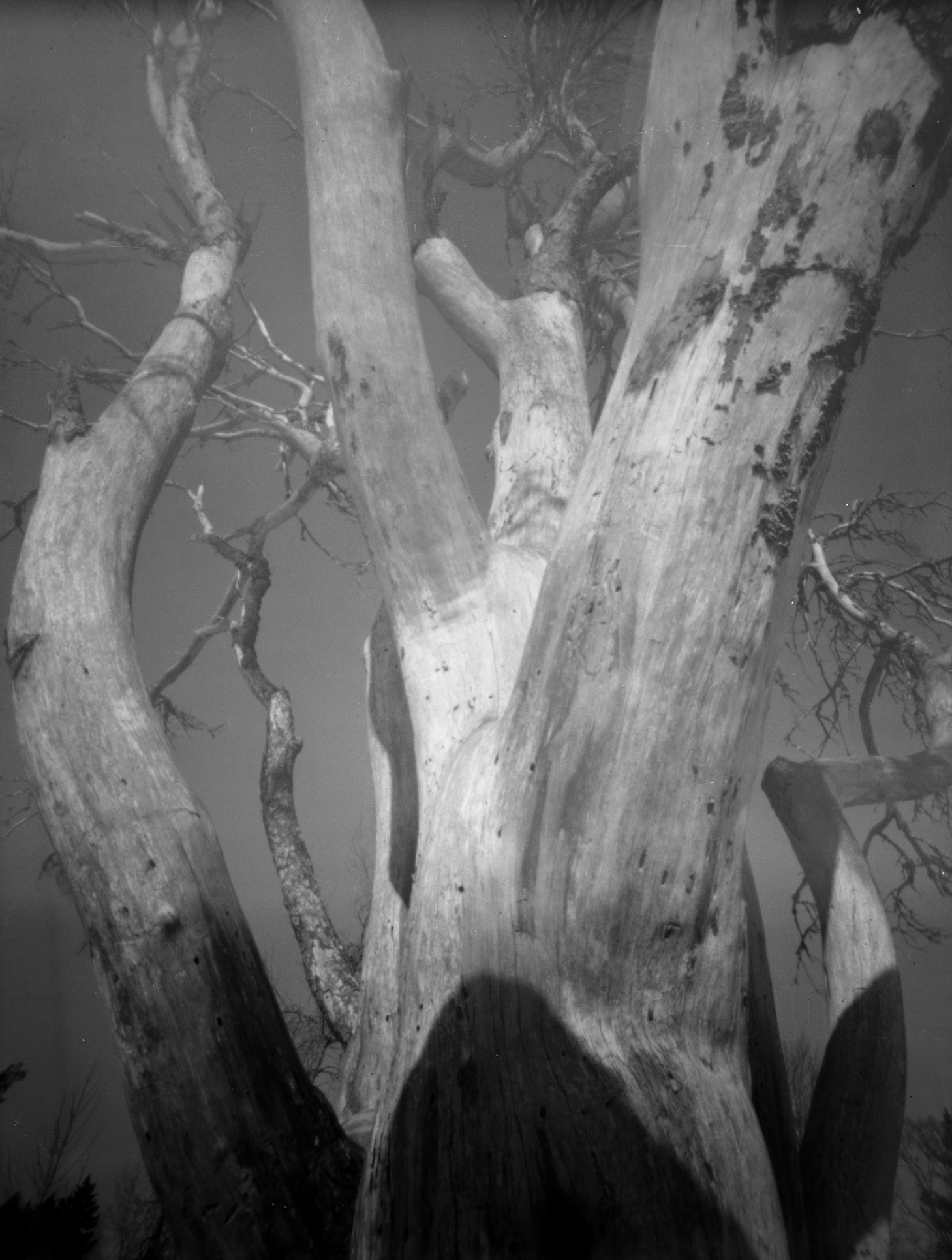

Day 4 results:
20 minute indoor exposure using pinhole assist. Results are considerably better than the previous day. Very happy with the results this time! Noted I get better results when the processor chemicals are room temperature. Also- when stitching using the app "hugin" it is best to crop the photo closely to the image before aligning and then outputting the panorama.
