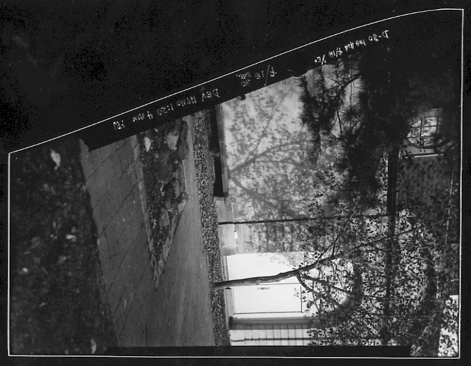

The image is a contact print on Oriental FB MG Warmtone, no filter. Great stuff.
Here's another test image, developed in HC110 1:20. Shorter times (4-6 min vs. 12-20 in the D76) but perhaps too contrasty. Still learning to judge the base fog. Also turned off red safelights for most of developing & handling time, which reduced fog somewhat.
The real trick, however, is learning to write in reverse on the back of the emulsion!
Anybody know how to rotate an attached image to vertical?
