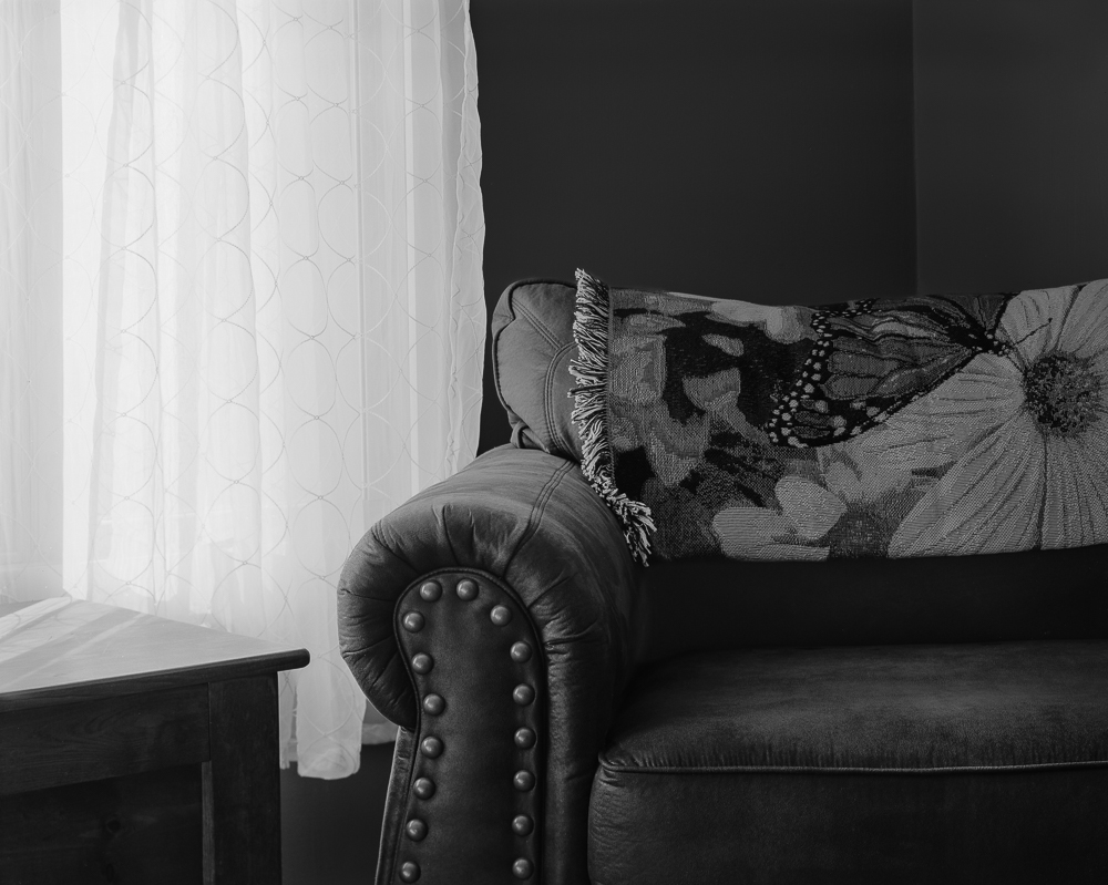

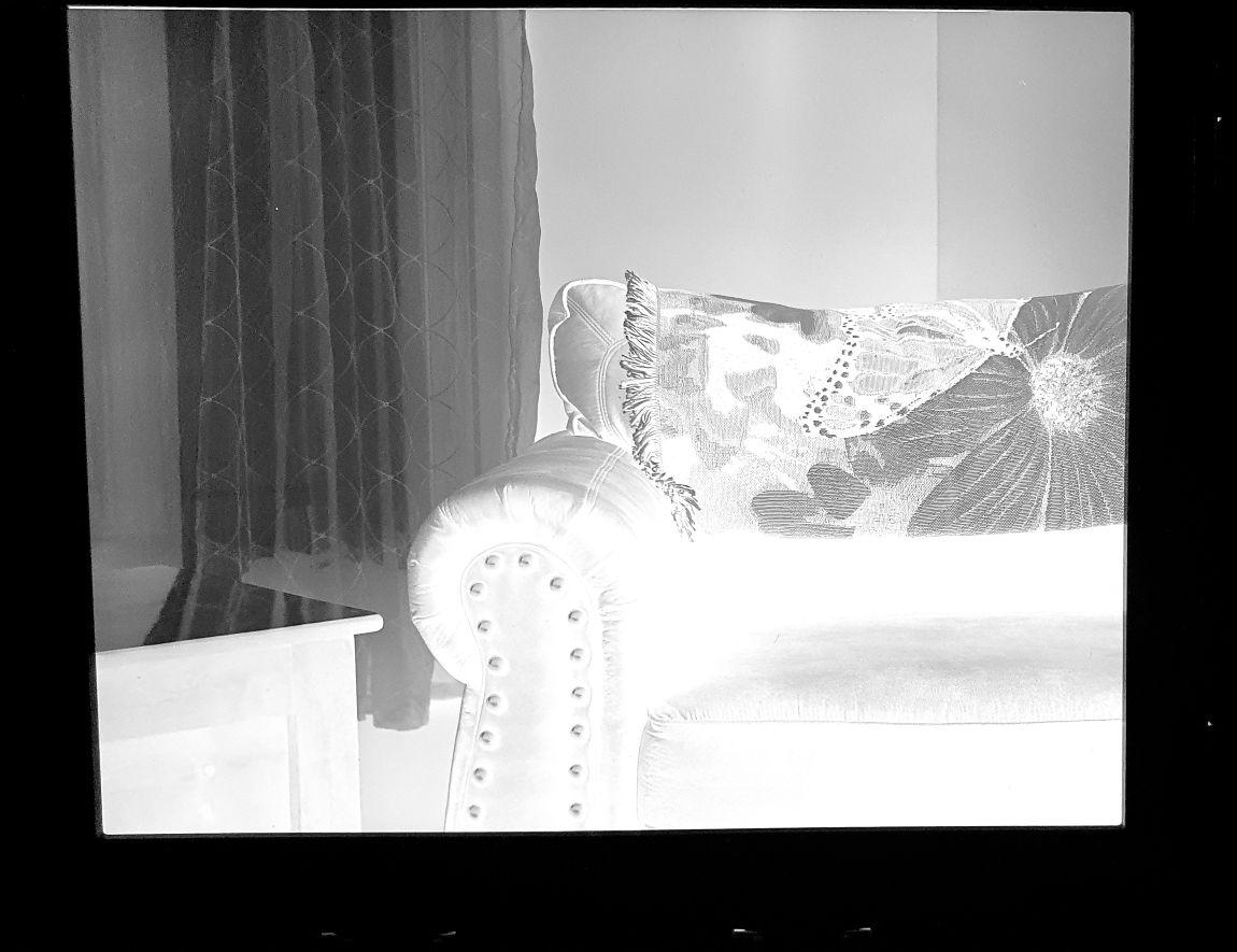

It's a familiar image that I've been photographing regarding my use of BTTB but this time is with tray development. Naturally, I have an issue.
The particulars of the exposure: TMX at EI32, placement = ZIII (chair cushion), fall = ZX-ZXI (high values on curtain); developed in BTTB7 (7g s. metaborate in bath B); 4 min in bath A with continuous agitation following Kodak's instructions as seen in the J-1 publication; 4 min in bath B without agitation. Two sources that I have read: in The Negative and in a quote from BT that was posted in a different thread say that with this process, no agitation in bath B. Thornton's was more like.........no agitation is ideal. He spoke regarding preventing streamers from sprocket holes due to no agitation but alluded to it working well with unsprocketed film, which would include sheet film. AA suggested 3 min in the first solution but I used 4 minutes.
The first issue is the vertical thinner area on the wall behind the chair, this must be uneven development. You might be inclined to think that it's also uneven development on the far-right edge of the negative on the wall behind the chair where there's more density, but this is accurate. The second issue is that speck on the curtain; this is actually the film base. Perhaps something on the negative in the holder, but I take great pains to prevent that, anyway..........probably so, just wanted to point it out since it is my first effort at tray development. The bigger issue is the uneven development, and I don't understand it. My prior similar images using the SP445 tank were developed at 4.5min each bath and with intermittent agitation in both baths. Bath A: 5s/30s and bath B: 5s/60s.
The two sources I mention have two things in common: as stated, no agitation in bath B, and both are speaking relative to traditional grain film; why then, is this occurring? Could it be continuous agitation in the A bath, surely not? My first effort at BTTB using the tank, I also got uneven development without agitation in bath B, corrected when introducing the 5s/60s scheme in the B bath. I'll introduce the same or milder agitation to the tray in the B bath with the next sheet to compare.
I have stuck in my mind that agitation in the B bath does not maximize the capability of the two-solution process with regard to high contrast scenes, after all there's two fine sources that seem to indicate just that. But I think that T-grain film does not like it. This particular negative, apart from the uneven developed area, very well could be better than any of the previous 6 using the tank, therefore it's particularly frustrating.
Thanks @MattKing for the link to that blank screen, I never knew it existed, and it was perfect for this cell phone image of the negative. I used the film holder for my V700 scanner to hold the negative about 4 inches from the screen.
This cannot be a defect in the film or development. It must be something in the camera or on the wall.

If this was an internal problem of the camera or shadows on the wall, it should occur on the same area on different negatives - but the effect does vary.
One difference between tank and tray should be that you have to pour the developer into the tank - which should count as a form of agitation. If you put a sheet of film into a tray, there probably is less agitation to the film.
When pouring the developer out off the tank there also should be more agitation to the film as to taking the sheet out of the tray.
Also question is how much you agitate the tank in relation to the tray. If you invert the tank, you may be agitating the film more than by lifting the tray a bit.
You said that the uneven development did disappear when you added agitation to bath B using the tank. This indicates that more agitation does produce even development - and that there is too few agitation with the tray.

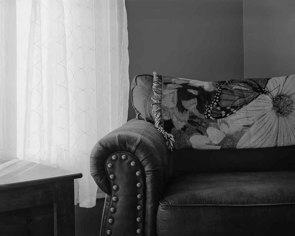

But my example indicates, to me, that the two-bath development produced a better looking, more informative negative under the same exposure and scene contrast than the negative from the single-bath XTOL
The problem is that you did ONE experiment which apparently failed for whatever reasons may have played a role (process control issues, inappropriate process parameter choice, chemical deterioration etc. etc.) That single experiment cannot be taken as a basis to conclude that by definition a two-bath developer is better.
What you're trying to do with the indoor scene you've shown so far can perfectly well be done with virtually every single-bath developer. It doesn't even require any N-2 etc.; just rate your film at box speed (which is perfectly fine for TMX) expose so you have detail in the shadows where you need it and process normally in whatever you fancy; D76, XTOL, Rodinal et. etc. and will come out just fine.
IDK what went wrong with your single XTOL-processed sheet and if in fact anything went wrong to begin with. All I've seen is a single scan which is dark for the XTOL scene, but that doesn't tell me anything about the negative in question. Maybe the negative is fine. Maybe the negative isn't fine, but your developer was old or somehow bad (it's XTOL so liable to dying quite suddenly; Fenton reaction), maybe you f-ed up the processing, maybe....
All I'm saying is that you seem to haphazardly jump to conclusions. I don't share that conclusion because I suspect that the experimental setup is fatally flawed.
I think Foma sheet film is a thin emulsion but not as thin as Tmax or Delta
The whole 'thin emulsion' thing is a gross simplification and not really relevant. What matters most is the degree of hardening of the emulsion and thus the volume of water it can absorb. If you take the exact same gelatin load per square meter and harden it at various degrees, you'll see that the degree to which it'll swell (absorb water/developer) will vary considerably. This is one of the key differences between Fomapan and Kodak films; the Fomapan films are generally hardened much less. How physically thick the layers are is not all that relevant; ultimately it's about how much volume of water they'll absorb. For the rate of absorption, it's furthermore relevant how hard the topcoat layer is and I suspect that in this regard there are very, very big differences between e.g. Kodak and Foma films.
I also suspect that the hardening of the top-coat in particular plays a big role in development evenness, with a very hard top-coat making it more difficult for processing liquids to diffuse through the emulsion. Tiny fluctuations in thickness of the layer stack and particular the top-coat can very well translate into greater risk of unevenness under marginal processing conditions. Such conditions are deliberately invited in a 2-bath development regime.
Overall, the most dependable approach to obtain perfectly even development is to ensure a steady rate of diffusion of active developer (and other processing liquids in subsequent steps) through the emulsion. This is very much like the age-old diatribe on stand development and dramatically reduced agitation schemes - yes, they sometimes work, and yes, they're also more prone to evenness problems, and yes, it's been demonstrated time and again that the boring, conservative approach of agitating every at least every minute or so works very well. So if there are problems with uneven development, the very obvious thing to try first is go back to that known-good state that we've known about for over a century, and get that to work. Then, if there's a compelling need, go back to more fancy experiments that are also more liable to give problems, and see if those can be sorted out.

Of coarse my thread is about tray processing and uniformity of development and this sidebar discussion is entirely my fault. So, my apologies. I will give you the last word, below are my last words on it.
I'm only concluding that in this instance the N-2 development for XTOL produced an inferior negative to the one developed in BTTB. The exposure and contrast for each negative were identical. I don't know how to convince that the XTOL development (my processing) or the developer itself, or the exposures was not at any fault for producing what I consider to be an inferior negative. I am merely saying, in my opinion BTTB did a better job in that instance, and that's all I'm saying.
Nothing went wrong with the XTOL N-2 processed sheet. It's bit thinner negative across the board as is expected with any N-2 contracted development. Compared to the BTTB negative developed for even less time than the XTOL negative, the former simply was a superior result. Granted, it's just a single scan and I see your point and granted, there's different ways to skin a cat. The negative is fine, and I could print it, but it is not as fine as the other one, the developer was definitely not old, and I didn't F-up the processing. Like I said, I don't know how to convince.
I'm telling you what I did and it couldn't have been a simpler set up. Meter, expose, make notes, flip the holder, verify the meter, expose again, make more notes, develop. You must feel the fatal flaw is in the "develop" part or the "expose" part or both, well, I've no way to prove myself to you on it. I can accept if you disagree with me, that's ok, I'm not getting fluffed up about any of it. If you knew me, you would never be able to accuse me of haphazardly concluding or doing anything. This is not saying that I can't have an incorrect conclusion, I accept that possibility, but I'm not seeing it............yet.
Precisely.
It has varied with each tray-developed negative. The tonality of the wall should not have any irregularly shaped dark areas at all. From the right edge of the negative and from the edge of the curtain next to the wall, the tonality of the wall as it progresses toward the corner of the walls should gently fade to a lower reflected value and be at its lowest value at the corner. In setting up this little experiment, I did the best I could to make sure that each exposure was made around the same general time of the morning and catching roughly the same light intensity at the window (albeit on different days depending on the sky conditions), feeling that is important to my evaluations. All the low and high value EVs for these exposures confirms this. All this to say that the wall is not being affected by irregular shadowing or added density due to internal bellows reflections. I appreciate all those observations, but they are not the case, there are several negatives in these light conditions developed in the 445 tank that show absolutely none of these uneven areas of development. I grant that there's probably some beneficial flare on the negative helping out the shadows, I'll take it.
All your statements are in line with my own thoughts on the tray versus the tank development. Though the agitation at the film surface is entirely different, the other textured areas of the negative are nicely developed in the tray and I guess any unevenness just can't be detected. So, it certainly seems that the wave action type of agitation provided in the tray is just not adequate with TMX. But others have had uniformity issues with non-T-grain films too, so I guess the reality is that T-grain has no real bearing on it, as was postulated by Milpool in his post #13. I only use TMX so I have no other comparison.
I don't feel the need to post it but I completed the third tray developed sheet (still 4 min each bath) making very certain that I kept the emulsion side up in the transfer to the B bath. I gave no agitation in the B bath, just in case Doremus' observation settled the issue for me, and in that instance, I'd end up with a uniformly tray-developed, continuously agitated A-bath negative without B any bath agitation. But to no avail...........the uniformity is still present, but not as bad as seen in my post #12. Was it due to insufficient tray agitation in bath A or no B bath agitation, there has been unevenness with bath B agitation...........Idk, it's confounding.
I have one more negative, but it will be developed for comparison purposes against the tray developed negatives in the SP445 tank. It will be given 5sec/30sec agitation in bath A, and I will give no agitation in bath B, still giving that idea of no bath B agitation concept a try. I'll see what happens.

Ok, I'm not keeping my previous word as being the last, but you ask a good question. I ask that then, that if anyone is inclined to hammer the perceived flaws of the ZS fixed density method of speed determination, to kindly not. This is how I do it.
Since this sidebar topic is comparing the merits of XTOL vs. BTTB, I have to go back to my curve family I generated with BTTB to start with. In that curve family a development time of 4.5 min produced a curve that was on a trajectory, after adjusting it for a speed loss, to reach a N-2 contraction. I checked the densities of that curve at Zones I 1/2 , II, III, and IV. I then bounced those densities against the same curve densities at I 1/2, II, III, and IV of the N-2 development (5m 15sec) in single bath XTOL 1+0. At each zone, the BTTB N-2 density was a bit greater, not by a lot, but it was greater, than each of those same XTOL N-2 densities. I thought that was a positive outcome relative to the purpose behind two-bath development.
Fast forward to my experimenting with BTTB pictorial negatives with high contrast SBR. I have a pictorial comparison of tank developed XTOL 1+0 at N-2 versus a pictorial comparison of tank developed BTTB at N-2. The agitation scheme for XTOL: 5sec / 30sec. The agitation scheme for BTTB: A= 5sec / 30sec B= 5sec / 60sec.
So, the shadow placement I gave and where the important high value fell dictated contracted N-2 development for both negatives. I reason, what a fine time to compare XTOL N-2 with BTTB N-2. This is simply a comparison of one developer at N-2 vs. a different developer at N-2 of the exact same scene contrast and exact same shadow placement for each.....................and with that comparison, I'm putting the BTTB negative in the enlarger instead of the XTOL negative. If theirs's one caveat, it would be that the BTTB N-2 curve used 12g of s.m. in the B bath..........but at the time of doing the curve family I don't think I was much aware of the 7g of s.m. in bath B that supposedly helps with high contrast scenes. Perhaps that has made the bigger difference in the BTTB pictorial negative in my little experiment, but I really don't know. All I know is, it's plain to see which negative gets the enlarger time between those two efforts.
Naturally, I could've tried my XTOL N-1, or N curve but that's not doing the most important high value any good, the way I see it.
I do not know what more to say about it if this is not sufficient for you. But I appreciate all your contribution for sure.

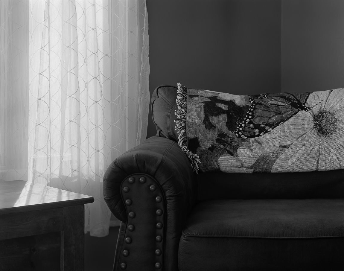

Well, here's the final negative but it is developed in the 445 tank but without bath B agitation, I wanted to give that another shot with the tank. There's still some uniformity issues in the wall area imo, but really not that bad. I brought the wall value down in post just to see how well it might be hidden so to speak. I think I am resigned to stay primarily with the tank development in general and especially with any bath B agitation since my earlier negatives in the tank have no uniformity issues at the wall area. Perhaps I might develop some negatives in the tray where there is no real risk of actually seeing where uniformity issues are going to be most obvious. Even though the agitation of tray vs. the tank, to me, is entirely different at the surface of the film, the tray negatives, where there will be adequate texture were also very nicely developed.
I've no problem continuing with experimenting with tray development of this scene, but I wouldn't know how to proceed differently to justify another negative or two with any decent hopes of success. I'm open to other suggestions but it's probably the case that if there was a better way in tray, it would be known. Someone remarked, I think, that multiple sheet development in a tray actually provides much better continuous agitation to the sheets. But I won't be traveling that road for sure, I don't need that amount of frustration, just handling one sheet was slippery as it could be and felt so clumsy.

Looks better, but I recognize you still have some uneven development going on. On scenes with open skies this may become a problem at some point.
I remember troubleshooting unevenness issues with x-ray film in trays. X-ray film is exceedingly prone to unevenness, so that was a bit of a torture test. I figured out an agitation pattern that would give me virtually perfect evenness every time; it was continuous, relied on a tray a little larger than the print (but not a 'full size' larger as often recommended, although that would also work), and lifting & dropping opposing corners of the tray while at the same time watching the flow patterns on the developer surface (x-ray film is insensitive to red, so I could see what I was doing). If I kept the motion of the developer constantly moving, but gently so, I could skirt between the Scylla and Charybdis or excess edge density (too much agitation) and mottling (too little agitation; the problem you seem to be having).
I only did very brief experiments with two bath pyrocat with x-ray film so I can't help on you that; the only thing I do know is that in those experiments, development was not perfectly even. It took me a while to figure out the pattern referred to above that did work for me - but with a regular one-bath developer.

It’s the type of agitation given by the shuffling method which produces better uniformity than tray rocking. There is no requirement that there be more than one sheet at a time.

Mark Citret, for one. Without too much fuss the agitation given by the “shuffling” action (interleaving is probably a better word - in any case it can be done with one sheet or multiple sheets though multiple sheets introduces the risk of mechanical damage) seems to produce fairly good uniformity, and better than manipulation of the tray.

I second the motion to agitate as in the shuffling method. I've found tray rocking to be inadequate. If you just have one sheet, lift it from the developer, rotate it and resubmerge at regular intervals. Be careful not to push the film down into the developer quickly, as this causes developer to surge at the edges giving you hot edges.
