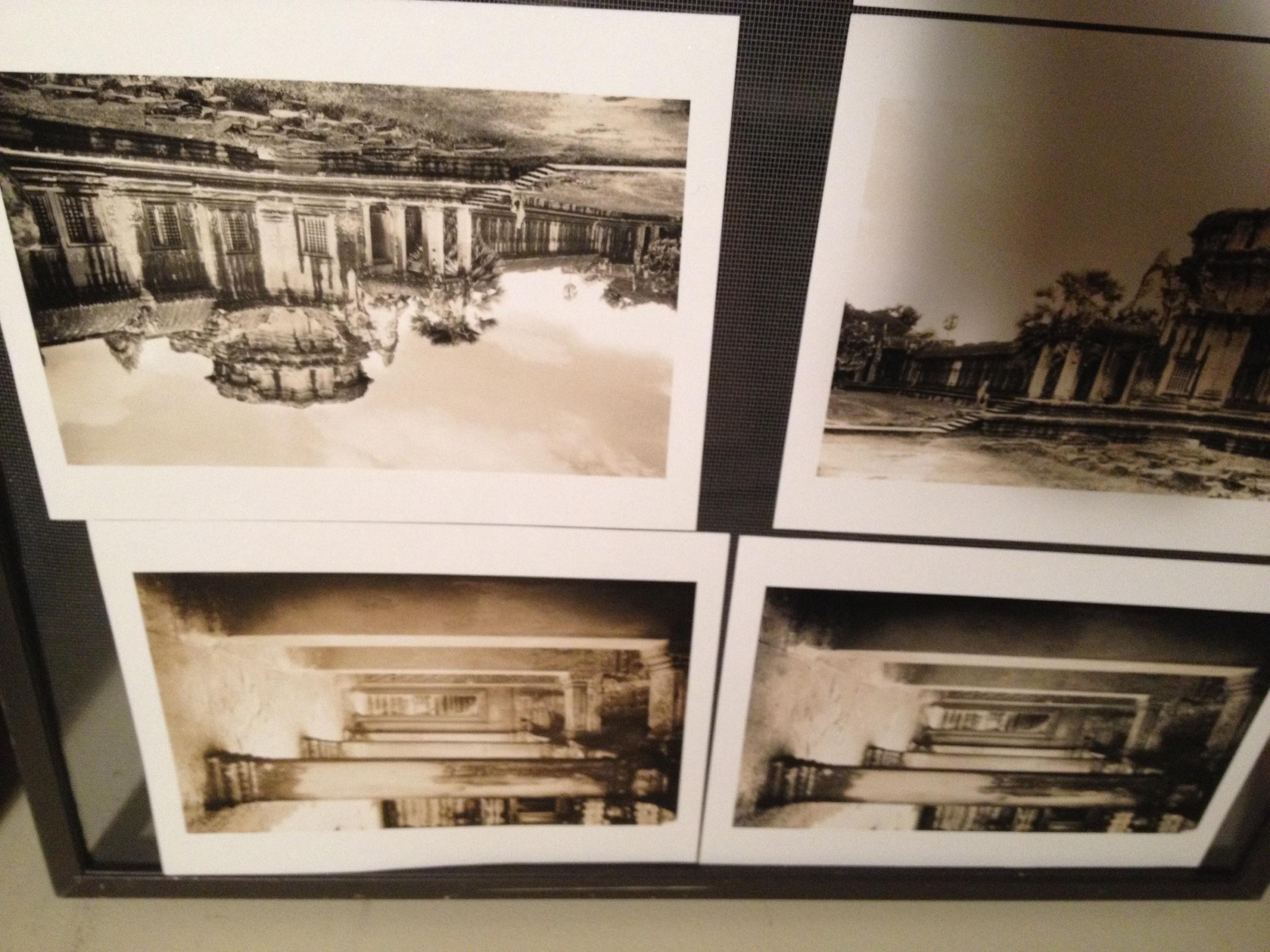

My first shot at Thiocarbamide toning

I like the look, but I'm going for a more subtle warmth. I think I might have to dilute the bleach more. But I like it because the process has no sulphery stench. image.jpg

I really appreciate the information. I finally looked at the dried prints and they look pretty good. I didn't know that thiocarbamide is a carcinogen. I'm going be very careful in handling it.
Best,
Don
