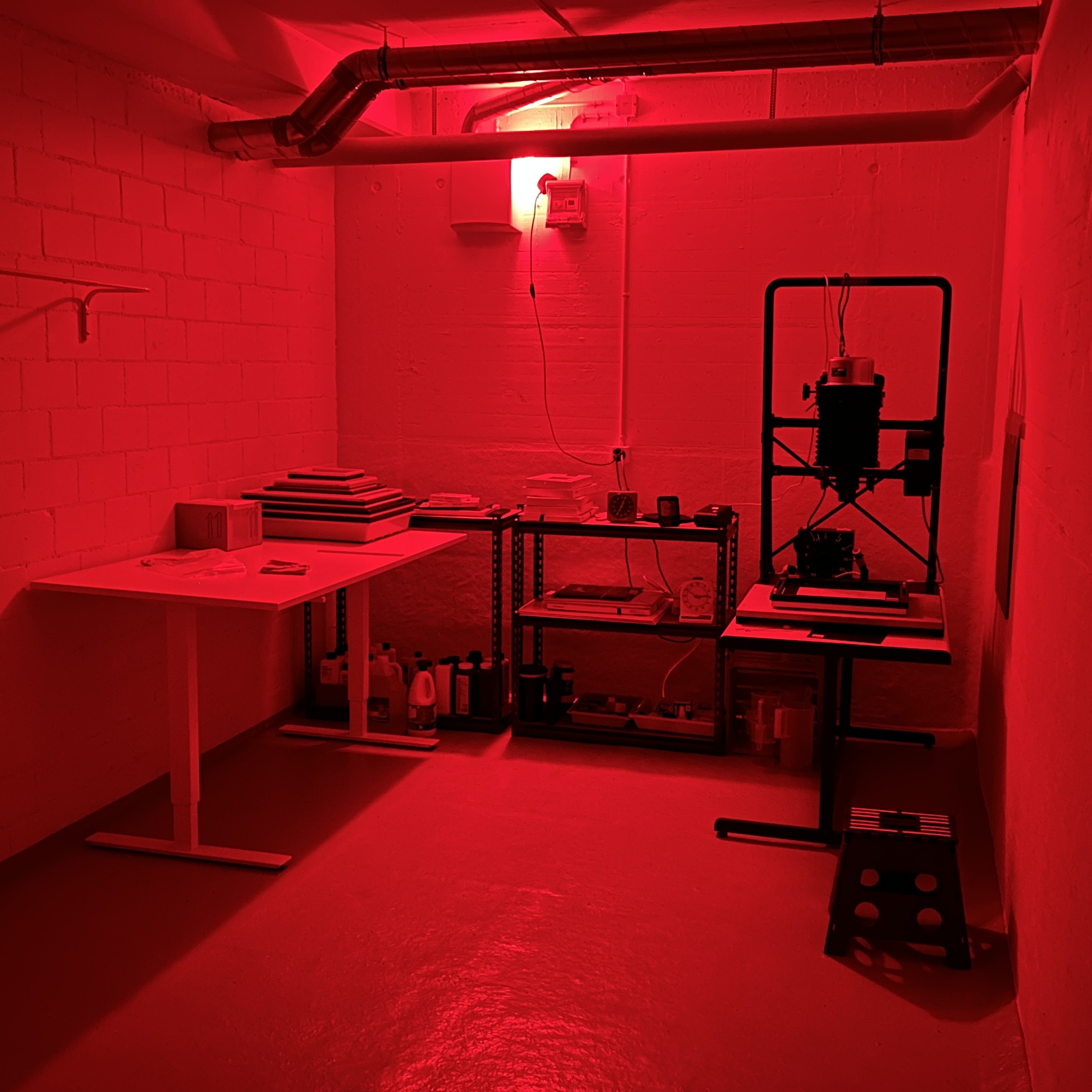

Hello friends,
It's finally here. I have my first real darkroom, no more guest bathroom :smile: I don't have running water, but that's not a problem for me.

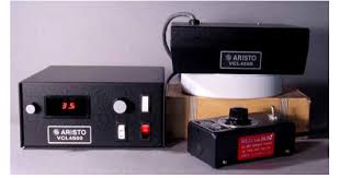

I have a question: Do I have to turn on the heating element on my Aristo Coldhead, or can I use it without it?
It should help getting consistent exposures. So yes, probably a good idea. But test it to be sure; do one session with the heater on to verify that everything works as it should. Then if you've established that, try a session without the heater and look for variations in exposure that you cannot explain otherwise.

Before trusting your safelight, I’d advise you to test it by means of the coin test, with your usual materials in a typical process. My safelights were similarly bright, and I found I had to turn them 180 degrees to reflect off the ceiling.

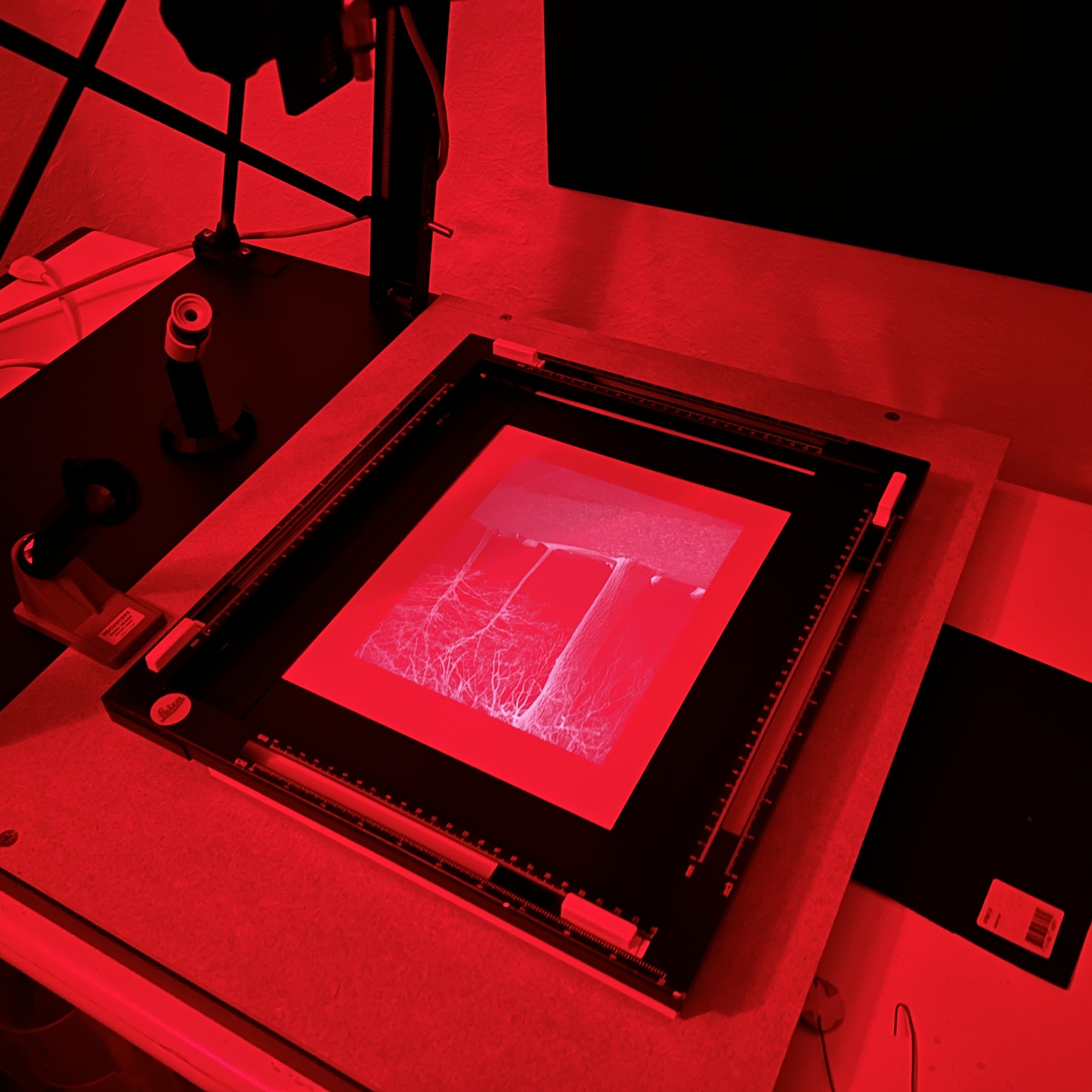

Yesterday i did my first session, i also found the light to bright and repositioned it to the door the other side of the room 6m away.
This was my first time to enlarge 4x5, it was a portrait of my son taken wide open with 240mm 5.6 nikkor. I did a 8x10 cropped a little bit, it turned out extremly sharp, with a loupe i could see details not seen on my scan, much more details, i could see every single grain particle sharply.
The print poped out from the paper, like 3d.
Last time i saw that was when a proffessional artist explained to me how to enlarge images in darkroom, now after years hunting exactly that, i am there.
Very happy right now.

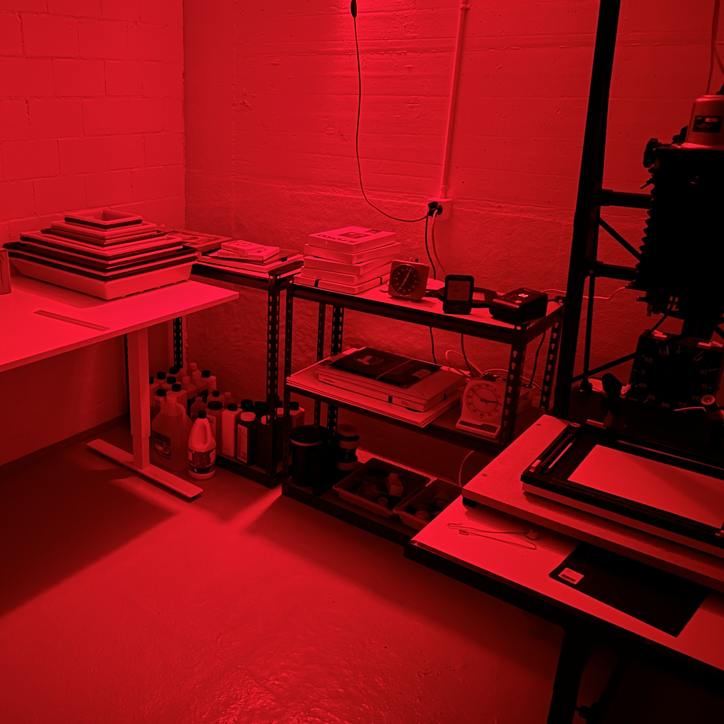

It's so neat! You are, however, missing an essential tool: the garbage can.
Hi don,
Its on the other side of the room :smile: with the kodak projection scale and using small snippets and splitgrade printing i dont need a big one :smile:
Thank you i am going to test it.

If you want to test your safe light setup, the coin rest isn't really sufficient. Kodak has a good test prosedure.
Plug the cold-light head's heater in about 1/2 hour before you start a printing session. Expect some exposure inconsistency even with the head warmed up - it is the nature of the beast. I used to leave the enlarger on except for the times when I was loading the easel or developing the paper. I finally got rid of the cold light head and life improved - YMMV and all that.
A compensating timer (properly an "integrator") can help a great deal with print consistency when using a cold light head. They haven't been made for some years, though RH designs may still have an integrating variation of their f-Stop timer.
If you plan to do split grade printing make sure the cold-light head has a fluorescent tube suitable for variable contrast paper. I had an early head that would print at grade 4 1/2 with no filtration, with a #00 filter I could get the contrast down to grade ~2 1/2, maybe.
+1.
The simple coin test tells you if you have an obvious problem with fog.
The Kodak Safelight test tells you if the safelight is decreasing the quality and repeatability of your prints, as well as whether you have an obvious problem with fog.
And yes, it is quite boring to do!
You might want to mount the safelight up high over the tray area, pointing up at the ceiling in a way that the light covers the whole darkroom. And if you have a safelight outlet on your timer, it can be really helpful to power the safelight from it, because the safelight goes off when you are actually exposing the print.

You need to plug it in 30-45min before use. That brings everything up to temp for consistency's sake.
I have recorded the light output on the easel (with a LunaPro and enlarging attachment) for every lens/height combo I normally use.
Before I start printing, I install the lens of choice, move the head to the required height, and "focus" an empty negative carrier on the easel.
I then leave the light on for 30-45 seconds and measure it at the easel. If it does not essential match what I've recorded as "full output" in the past, then head isn't fully warmed up. The reason for the on time is that - even
with a preheater - the light output on my Zone VI VC CL head does rise in the first 45 seconds or so before
settling down, so I measure it then for full output.
