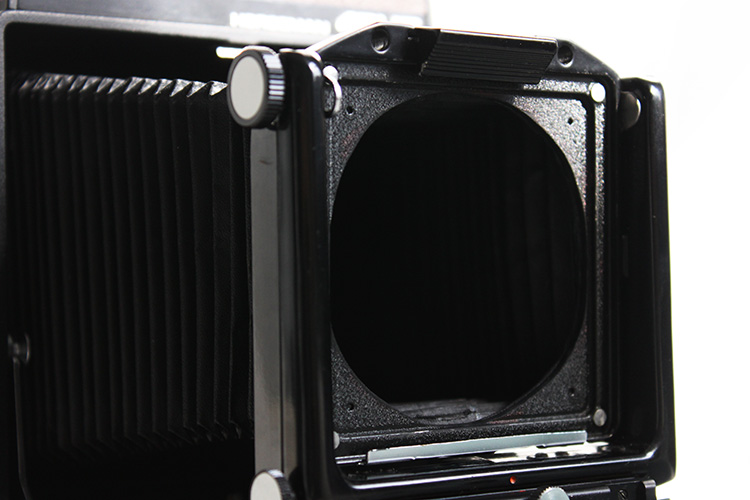

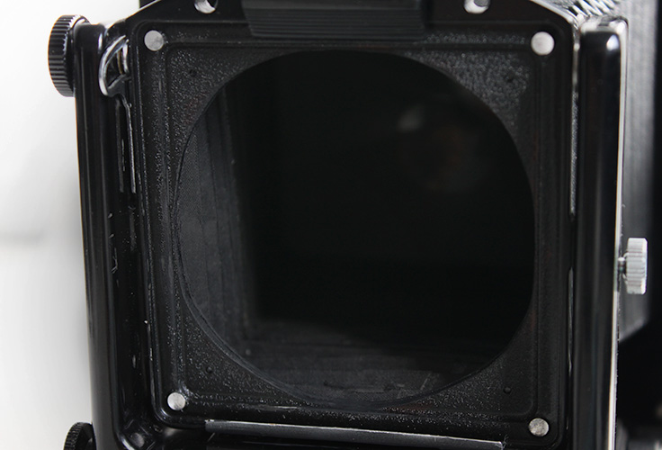

I have the opportunity to pick up a Horseman 45HF with sinaron 90mm f4.5 along with four film holders for $1,000. Apparently the porthole was modified in order to accommodate this lens and others.
The camera appears to be in great condition and i will be able to check it out before getting it. Being thag i am new i would appreciate advice in this area! Quick suggestions would be appreciated!

The Sinaron 90mm f/4.5 is a superb lens - it's the same as the Rodenstock Grandagon 90mm f/4.5. Yes, it's commonly available in Copal leaf shutter like other lenses; not all Sinarons are mounted in the special DB board for Sinar monorails with Sinar shutter.
The price for that combination would be fine, but there's a very big IF:
Normally, the rear cell of the 90/4.5 is too large to fit through the opening of a Horseman 45HF. Presumably what has been done is that the front standard has been carved out to accommodate the large rear cell. Because the front standard of the Horseman field cameras is so small to begin with, I'd really need to see the result in order to judge whether I'd be comfortable with it - has there been any effect on the structural integrity of the front standard or on its function, has the bellows been affected, etc.
Also bear in mind that 90mm is distinctly wide for 4x5. It may not be the best choice of focal length for an only lens if you're just getting started in LF.

i would like to thank everyone for their suggestions and advice. The comments seem to be somewhat mixed. I asked for some additional pictures (of the modification as well).

Looks like I will probably be going with a Crown Graphic to start. However just because I said I'd post the mod pictures, I will put them up in case it is an option for upgrade in the future. Thanks!
