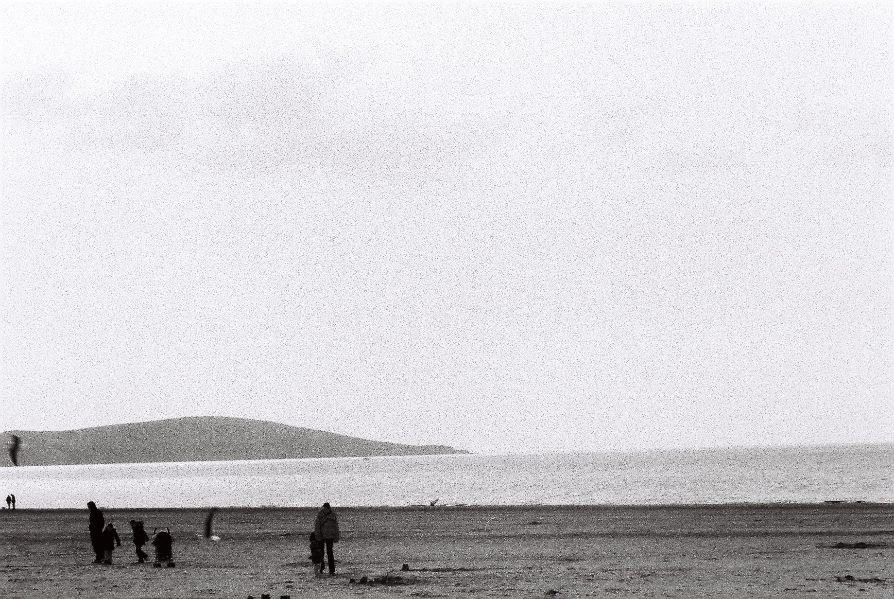

I have recently purchased a Pentax k1000, and a P30n. I shot 4 films, 3 kentmere 400 b&w and 1 Fomapan b&w. I am aware i have a lot to learn, and am the definition of an amateur photographer. Therefore i wasn't sure what to expect, but nevertheless the results disappointed me. This may somewhat be down to the results i have seen from other people using the same cameras as me. I don't know whether or not the unsatisfactory results were down to me (i did use one of the kentmere 400s on a sunny day), the film, something to do with the cameras, or the photo lab i used. A few slides were blank white, and a few had parts whited out. A lack of quality, and sharpness is also apparent. If anyone could shed some light, in the form of friendly advice or even recommending a helpful book/article to help me understand better, it could be greatly appreciated.
Cheers, Pete
(the photos attached are examples of above problems)

They look like bad scans to me. That, and those two films can be very grainy/contrasty depending on developer, etc. Don't go cheap on film. There's better places to save money.

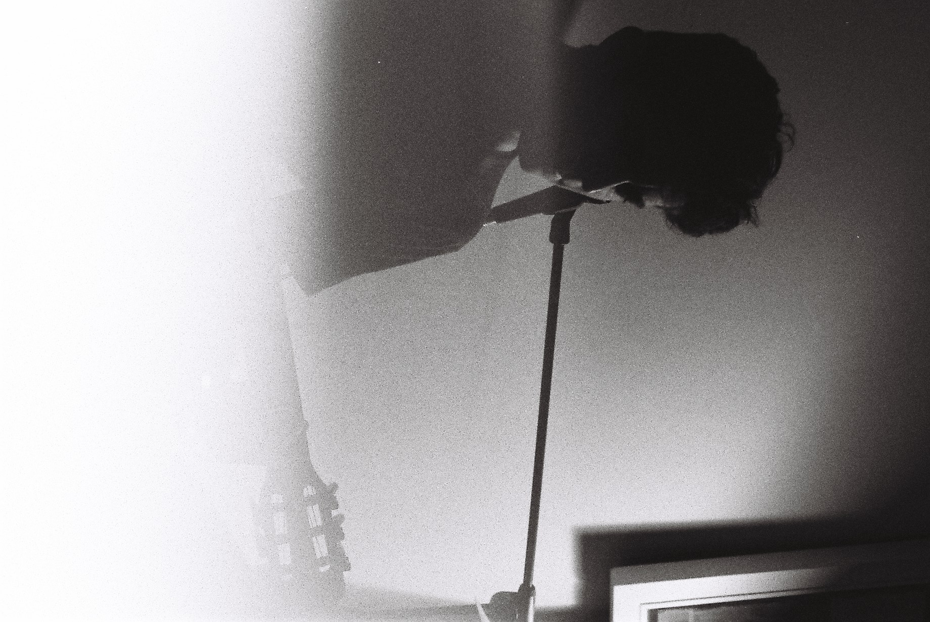

Could you also describe your metering and shooting technique? Photo 4-5 need a yellow or orange filter to bring more definition to the skies and photo 3 is a light leak, possibly in the camera. Did you develop yourself or a lab?

Judging by the size of the dust threads, these are negative scans, and according to the EXIF info they're done with a Fuji Frontier SP-3000 minilab scanner.
At first glance the grain is quite terrible and also looks smeared. I suspect an incorrectly configured scanner - perhaps infrared dust removal was switched on, or excessive grain smoothing was applied.
If you can, try to do some scans yourself with dust removal, grain removal & sharpening switched off, and see if you get better results. (Or even better, optical prints, if you have access to a darkroom.) 100 & 400 ISO films should be capable of better than this.
If photo 3 is the first shot on a roll, it could simply be fogging from when you inserted the film.

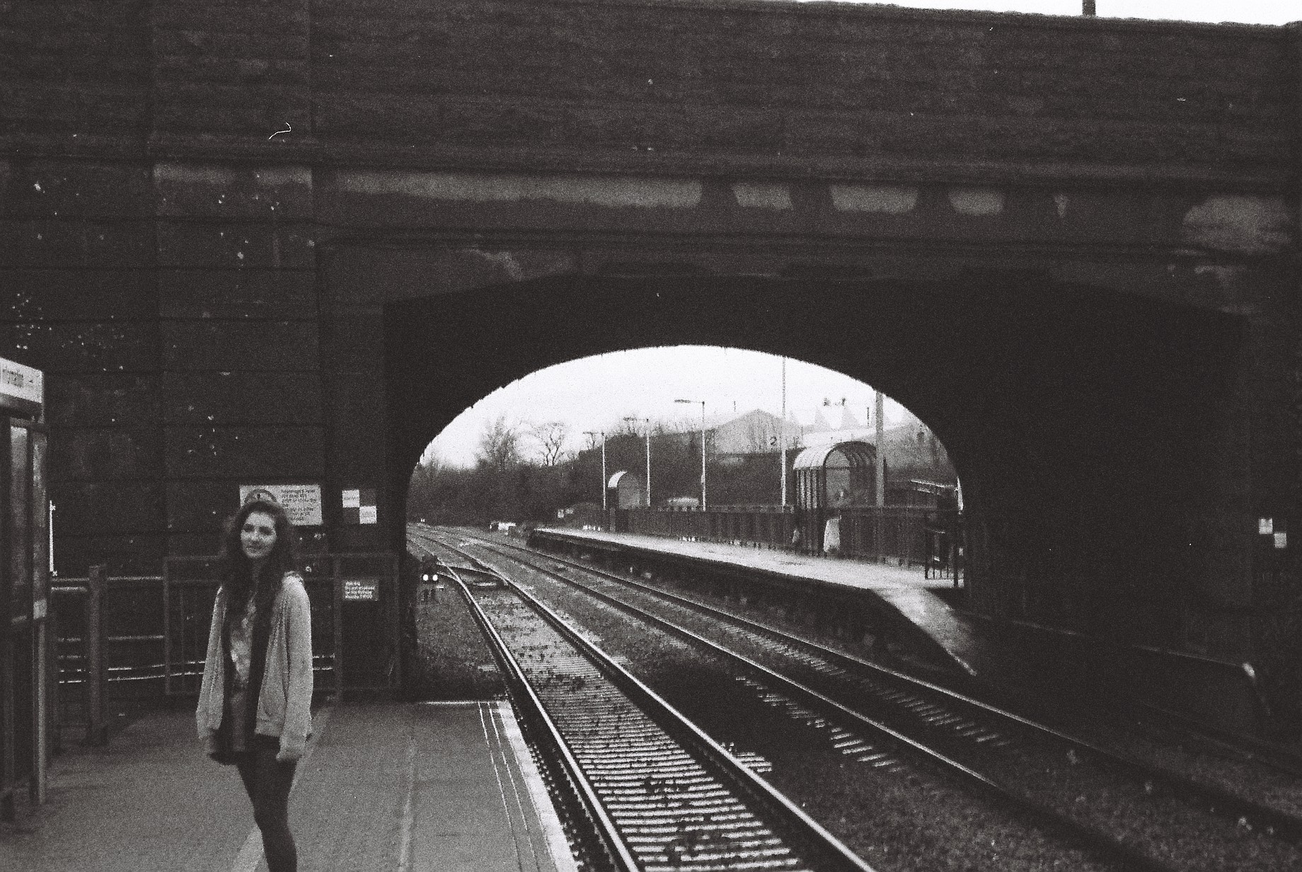

Technical issues aside for a moment, I really like your compositions in frames #2 and #4.

The scans do look pretty rough, but I like the compositions and the exposures seem good; I'd say you're off to a fine start. It's hard to tell if the negatives really are unsharp or if it's just the scans. What lenses are you using?

I would say there is not a lot wrong with the content of your photos, but the development and scanning looks a bit ropey to me.
Unless you have an attachment to 'real' B&W film, you could try out Kodak BW400CN or Ilford XP2 Super, both are black and white films, but process as colour (C41) films. They are both contrasty and high resolution, and as they process as C41, any lab can process them, and the process is fixed, not really open to interpretation, so there is less to go wrong.

In my opinion, they look like very badly scanned. I once had experience of similar coarse and smeared grain when using a very (but I mean VERY, VERY) old bottle of Rodinal, that was even left partly open, so I guess it had gone bad. This is to say that it also makes me think about a nearly exhausted developer. I am an amateur and beginner too, starting black and white photography, so I am saying this based only on my personal experience and not thorough testing. But I really like your photos and wish you to find the culprit and improve your technique.

I agree the actual pictures are fine - just the dirty scans letting you down.

I liked the framing with the arch in #1. #2 and #4 show good composition skills are starting. I would suggest that you use a yellow or orange filter for a few black & white rolls to see how they will change things for you.

LIke a lot of people said, they look like bad scans. The Scanner you described sounds like a minilab-type. My experience with those is that a lot has to do with the the care of its operator. If the person who develops and scans your film takes his/her time and tries to get the best possible negatives and scans (scans will never be super-great), then you will be happy with the results. If he or she is in a hurry because of so many orders, or just doesn't care or doesn't know how to oeprate the machine, then you might get bad results.
If you took a photo of your negatives against a white background (even an iPhone photo), we could probably tell you to a greater or lesser degree whether the problem was the scanning or your exposure.
I've got crap scans from those machines before and come home and taken a look at the negatives and felt relieved because the negatives were just fine.
