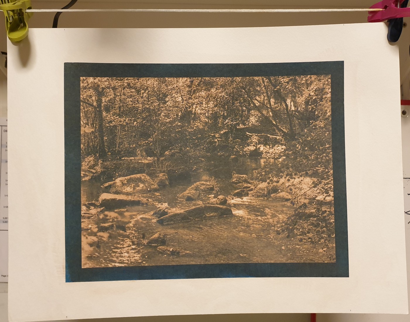

My first ferroblend
La Colmont, Mayenne, France
Sinar F2, Ilford HP5+, print on baryta paper, Epson V800 scanner, digital negative
ferroblend on Hahnemühle Le Rouge watercolor paper
Thanks to Raghu Kuvempunagar for sharing this technique with us
Pretty image! Well done.
Very nice! Also very little staining along the edges; what paper is this specifically?
Thank you, The paper used is 325g/m² watercolor paper, fine grain, Hahnemühle, Le Rouge, reference 16 628 105
As with my cyanotypes, I give them an acid bath before spreading my chemistry.

Ah, thanks; I was confused a bit by the mention of a baryta paper. The Hahnemühle paper looks very nice indeed; very fine texture, looks suitable for the process. The acid bath may also be a factor in keeping the fog low; well done on this print!
yes, I make my digital negative from my baryta print and not from my silver negative, it's easier for me.
