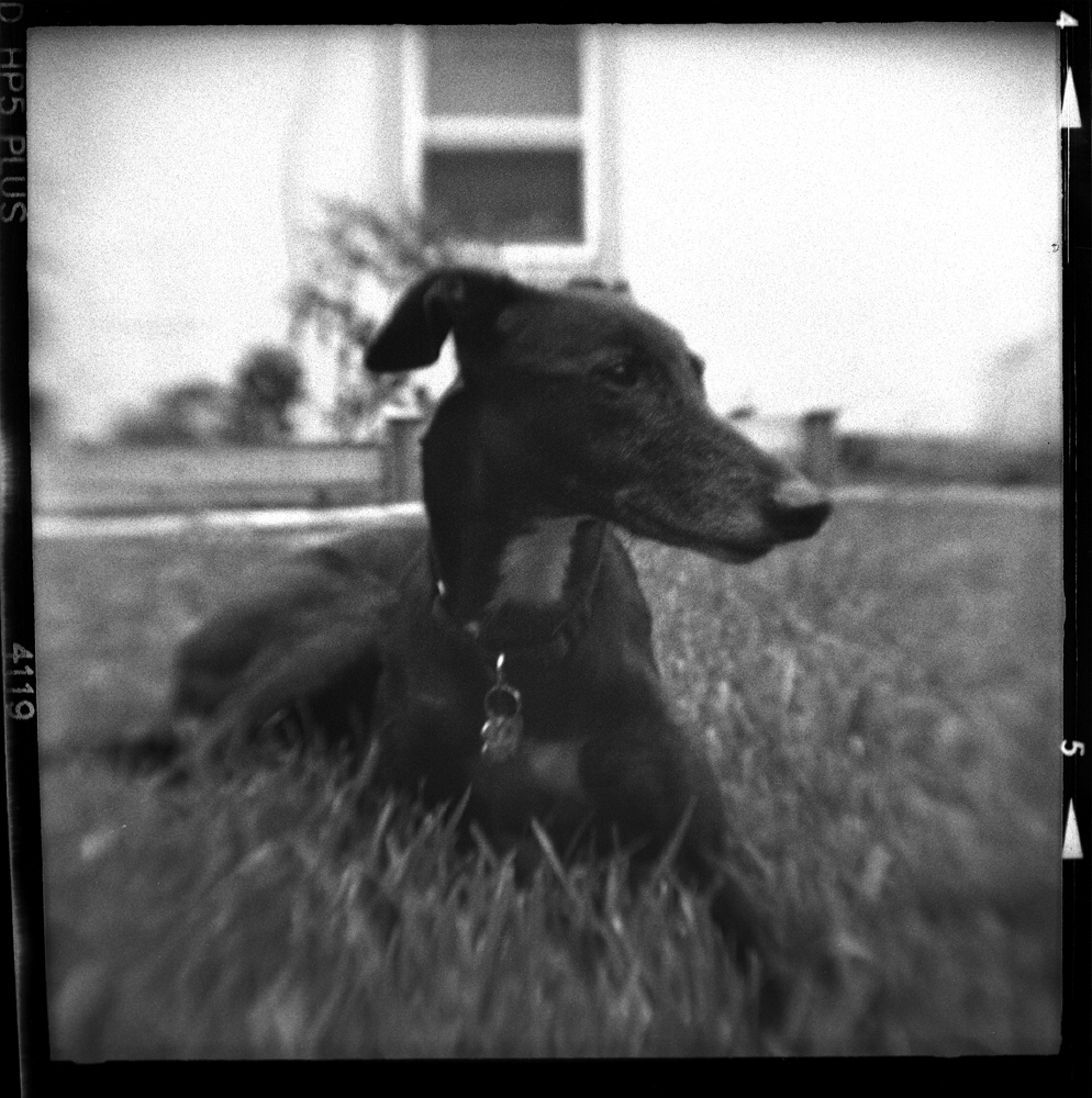

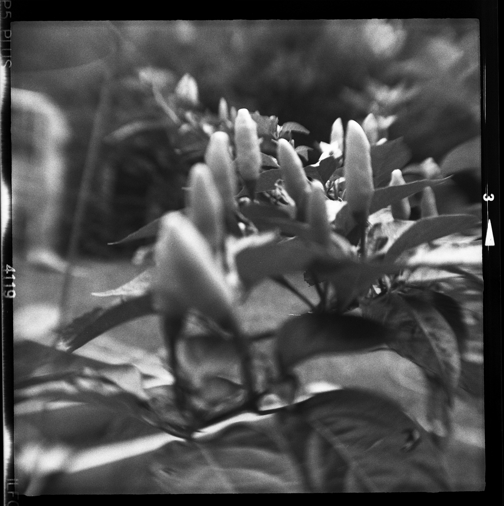

It would appear that this time I have images! Washing for five minutes now.
SUCCESS!!!
That is clearly a photo of my greyhound!
STOKED!
i am very happy it worked :smile:
nice negs too :smile:
Me too!
A reversed and very quickly retouched cell phone pic of the negatives. Can't wait to wet print this over the weekend!!
I do believe..... that I'm going to enjoy this whole "instant-coffee-make your own-developer" thing.

sweet!
nice photographs ( and pooch ) !
easy to print i bet :smile:
hope you dont turn into an addict, caffenol addicts are kind of crazed :eek:

See! Worth persevering for! Beautiful dog BTW...
:smile:
RR
Thanks! She's a retired racer that we adopted from the racetrack. He racing name is DLT Dragonslayer, but we call her Slayer. Sometimes Satan... LOL
