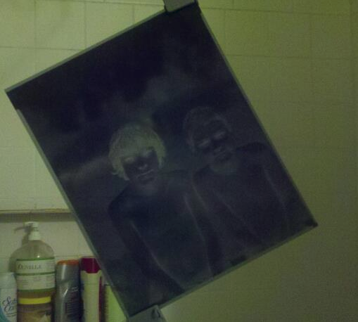

had to share, was so excited. I tray processed - new to that and to 8x10. I don't have the proper clips for drying film this size as I'm use to 120 film but it is there and hanging. sorry for the crappy quick cell shot of it- dark - now I'll have to do a contact print (another first for me) but I don't have any papers yet ack!:blink: I think it looks okay though. the older boy is sharper focus even though it was f8 but using an 8x10 I'm sure it isn't the same as f8 on a med. format. This is the 9 1/2 lens I have.

lol yes I am...since 1999. I have two boys 8 & 10 - they humor me by sitting for me. The neg looks great this a.m. all dry and now in a sleeve until I get some paper ordered here to do a contact print. I have another ready to process today too from yesterday - this one was f8 and the fast speed on my shutter is 1/50 - yikes. Not as much depth of field but the other I'll do today had f16. I was told now on the lg. format forum that f22 will be my sharpest setting for it.I'll keep experimenting and learn. mainecoonmaniac, how did it go in the drum? I found it tricky in the dark doing trays in the bathtub LOL - assume you don't have to be total dark once the film is in the drum?

F/8 will be shallow indeed, heck even f/16 if you didn't employ any camera movements.
What lens do you have Jessica?
jim galli sold me a 9 1/2 lens which is a stretch for this camera - ideal would be a 12" but my max bellows on this is 19" so the one lens I had was more telephoto and I needed something for portraits, hands, etc. closer work. It is a wollensak and is f4.5 - 64 fastest shutter on the betax no.4 is 50. There isn't much movement to be had because of this lens. I'm on the lookout for another in 12" if I can afford it in the future here. I wanted to see what I can do with what I have.

Yes it work in the light. I use a motorbase agitator too. I curl the film emulsion facing inside the drum like color paper. I prewet my neg first. I'm not sure if this is applicable to film, but for color printing, the Beseler drum uses as little as 1.5 oz of chemistry. The chemistry is thrown out after each print. But with 8x10 BW negs, I used replenished Xtol. I use 250ml per 8x10 neg and replenish the Xtol at a rate of 70mls per 80 sq inches of film. It works like a charm. The drums are available on Ebay for cheap. I've also processed (4) 8x10 negs inside a 16x20 drum. Have to be careful because the dividers can scratch the base side of the film.

Jessica... I'd be looking for the correct rail extension if I was you. Otherwise, you'll be stuck with a telephoto with limited coverage, is front-heavy, is of lesser image quality, and is "probably" a bit pricey. That rail extension is a "must" IMHO. :smile:

I've read posts on this forum in the past that extension rails were often hand fitted to cameras back in the day, and that means even if you find a rail the right size and shape it might take some surgery to get it to fit your camera and there's still the possibility the gear racks might not line up quite right. I don't want to discourage you here, you might find something, but it might take a while. Meanwhile, the 9-1/2 inch lens you have now might not be bad at all if you're doing closeups of heads, hands, and feet. If you have to rack the lens out to, say, 15 inches to get your subject in focus, that's still a little more than a 'normal' 12 inch lens at infinity. The perspective problems might not be too bad. A longer lens would be better perspective wise, but the shorter Wally will let you get in close without an extension rail. No harm in trying it.
