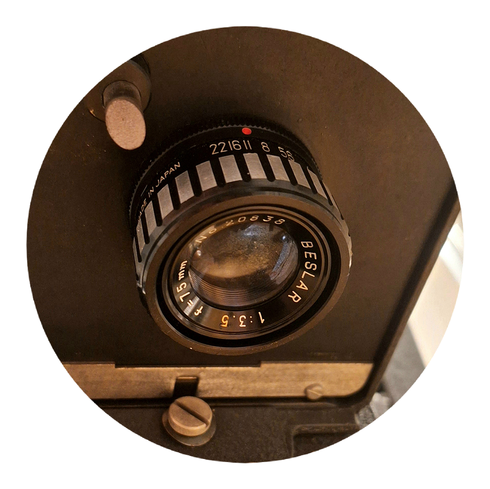

Mine is a Beslar 75mm, as shown thusly.
I don't detect any threads in there, but I guess it could have some.
Should be a 39mm lens retaining ring holding the lens on the lensboard. Matt is correct about the dimmer. Beseler had a Resistrol gimmick back in the day, a rheostat to dim the bulb. Presumably it worked for graded paper.

The 3-element Beslar enlarging lenses have no threads at the front of the barrel for filter attachment.
I assume that you are using the 23C enlarger in its standard lamp & condenser configuration. If so, then using a lamp dimmer is a cheap and practical solution to controlling the illumination and, therefore, the exposure time.
Here’s one rated for 75W to 300w. Depending on when your 23C was made, the lamp is either the bayonet base PH-111 or the screw-in-base PH-140. Both are 75 watts, so this dimmer will work with your enlarger.
It is not correct for a dichroic filtered color head that needs the standard 120-volt U.S./Canada current in order to work properly.

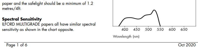

From the datasheet for the current RC papers:
and:
Exposing light sources
MULTIGRADE RC papers are designed for use with most enlargers and printers, that is, those fitted with either a tungsten or tungsten-halogen light source. It is also suitable for use with cold cathode (cold light) light sources and LED exposing heads designed for variable contrast papers. Other cold cathode (cold light) and pulsed xenon light sources may give a reduced contrast range.
The three emulsion components that together control the resulting contrast have different sensitivities, so they would most probably be functional with a variety of colour temperatures.

I have seen the spectral sensitivity chart. I do not know how to correlate the numbers there expressed as wavelengths in nanometers to color temperature expressed in degrees Kelvin, so I cannot deduce how a change in color temperature might affect (if at all) contrast on the variable contrast papers.
Likewise, the information on light sources provides no information about how the color temperature of the light source may (or may not) affect contrast on variable contrast papers, or for what color temperature the paper is calibrated.
If the OP is being counseled not to use a dimmer on his enlarger bulb because it will change the color temperature of the light, it would be helpful if he could be shown the impact of a change in color temperature on contrast.
Let's say he is using a 120V PH111A bulb which has a color temperature of 2900K. To extend exposure time he drops the voltage to 110V using a dimmer. What is the resulting color temperature? What is the effect of the resulting different color temperature on contrast? Does a #2 filter now act like a #1 filter, or something else? The same questions arise with the use of a 120V PH213 bulb which has a color temperature of 3400K. Will a 2900K bulb print the same contrast as a 3400K bulb? If not, are there conversion charts? I have seen a contrast filter conversion chart for my Aristo cold light head.
