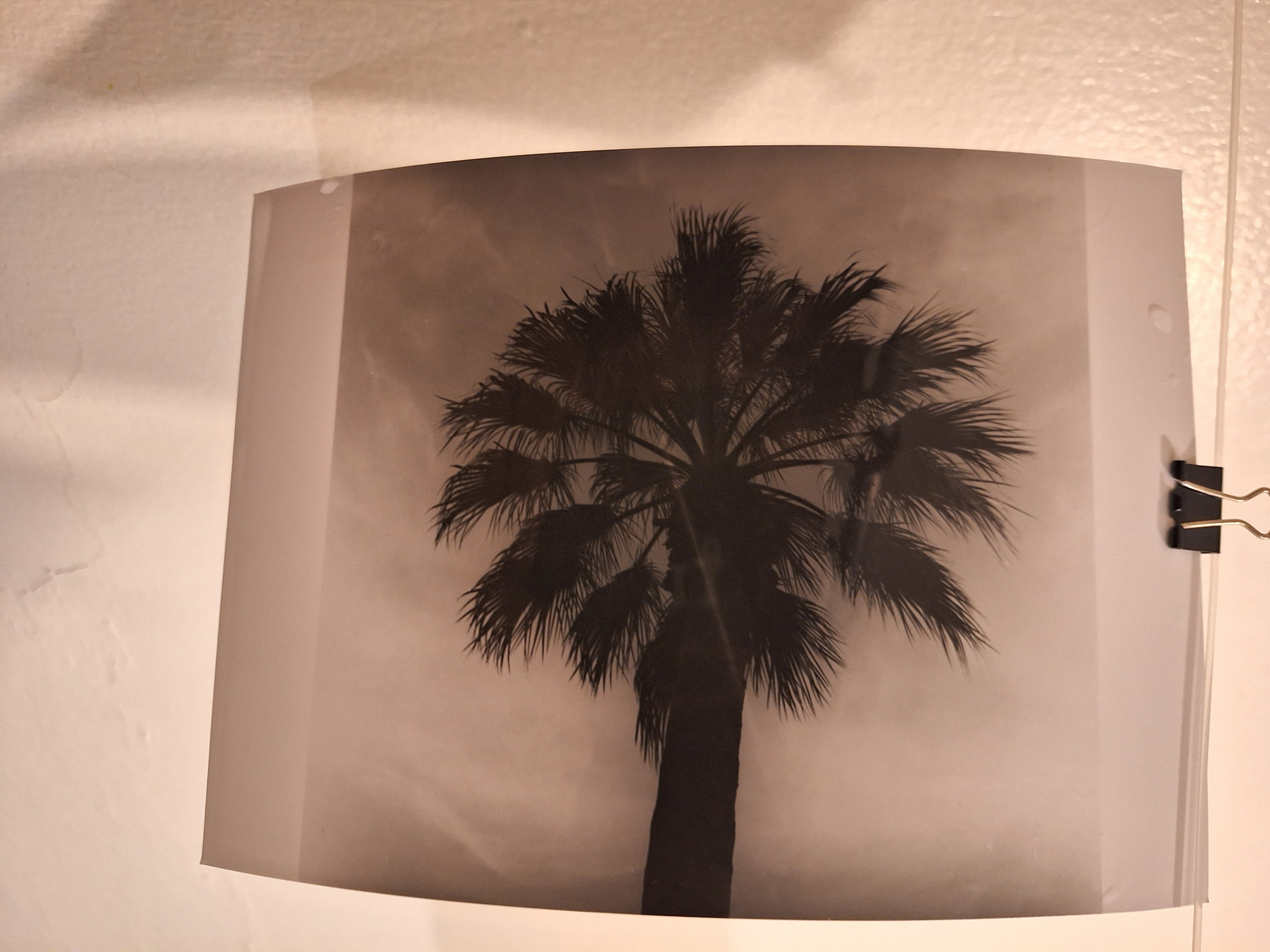

I've been away from analog photo stuff for a while, but recently came back and have been making some prints. I read on forums what typical exposure times are for enlargers, and seeing numbers like 20 seconds, but this is not how it has been for me. My exposure times are rarely more than 6 seconds with what I consider to be very straightforward prints.
Below is a pretty standard print. The negative has good contrast. The aperture on the enlarger is set at f11, and the lens is 10" above the board. The contrast filter is a #3. This is a 5x7" print, and the exposure time is 3 seconds.
I develop all of my prints in Dektol for 1:40.
I'm having to stop down to very low apertures, which causes diffraction issues in my prints.
I don't remember having this problem before. I'm considering seeing if I can get a lower wattage bulb, because the exposures are so dang fast. Other than that, besides reducing development time, I can't see how I can increase the exposure times to long enough where I can do things like dodging and burning.
There's another issue in this photo you can comment on if you know the cause: You can see a faint, light line going through the middle of the tree that is not in the negative. I've seen this on other prints I've made too, but not all of them. To expose the print I slide the lower filter out, which holds a red safety filter. I'm wondering if that's related.
Thanks in advance!

Welcome to Photrio, @Rob H !
Don't attribute too much weight to the exposure times other people have mentioned online. They might be longer than what you're getting for a variety of reasons. One major reason is the difference between papers, with some (most) warm tone papers in my experience being considerably slower than neutral tone papers. For instance, the difference between Fomabrom (neutral) and Fomatone (warm) is in my experience some 2-3 stops.
That's just one factor; there are several that will influence exposure times.
The 6 seconds at f/11 for a 5x7" print sounds very reasonable to me. If you find that inconvenient, consider using an ND filter or, as you mentioned, see if you can get a weaker bulb. An ND filter gives you more flexibility, though.
Yes, I can see it. There's a couple more conspicuous shorter diagonal lines of an apparently similar nature in the right set of fronds on the tree. I'd start by inspecting the optical path to exclude the possibility you've got anything in there...cobwebs or cat hairs come to mind! It's a bit of a wild guess though; several possible causes might play a role here and I'm sure some other people will also chime in on this.
In any case, welcome aboard and I'm sure there will be some useful responses to your questions :smile:

Thanks Koraks,
The line that extends from the main line in the tree is not in the negative either. The other lines appear to be just in the clouds.
I almost wonder if I have some little reflective bit in the filter slide (below negative) that somehow does something... it's weird. I saw it once before on a previous negative, but it disappeared, only to reappear here.

It would create a dark band, not a light one :smile: When paper fogs, it builds density, so stray light will result in higher densities instead of lower ones.
You either have something blocking the light path, an anomaly in the paper or processing (unlikely with this pattern) or an anomaly in the negative that you've simply overlooked (yet).
If it's the exact same shape in the same spot, but on a different negative, it's nearly certainly enlarger-related. Again, look for fouling.

Ah yes, sorry. It's a Beseler 23c.
There were quite a few versions of that, a picture is worth a thousand words!
Most importantly, is this a condenser or diffusion light source on top?
If condenser, the white line in the photograph may be on the dome of the lamp and the light output can be diminished with ND filter set on the top condenser, and/ or a lower wattage lamp.
If diffusion, the white line may be on the diffusion plastic and the light output could be diminished with the color head settings, equal Y and M.

Regarding the odd lines on the print, on a Bessler 23C with the condenser and opal photo lamp, you should check that the interior of the lamp chamber is clean. It should be solid white. Sometimes old lamp heads get fouled inside by spider webs or fungus. Likewise, check that the condensers are clean as well. They’re fairly easy to remove and clean. Also, check the filter slots. If you have a heat-absorbing or other filter installed, it might have become contaminated.
It will be useful to state specifically whether the enlarger is equipped with the simple condenser and lamp head or with a dichroic color head. If the dichroic head is in use, is it used with the condenser unit, or do you have the diffusion unit installed instead?
Are you using a glass negative carrier? If so, examine it carefully for scratches or other marks on the glass. Since the glass is so close to the negative, any marks or scratches will get projected noticeably onto the image.

Looking at the print. Appears that the paper is slightly fogged. Comparing the print border to the white wall. Maybe check safelights and paper.

How thin is your negative? It looks like it could be underexposed based on the relatively low details visible in the tree. That will make your exposures short.
It looks like you have several lines on the print, but the lighting is so uneven it's hard to tell. Try making a contact print with the same grade 3 filter and see if they still show up to rule out any issues with the enlarger.
1:40 is short for fiber development times. That could lead to uneven development if you are using fiber paper.
