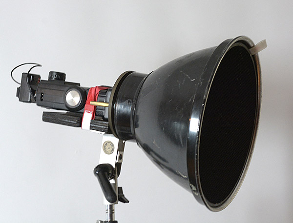

Basically I tore up an old beater speedo head, saved the front panel, cut a big hole in it, and mounted it to plywood, along with the stand adapter. Vivtar 285 and a radio trigger. Hot-glued a little tupperwear container with a dash of white spray paint to spread the flash into the reflector, emulating the bare tube that would be in the reflector.

I want another one of these but don't want to trash another head - anyone seen a speedo adapter like this? The don't sell the just reflector mounting hardware.
