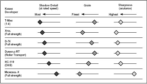

D76 isn't the best developer for fine grain and sharpness with Tmax films, it might be the de facto standard but in practice Xtol is a better developer in my experience, which happens to mirror Kodak's recommendations as well - see attached.
Ian
Ian
I'd like to see diluted D76 and see how that compares. Of course, this graph contradicts the whole idea that one developer can be better for one film but another developer be better for another film.
