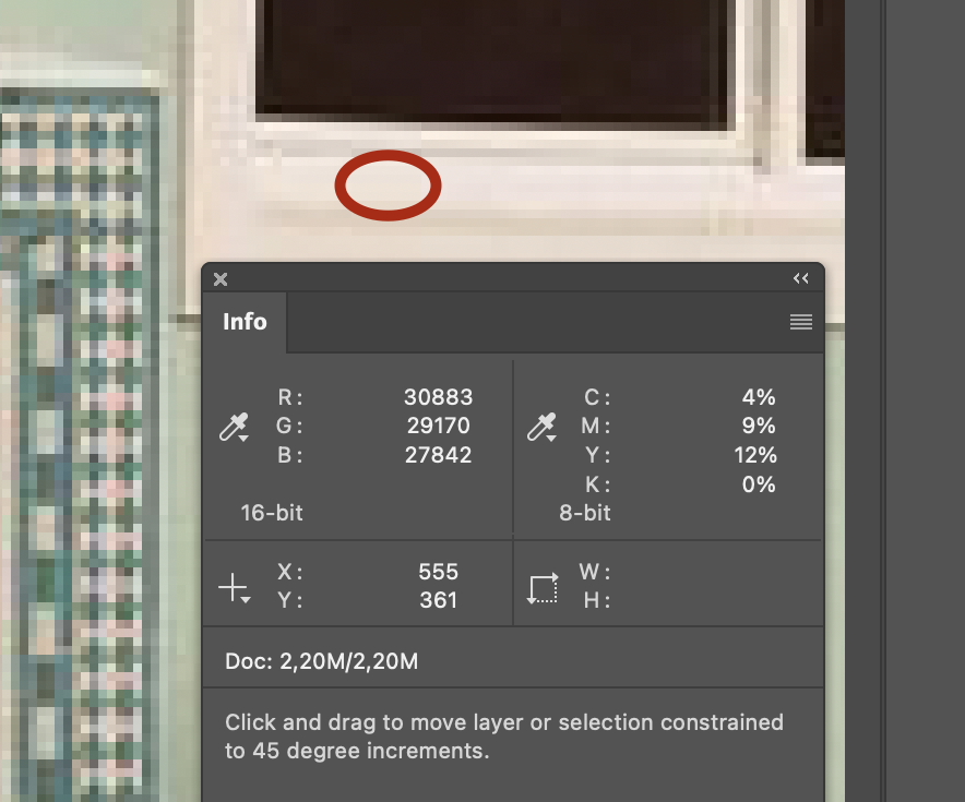

Same here, although the cyan highlights are more obvious.
Is my Photoshop broken?

The scans look kind of color-wonky to me with significant crossover and an overall bias towards yellow, but this is similar to what I see in a lot Portra scans online and what people appear to experience as "normal" for Portra. There's in particular a significant red/cyan crossover, but the other channels have gone off into the woods as well. Some of this may be due to the film being expired, but some of it is likely due to the auto-color balancing that was done in the scanning process. It's impossible to determine which factor accounts for which part of the deviation.
There's indeed also an overall red (and yellow) bias, but the red bias is stronger in the shadows. Hence, the highlights are red and yellow relative to the shadows. If you do a sample of the shadows just like you did for that brightly lit windowsill, you'll see what I mean. The red bias is relatively speaking far more pronounced there - thus, red crosses over. Blue does it, too, but less so.
Yes, in absolute terms there is about the same difference in channels of what should be neutral tones in shadows and highlights and that make them relatively higher in shadows. Which might indicate a problem with film (although for a 20 years out of date Kodak film this is pretty good!) or mildly inadequate or "opinionated" scanning.
But, since two people commented on obvious cyan highlights, I had to check. There are no cyan highlights. I'm not blind yet :smile:
I also hoped @Wolfram Malukker would share which Portra film is this. If it's Portra NC it's still in very good shape, less so if it's VC. I have only one Portra 160NC RA-4 prints scanned, but this one gives the same kind of mood if Wolfram's photos with couple of clicks of C (minilab scanners work differently that PS, they have the tendency to hold the highlights around neutral and change midtones relatively more).
Which itself could be due to differences in monitors, monitor calibration, ambient light conditions when viewing, etc.
Not to mention the role that the Photrio uploader performs.
Due to those differences, if the highlights look more cyan to us then they do to you, most likely the shadows look less red to us then the do to you.
But as the discussion is about crossover, it is the differences between the highlights and shadows that matters.
The sky in the first one is pronouncedly cyan:
However, this is mostly due to the yellow/blue crossover, not so much the red crossover.
The results are fairly good regardless, given that the film is >20 years old. I've seen Superia hold up similarly well, although it does get pretty dense to print/scan though.
