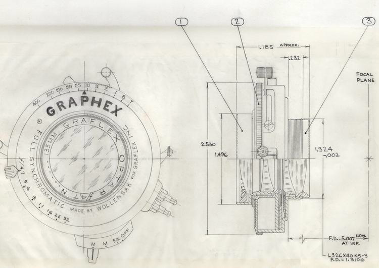

Does anyone know that hole size needed for this Graflex 135mm F4/7 Optar lens to be mounted to a lensboard?
BrianShaw
Nov 30, 2005
16,523
La-la-land
https://www.largeformatphotography.info/forum/attachment.php?attachmentid=251229&d=1720326851
