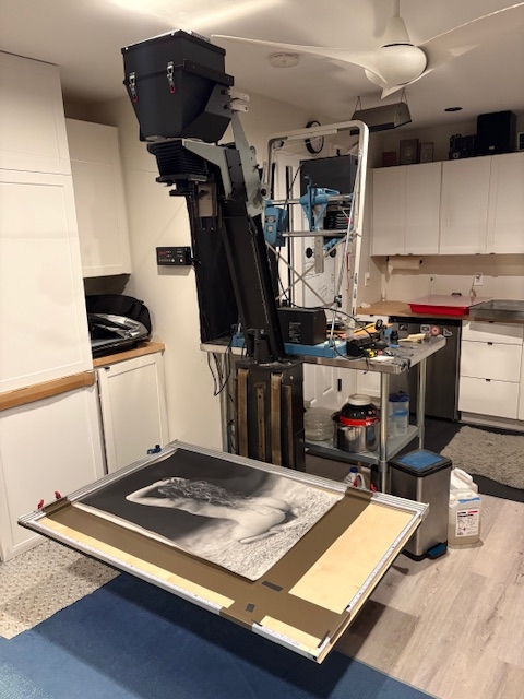

Are any of you making big prints? Like 40x30” or more? If so what equipment are you using to do it with? I have been lately. I started with a sheet of plywood with a layer of sheet metal glued to it, and strip magnets to hold the paper down. I found that to be really tricky to deal with so I built myself a two bladed easel capable 30”x 48” exposed area. I’m curious what others are doing. My enlarger is a D5 that I converted to 8x10 with klaus lundsgaard’s conversion kit. My stand is basically a old super heavy duty commercial model with a table that drops all the way to the floor…

I’m using a 240mm Rodagon G for 8x10, and a 135mm Companon S for 4x5. Even at 30”x40” the results with the Componon are good but my style of photography allows for that. I’m Rolling the prints in 24x30 trays. Not sure what others do but I make two rolls with the print then twist back and forth keeping as much paper flat in the tray as the space will allow. Then I tone out side using a pool to wash made from a sheet of plastic and 4x4’s or a border. I learned the hard way you can’t roll a print in bleach, atleast not a mat sheet of Ilford lV. It won’t tolerate the friction involved in the rolling. I ended up finding a use tray for the purpose, it’s about 36x58. It was made for some industrial purpose and was relatively inexpensive.

For murals, I do horizontal exposures. My Beseler 45MX flips easily to horizontal and I have an 8'x5' easel (foam-core in a wooden frame) hanging from hooks on the ceiling. I use masking tape on the edges to keep the paper in place. Processing is in four, 5-foot long, half-tubes -- created from 12" PVC pipes. I use a 50mm Rodagon G for 35mm, and a 150mm G-Componon for 4x5.
Since your enlarger does not have horizontal printing, you can attach a 45° front surface mirror to the lens, such as a Spiratone Mirrotach -- very inexpensive.

Interesting, I also have the Beseler 45mx back to back with my D5. The reason I opted to go the floor route is the trouble of moving things around to set up the Beseler horizontal. That mirror idea is a good one…

Whether flipping the enlarger or using a mirror, you have to have enough space between the enlarger and easel to make the size print that you want. You're lucky, you have a high ceiling. Going horizontal was my only option.

30X40 inch is hardly mural size. And if you're enlarging 8x10 film, or even 4x5, the degree of magnification does not call for any kind of special enlarging lens like a Rodagon G. I have a variety of enlarging lenses, including the 240/9 and 305/9 Apo Nikkor process lenses for 8x10, which are better corrected than any kind of official enlarging lens. For 4x5, I mostly use a 180 Rodagon and 150 Apo Rodagon N.
There was a time when I used a horizontal enlarger for 30X40 prints, along with a vacuum easel on the wall. Now I use a couple of tall vertical 8X10 enlargers instead, in a room with a high ceiling.
