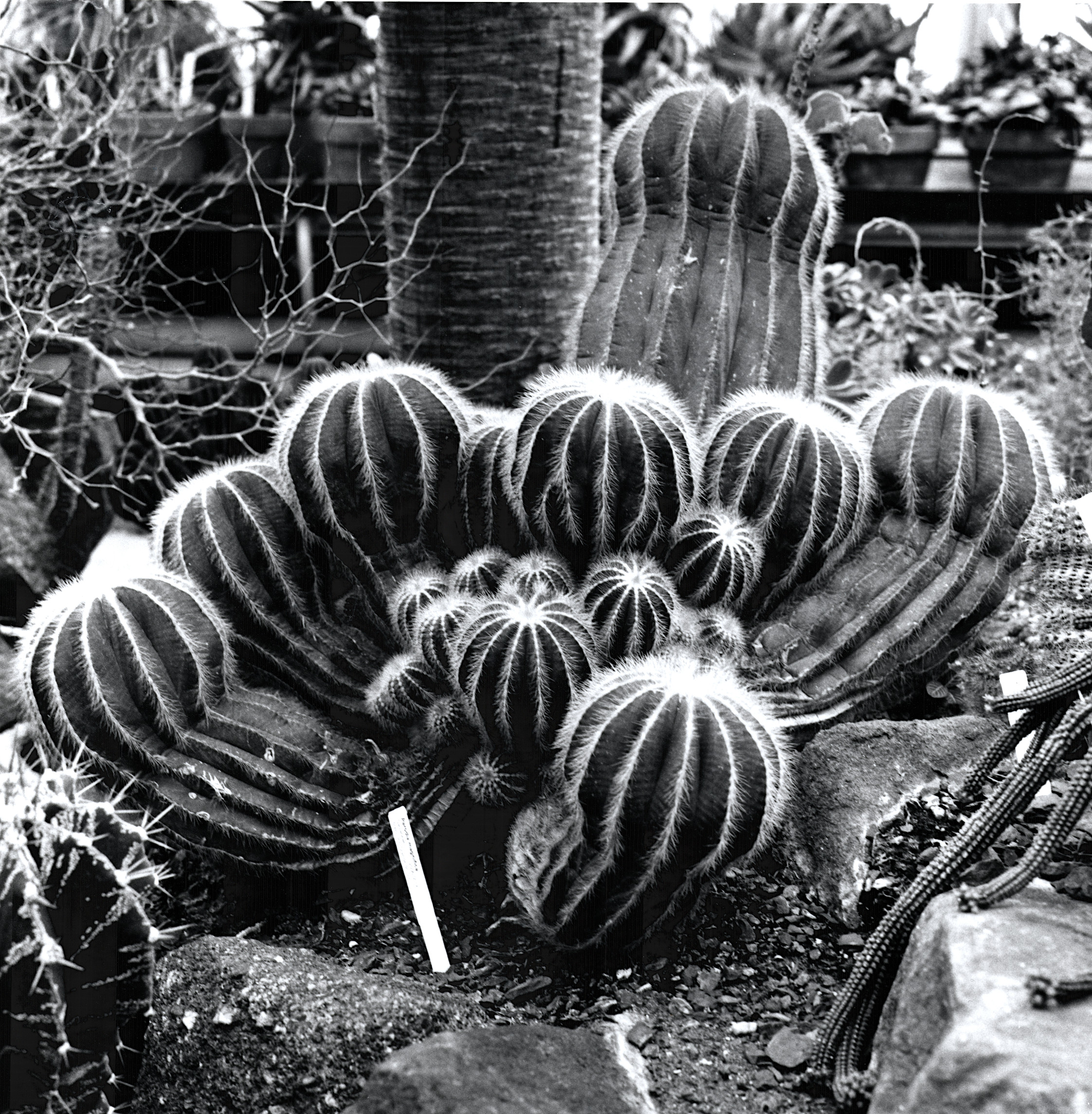

Smith College Greenhouse - 01/25/2024
Hasselblad 501C and 80mm lens with the A12 film back that I put new light trap seals in :smile:
Kentmere 120, 400 ISO developed in D23 1:1 for 14 minutes at 68F/20C
Multitone RC, pearl - exposure 4 seconds at f/16 with burned edges; quickly for slightly less than a second at the upper parts of the image.
No contrast filter; assuming a grade 2 or 2.5 default???
Liquidol 1:9 for 2 minutes at 68F/20C, 30 seconds in Sprint yummy vanilla stop bath and TF-5 stinky ammonia fixer

This paper is a pain to work with. This paper has a punchlines that I haven't been able to tame all that good. Even with a mildly flat to normally processed negative this is the punchiness result that I get with this paper. I have negatives that print fine on the Ilford materials but not on this stuff.

Once the paper hits the tray it takes about a second or two and the image very quickly appears and looks like it completes in a few more seconds. Seems way too fast
Sounds like your paper developer is on the active side. This doesn't hurt in principle. It just means you can get away with a shorter development time. Rejoyce; saves you some time. I often mix my paper developer rather strong because of this! Besides, RC paper tends to develop out pretty fast to begin with, so it's not all that outlandish.
I looked above and saw that it was mentioned that there could be the possibility of more incorporated developer included in the emulsion
No doubt. Doesn't matter.
If you want to test this, take some water and dissolve half a teaspoon of sodium carbonate in it (cleaning soda is OK). Then take a piece of exposed but unprocessed paper and put it in the water. Agitate. If it develops some tone, you know there's a developer incorporated in the paper. Again, it doesn't matter if there is from a practical viewpoint, unless you're trying to do lith prints or something. So it's a moot point.
The advice remains the same - too much contrast, reduce the paper grade. Still too much contrast on grade 1, revise negative development.

For starters, it sounds like your developer is either 1) too strong at the dilution you're using (dilute it more) or 2) it's not a good match for this paper (try a different developer). Yes, the paper almost certainly incorporates a developer agent in the emulsion (many RC papers do), but regardless - if the image appears fully developed in mere seconds, something's not right. You shouldn't need to pull a print from the developer in less than 45 seconds.
Secondly, if you are getting 4 second exposures for correct print density, then you need to adjust the light intensity. I don't like working with exposure times less than 20 seconds - it gives you no time to manipulate the print, and if you need 3.5 seconds (or 4.5 seconds) instead of 4, you're going to have difficulty getting consistent results. The longer the exposure, the easier it is to engage in manipulating what happens during the exposure.
Close the aperture down as far as you can. If the smallest aperture is f22 and you still get exposure times shorter than 15 seconds, then add an ND filter above or below the lens.
And if you're having difficulty taming the paper's contrast, well - that may not be entirely within your control. I mean, this paper is cheap for a reason. You can't expect it to match the performance of an equivalent Ilford product. You may do yourself a favor and avoid using the cheapest materials you can find. Ultimately, that's only going to lead to inferior results. I don;t really want to be "that guy" who recommends buying the best materials you can find, but I gotta say - if I bought cheap/discount Chinese RC paper, I wouldn't be the least surprised if it was difficult to work with and gave poor prints, no matter how it was exposed/developed.

This paper will probably look the same no matter what developer you use. However, if you want lower contrast, phenidone is a developing agent to avoid. Make D72 with increased potassium bromide and possibly decrease the hydroquinone a gram or so. The restrainer is what may soften the final print a bit. But pretty much every rc paper is almost impossible to significantly alter, in terms of how it looks when developed fully. And it's a bad idea to pull a print.
I'd suggest ensuring that you are fully developing the print and see if you're actually giving too much exposure.

I develop for 2 minutes in Liquidol. I'm at f/22 with some ND and things are still hot. Few have said that they haven't experienced any control or quality issues. Could be that this paper works better under certain specific conditions. I am envisioning a murky or muddy mess with the added punch still being there with my idea of using a softer print developer. I agree that the paper will more than likely come off as looking the same as it does.
