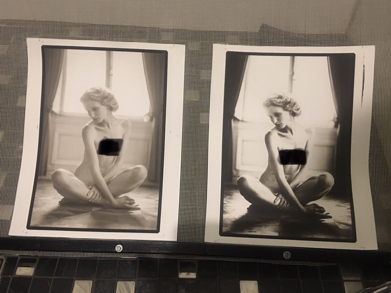

    here is my latest print which im VERY happy with its nearly perfect :smile: the right one has way to much contrast for this i made a special linearsiation with an palladium toned 121 step target i use the profiling system from Dead Link Removed its an excel sheet that you feed with measurements from step charts and it outputs the quad file for quadtonerip Dead Link Removed i have then printed the inverted digital file from the A7R on fixxons foil with ink from cape fear press for the epson 1500w you have to see the left print in person its amazing :smile:)) i tonted it with palladium recipe from sandy king . developer was only sodium citritate fixer i also used from sandy king :smile: his formulas work perfect for me :smile: the negativ was exposed with an 575w hmi spot for around 8 minute i build a "dosimeter" which counts the uv and a smal relais stops after 78000 units :smile:

    That looks similar to Clerc's thiourea toner except this one has no sodium chloride.
