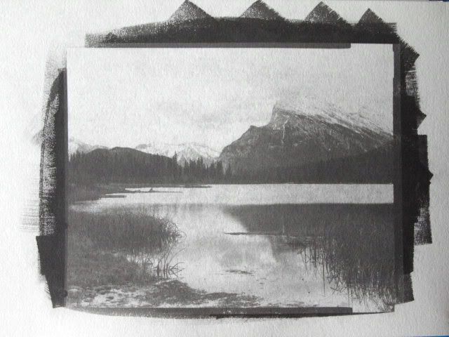

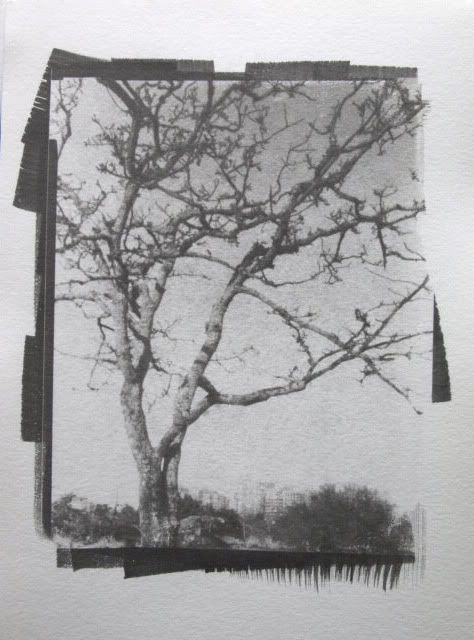

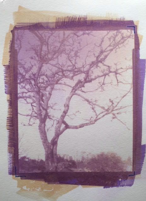

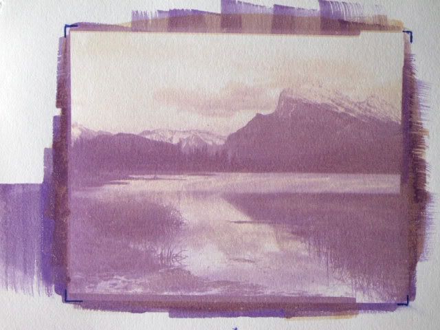

Here you go. I just photographed these digitally, with uneven window lighting alas, and adjusted as best I could to match the prints.
Single layer:
Two layer:
Thanks for the help so far. I plan to work on this quite a bit more, I really like this technique.
