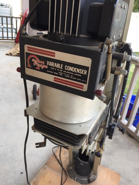

Do you have the variable condenser head or a single condenser head? I have a D3 with variable condense head, I insert 6 X 6 filters above or below the top condenser depending on the position of the condenser. Putting the filter on top of the negative should work as well.

Seems like you have the condensers one for 4X5 the other for MF and 35mm, the viable condenser head looks like this. The front is hinged and opens up so that the top condenser can be moved depending on which lens is being used.
