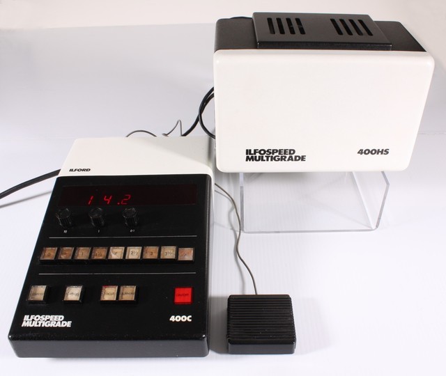

I use an Ilford Multigrade 400 head which, like the very early Multigrade 500 heads, used magenta and yellow dichroic filters. It is quite a bit easier to use when composing or focusing than my friends' blue and green light Ilford 500 heads, but it doesn't give quite as wide a contrast range as those later heads.

Does this mean that blue and green give greater than 6 grades (00-5) or is it simply that Y and M heads give less than 6 grades so that blue green gives the same as MG filters but both MG filters and blue green give more than a Y and M muitigrade head
It means that my relatively ancient 400 series head doesn't offer quite as wide a contrast range - particularly at the high contrast end - as the later 500 and 600 series heads.
Of course, I can easily add a below the lens #5 filter for the very few times when I need to attenuate even more green light than I can accomplish through the 400 head alone.
The upside of the 400 series head is that it doesn't need the cooling fan that the 500 and 600 series heads need.
And the 400 series control panel and head together are definitely more mid century modern in styling :wink::whistling:.
