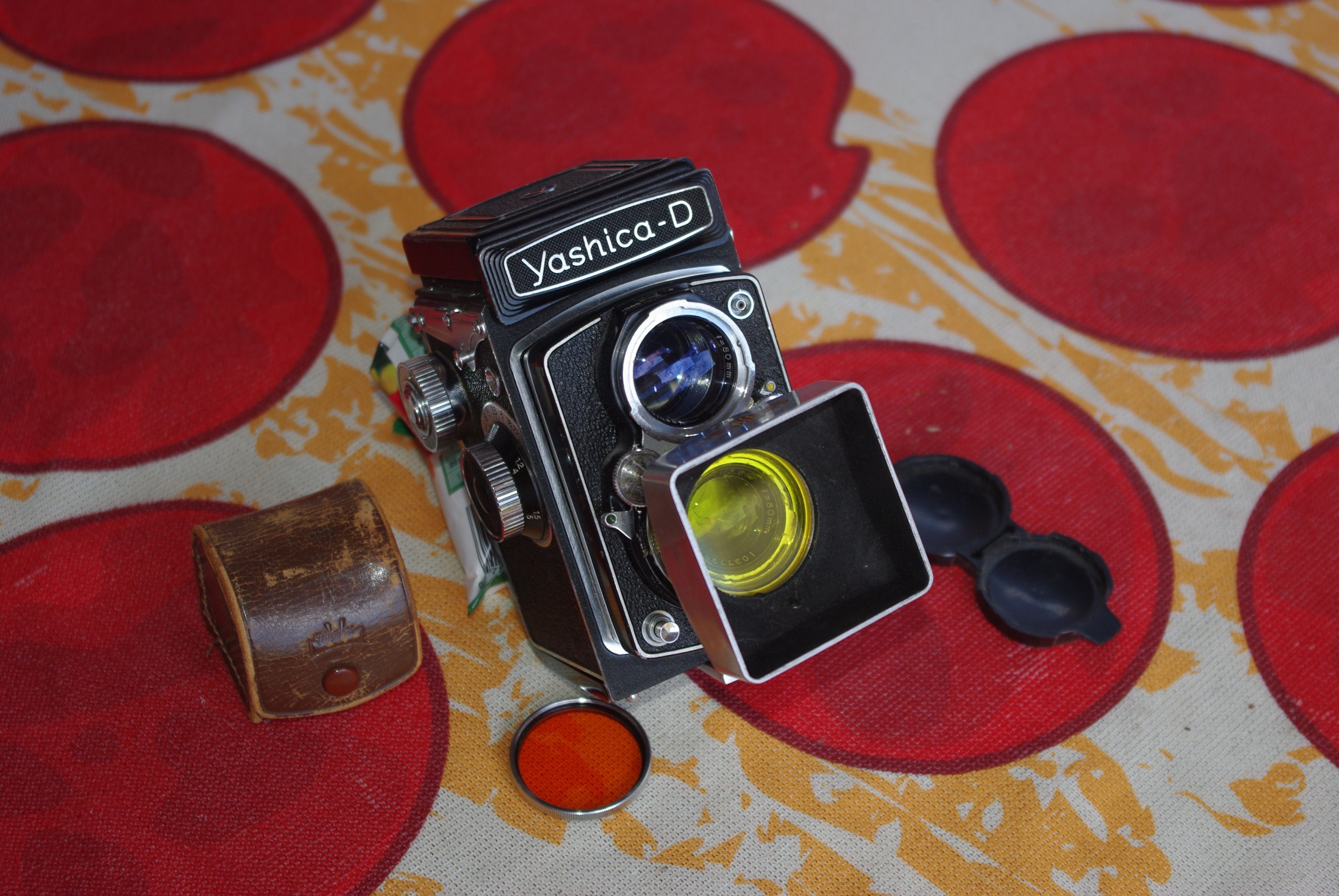

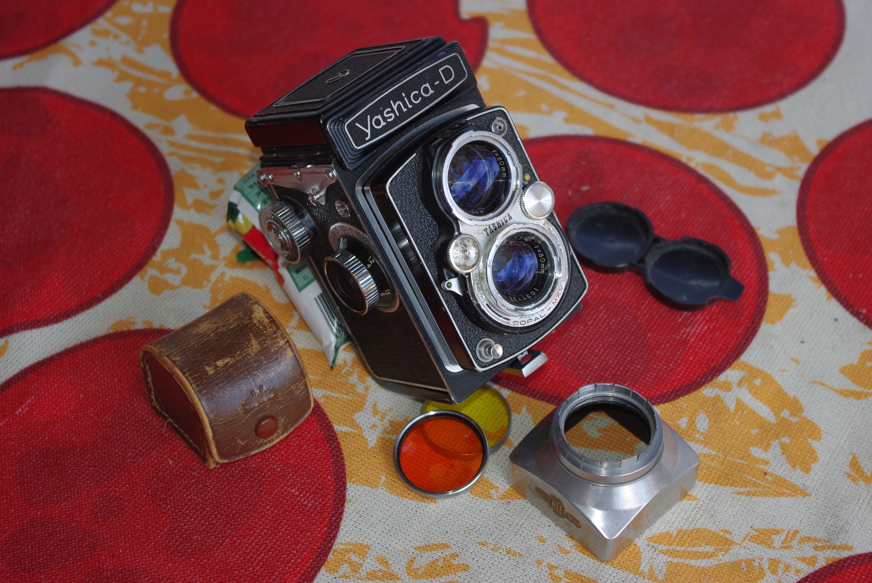

Are modern multicoated bay-1 filters available?
I don't use bay one, I use series VI slip on adapter that will take the lens hood and one filter. My filters are dated, some are Kodak dating from the 50s or 60s, others are newer from the 80s or so, these may be multicoated. I don't know if anyone still makes filters in series sizes.
