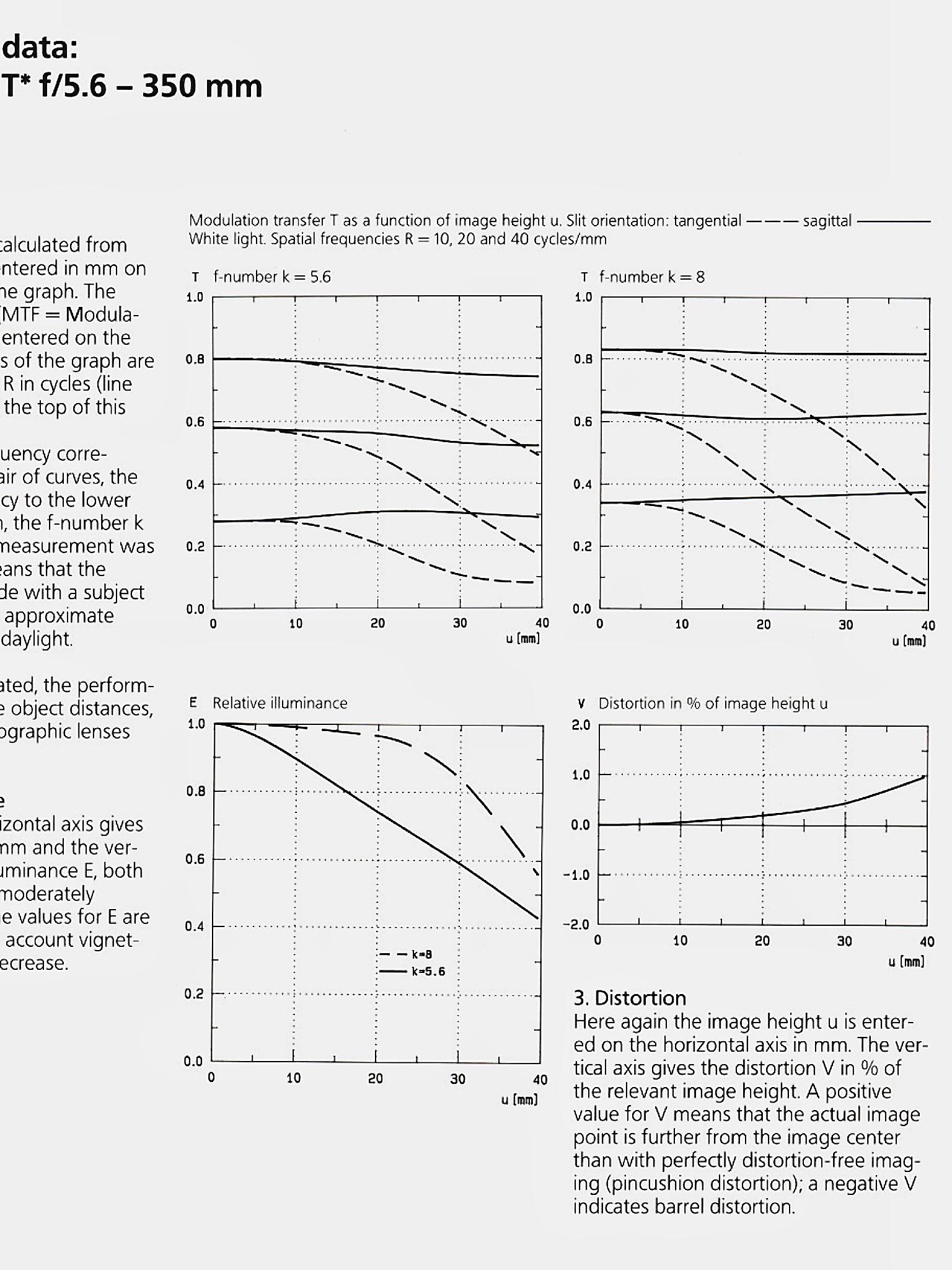

Found this, it gives some idea, but not for the extreme FL of the lens(140mm & 280mm).
The following MTF is for the Variogon of Rolleiflex(I think the same design as for Hasselblad) and at 210mm Only.
Please correct me if it is not the same design.
Obtained from:
http://rolleiflexpages.com/lenscharts.html
http://rolleiflexpages.com/index.html
Thanks Pascal for the great work.
The lens looks better than the Tele-Tessar CF 350mm, but not confident!
Wish I have the MTF of Variogon at 280mm for a better comparison with Tele-Tessar 350mm.
I believe, Schneider is choosing the sweetest spot of Focal Length(210mm), for Variogon MTF, though mathematically, it's at the mid-point between 140mm and 280mm.
BTW, asking to compare prices, not to judge every Tele-Tessar/Variogon lens.
Will comeback again if I or someone found more useful info.
Thanks again.
For reference, MTF of Hasselblad Tele-Tessar CF 350mm.

Sonar 250 and Tele-Tessar 350 are not among the best performers.
This is the reason why MTF of Variogon at 280mm is very Important to read.
Hasselblad wouldn't have put their name on the lens if they didn't feel the lens was up to their standards at the time.
Specially with lens making, very wide spectrum of lens focal lengths, and like other manufacturer, even Leica, standards are wide enough to notice gaps in performance.
If we considered Planar 100mm and SWC at the top of performance, Sonar 250 and Tele-tessar 350 should be at the bottom of the acceptable standard zone.
MTF of Tele-tessar 350mm is attached in post number 8 above. It's clear to me at least, it will not produce as good images as usually expected from Zeiss without some sort of filteration.

As far as I know, Zeiss MTF is well correlated to the actual performance on film/print. Just a correct interpretation of actual MTF(not the calculated MTF) from reliable maker. It needs also a reference, a previous owned lens with its performance on print known, and MTF from the same maker.
