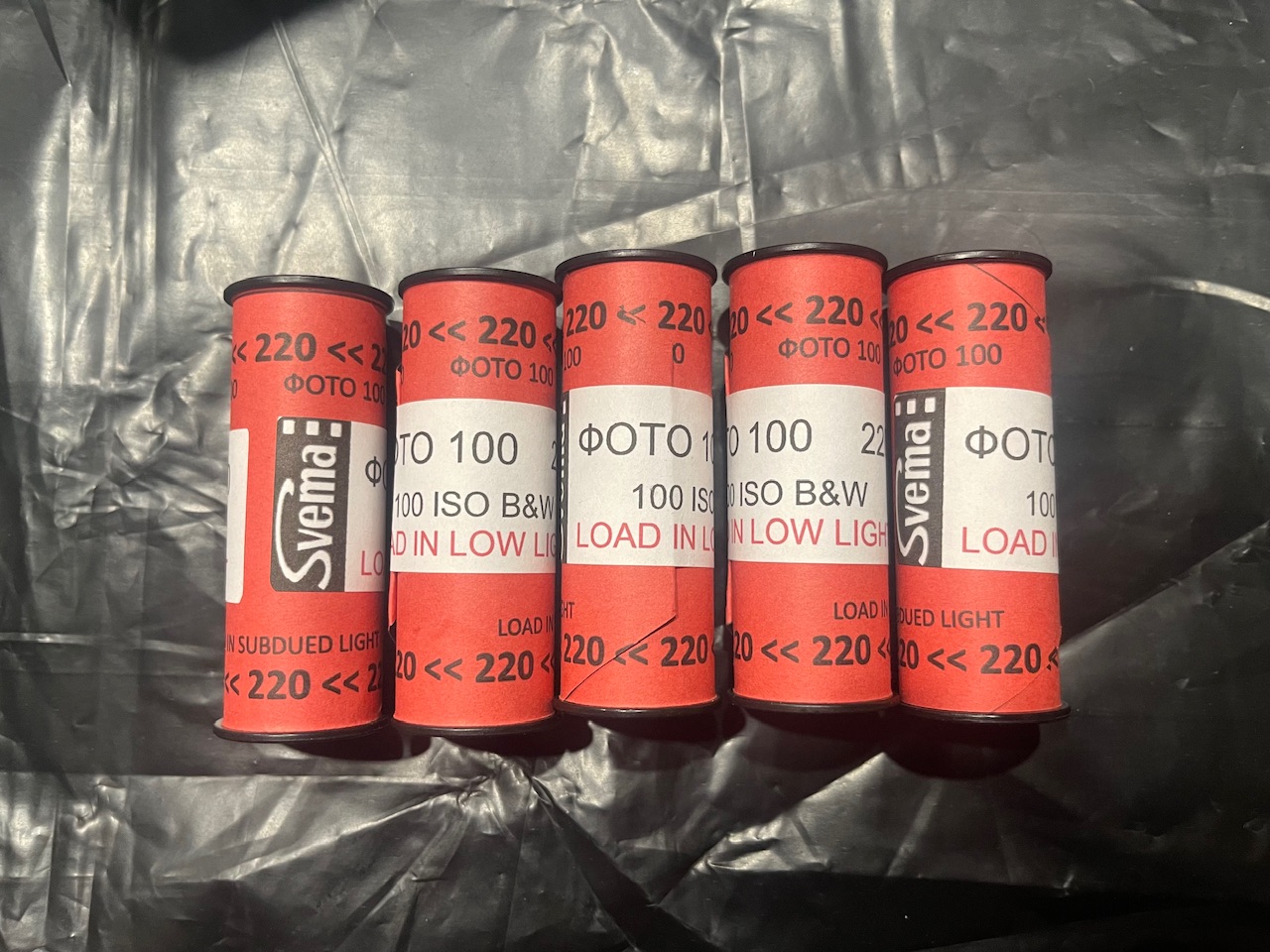

I have cut my own 220 backing paper from big rolls of Soviet red paper from Astrum, but that is very time consuming.
