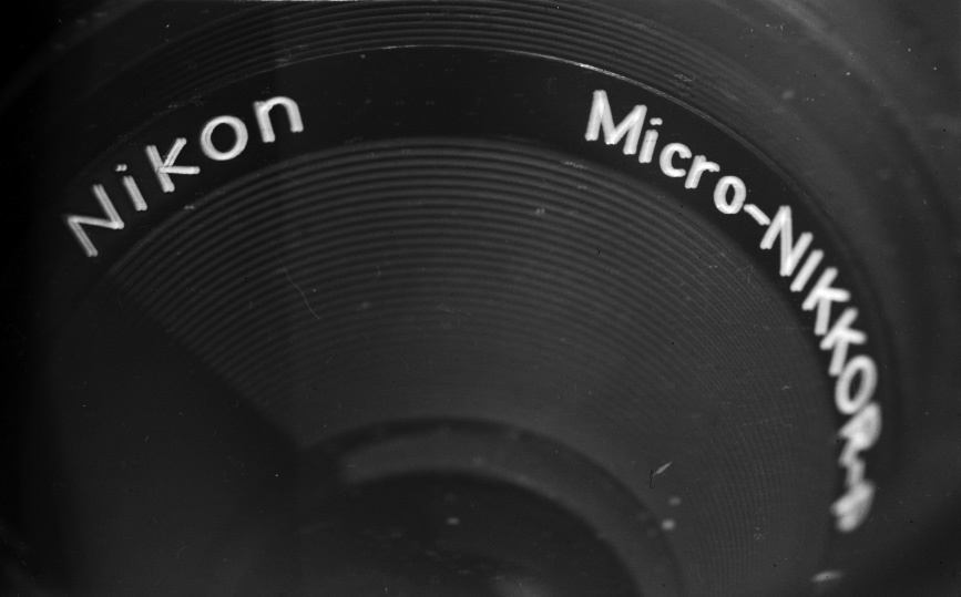

Ok first effort, we made an extension tube for de ole baby 2x3 speed, using an old shortened 1.5" used sink slip joint extension tube that we had lying around.
Still the length had to be shortenbed and cut down to about 3" in order to get an image that could be focused on.
Being white plastic, we then covered it with some black matte cotton cloth, ... photo Gaffer tape to keep the light out, and made a lens attachments out of some old scrap plywood, and some old metal sign material, so it could attach to the baby speed.
Then trying it our the old dang cable release broke, so had to use a pencil to fire the shot ... f11/16 @ 15th sec and you can see some of the camera shake in the Tmy 400@400 image. Developed in D76 1:1 for 9.5 min
Un-cropped or edited of a ... 35mm Nikon Macro Lens ;-)

I agree with 2 things, @markjwyatt :
1) it's not a macro lens and therefore won't produce Macro result, therefore
2) your pic doesn't match the criteria set.
I use Zuiko 50mm 1.4 lens daily and it too can focus at 45cm
I also have Zuiko 24mm 2.8 and it can make focus at mere 25cm away from subject.
BUT
They don't project tiny objects 1:1 or even 1:4, making them useless for macro, mounted the correct way. But you can fix it - I'd urge you to hold reversed in front of camera and making true macro submission :smile:
Here's an easy how-to:
- have a strong light source and a tiny subject, meter the scene and note the value;
- remove lens, set and fix the aperture to your liking and hold the lens reversed in front of camera;
- rate 1 step slower than metered and give shutter priority in your mind - shouldn't be lower than lens focal length +1 stop. Meaning that with a 50mm lens you don't want to be slower than 1/125 to have a chance to capture sharp handheld macro;
- adjust focus by moving/leaning physically against something
- bracket
- WIN!
The Ultron has a bayonet mount filter configuration, and I do not have any components to reverse. Not an issue, I did not read the description completely. I do have plenty other lenses I could reverse, but the truth is I picked my entry for the artistic aspect, and it takes work (in this case probably lick) to achieve! To me macro-photography is more on the scientific side of photography (and that is not where my head is at right now), but in many cases it does produce beautiful and amazing images.

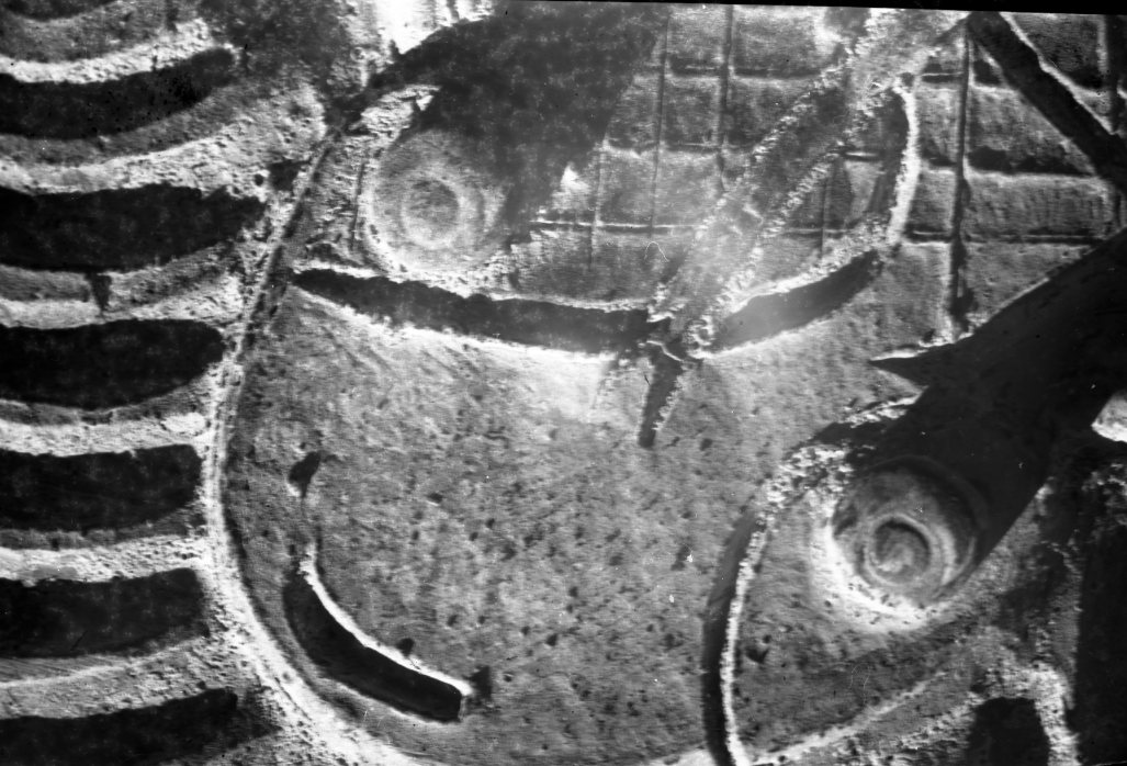

New ... Taken on an extension tube for de ole baby 2x3 speed using a Raptar wide angle 90mm lens f11/8 2 125
Cropped image of two 1" diameter flowers. No editing or sharpening
