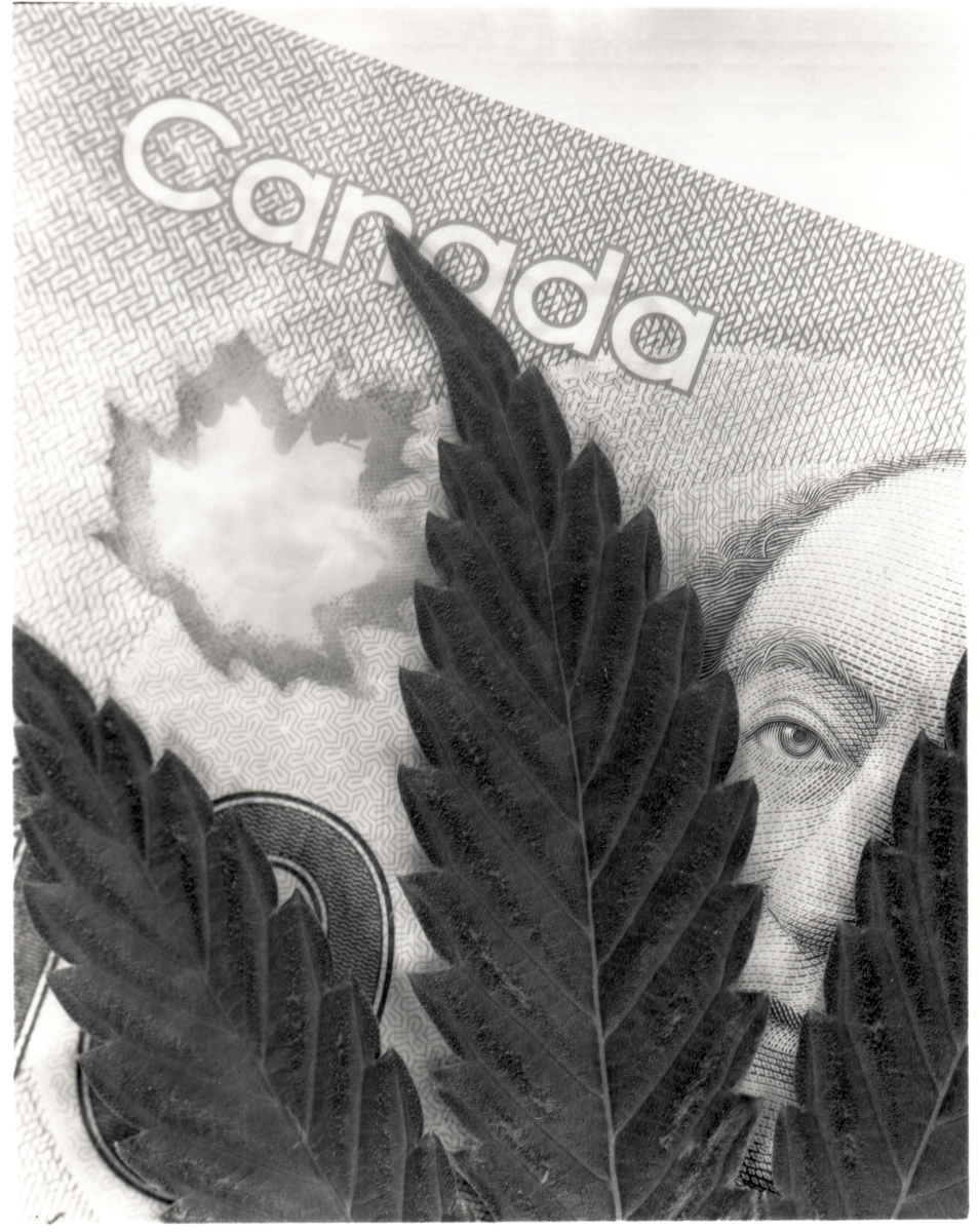

Genuinely new. Today, in fact. scan of an 8x10 print from a 4x5 negative exposed in the mighty Polaroid MP-4. I went next door and swiped a leaf from my neighbour's gigantic pot plant -- actually, I didn't have to go next door, I just reached over the fence. Here we see Sir John A peeking out from between two fresh leaves (that were curling upward under the heat from the lights). This is on Kodak Contrast Process film - 16 second exposure - developed in dektol. Magnification? About 200%.

This is very creative -- cool shot.
