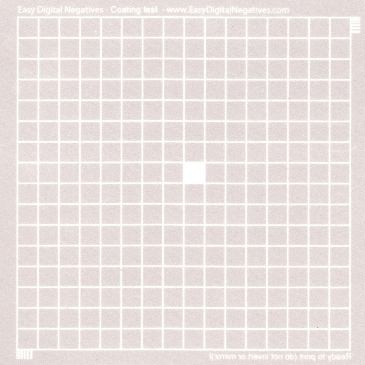

I've just started making salt prints and my first attempt at the coating test (tests consistency of density at 256 points on a print) failed miserably. One side is ever so slightly darker than the other. While it's a disappointing result, it's better to know how to coat properly before starting to read step tablets in order to make curve corrections...if not, you run the risk of basing corrections on inadequate/improper densities.
Using brushes so far, but will try a glass rod to see if things get better.
Have made a 256 step gray tablet at max black time, and the last step with a hint of density is #247...that's with an Epson P600, through Harrington's Print tool & Epson Advanced Black & White mode set on 'Light' print density, with yellow set at 75. Pretty close, me-thinks. The dark end occupies most of the print, but that's where the curve correction comes in...which I can do after learning to coat consistently!
Anyways, that's all I've got so far...anybody have experiences/wisdom to share?
Here's his website: http://www.easydigitalnegatives.com/
...and his book: http://www.photomrhar.com/portfolio...ditionhistorical-and-alternative-photography/
Here's what my coating test (which came out pink-ish when scanned) looked like:
At first I thought it looked pretty good (except for the dust speck) but after looking a bit closer, the right side is a wee bit darker than the left. When the file was read on the EDN website, it showed the classic 'sawtooth' pattern indicating one side being lighter than the other.
To confirm, went back to Capture One and read the cursor #'s for the colour red, and the right side is 229 while the left side is 233.
Darn sensitive test.
Now the question is...was it the salt coat, the silver nitrate coat, or both? Lotsa fun nonetheless 😁👍

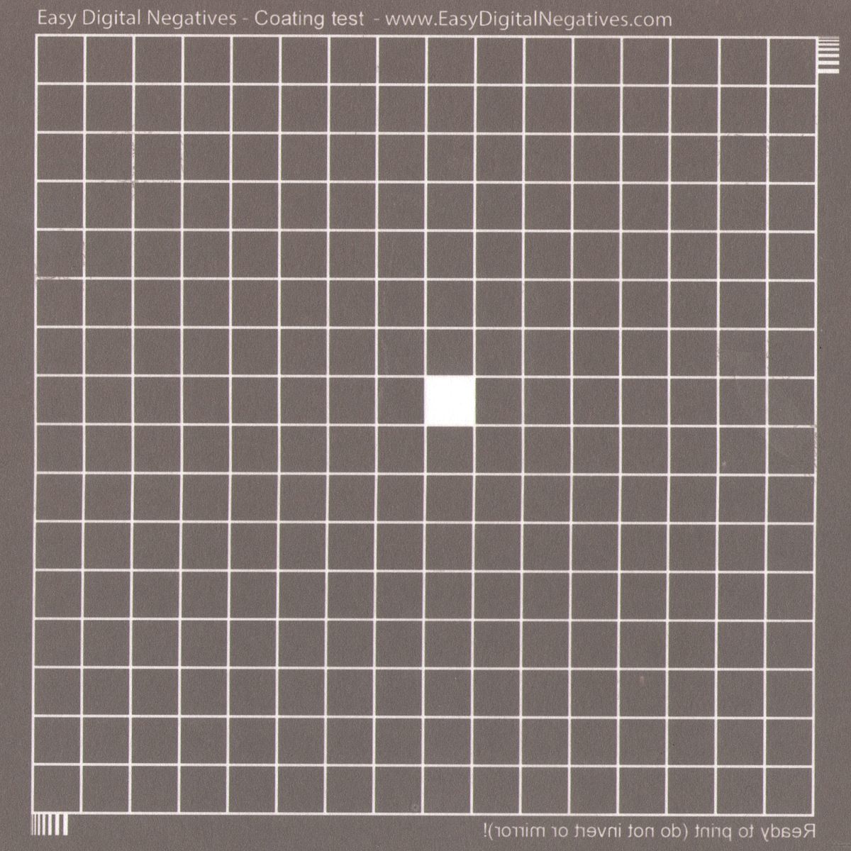

Bit of an update for those who can't help but slow down and gawk at an accident scene. Hadn't noticed before, but the paper was bowed, or curved after coating, so that could also explain why there was more density on the edge.
Level coating and drying surfaces...check.
Tacky surface on sheet of glass to hold paper flat while coating...check.
Objects placed on print edges to hold paper flat while drying after removing from glass sheet...check.
According to the EDN website (as I understand it) anything above a 3% failure rate is considered poor. My first one had an abysmal 29% failure rate, but the one below is 6% so I consider that good enough for now. There is a faint light blob midway on the right side and some dust specks, so I think without those imperfections the score would have been better. I'll do this test again after playing with images for a while, before getting serious.
Only took a couple days and figure it will pay dividends later. The race is long...

Even the scanner can add artifacts because of cross-reflections. Turn the paper around 90 degrees and see if the relationship holds.
:Niranjan.
Thanks for the suggestion.
Gave the print a 180 degree spin and scanned it again. The pattern of errors wasn't mirrored on the left side of the graph this time, and the percentage of error dropped from 6% to 5.28% with the same print.
We have an old copy/scan/fax machine...looks like an upgrade is in order. Might try the copy stand & digital camera route next, to see if that's more accurate before shelling out the money to buy a better designed scanner.
If I understand correctly, the error didn't move with the paper but it stayed at the same side as the scanner. If true, this would mean nearly all your error now is basically induced by the scanner and your coating is pretty good.
What if you add the two scans - you can do that in PS if you have. Rotate the second one back, move it over the 1st layer, align and then give the 2nd layer 50% opacity, flatten. Let Mrhar look at it again.
Most likely you are getting the reflections on the side that has the white cover over the glass. You can may be get better data if you center the print and put a matte black board over it so the reflections are minimized. I do all my scans this way. I think this problem is not any different on high end scanners - I have the Epson 3200 and it's an issue there also.
:Niranjan.
:Niranjan.
I did centre the print and covered it with some black material when scanned. Don't have PS.
On the EDN website, when the file of the scanned print was uploaded, there were some larger 'sawtooth' patterns on the right hand side of what should have been a horizontal line. When the 180 degree turned scan of the same print was entered, there was no repeat of that pattern on the left side of the graph.
My assumption is the scanner has a large margin of error and can't be trusted. Will try the copy stand later.
