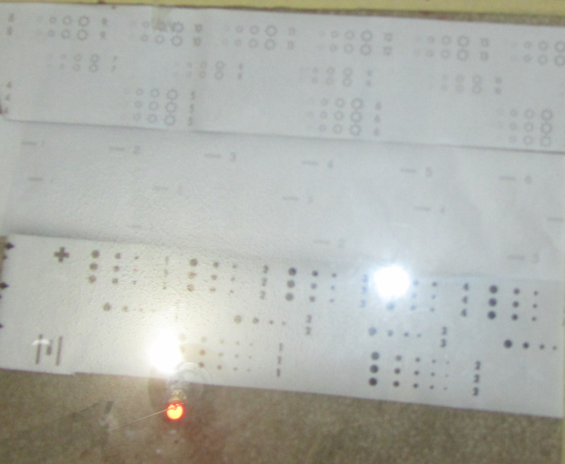

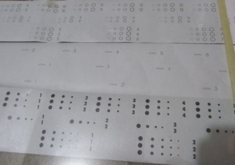

top to bottom 120 backings, HP5+, Kodak Ektar 100, Foma 400
The second one with the flash overkill gives a good approximation of what I see in my Mamiya 6 frame window with Kodak films in bright sunlight. Almost nothing. Lame. And they don't even give you the little warning spots like Foma and Ilford do so you know the number is coming. Double lame, especially since I bought this camera specifically to use with Portra 400. (which I assume is the same as Ektar, but I couldnt find a Portra backing paper because I've been sending color out lately.)

So each picture shows the 3 sets of backing paper and the second set is the same three sets in bright sunlight?
If this is correct then the Foma looks to be in a different league I wonder how it manages this without wrapper offset? I'd be surprised if EK did not at least make inquiries of Foma but then again I have no idea if there is any form of discussion like this between these companies - perhaps not A pity if there isn't in cases like these

These are all indoors, the 2nd image just has more direct flash that I think simulates what its like reading the Kodak numbers in bright sunlight. Its literally almost impossible on my Mamiya 6, unless I bring the film plane towards the window after every shot, then its just more difficult than it should be. It may be easier with fixed film plane cameras, but I don't have one to test it on.
