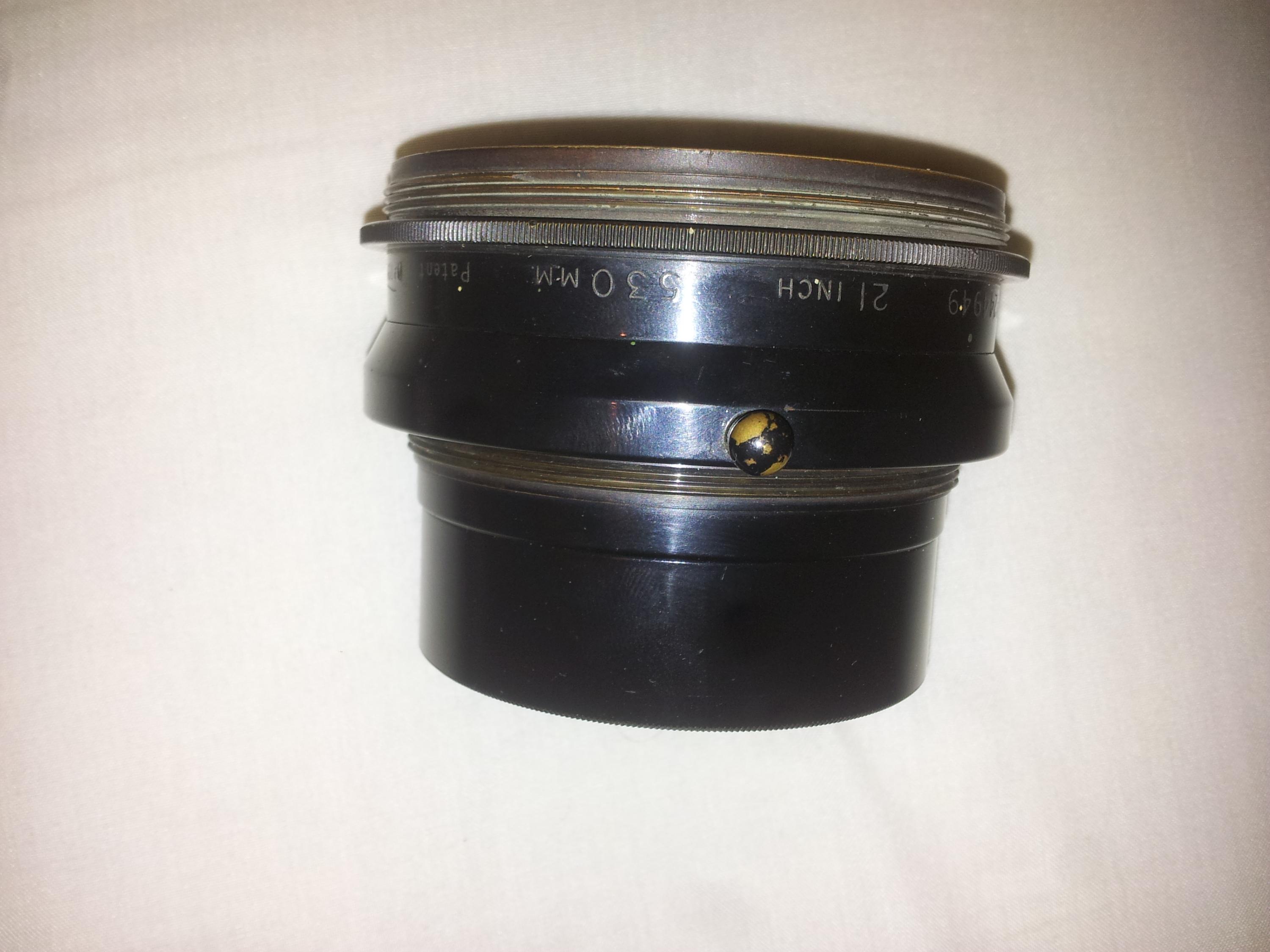

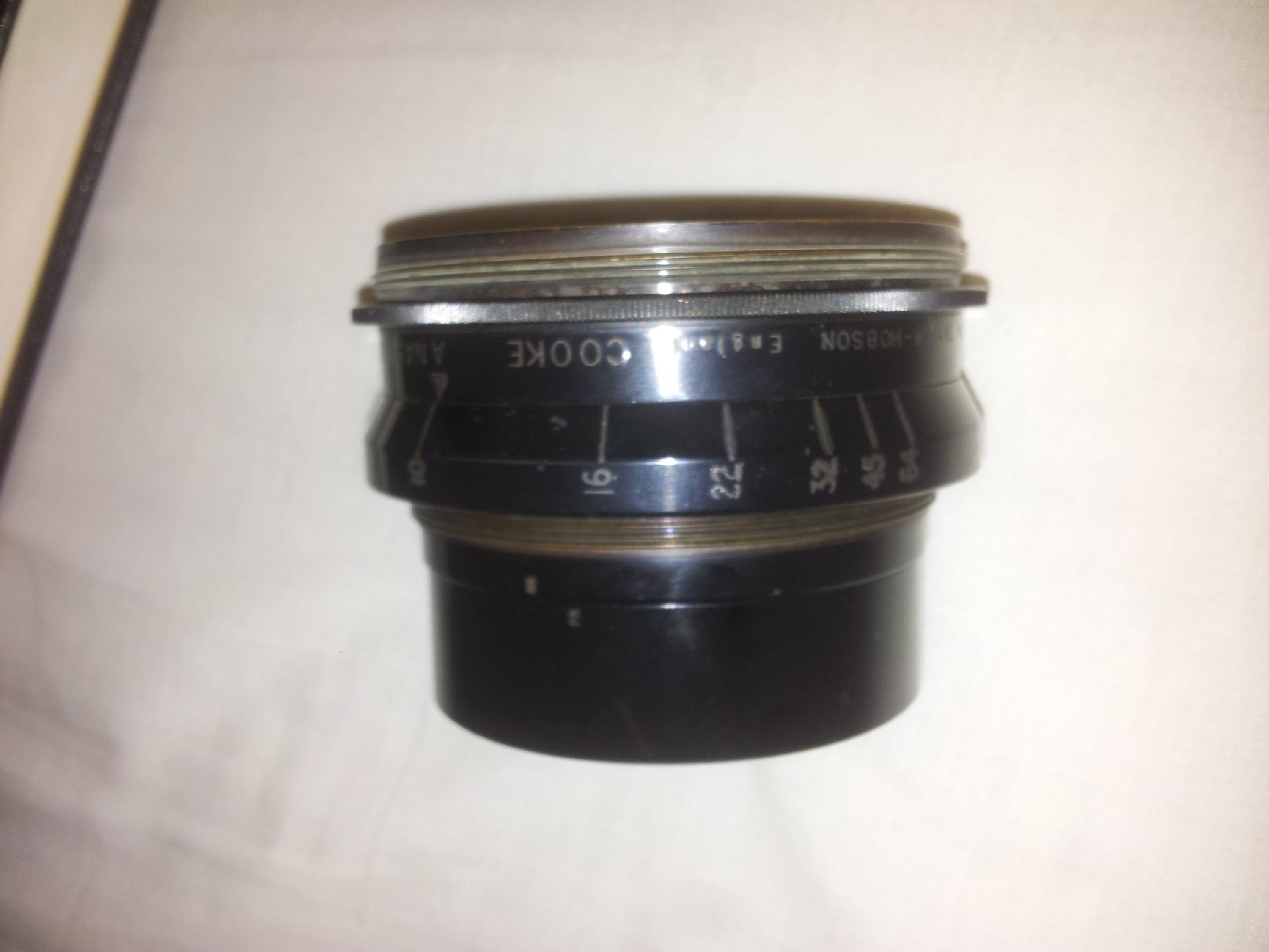

I have too a Taylor Hobson anastigmat 21inch, but only have the objetive, what it´s the mounting flange or ring do i need, and the lens board?

I can't see a 21" Anastigmat in my TTH Cooke literature is it the f10 process lens ? There's no flange size listed but I may have information somewhere else. TTH made standard flanges so it should be easy to measure you lens.

Yes, i think it´s rare lens,it´s f10

And the same for the Hobson Taylor, copal 3 and mounting flange and mounting ring(how many milimeters have this lens,sorry i havent caliber)

I don't think it's a rare lens, rather that it's a Process lens primarily for the reprographic industry, but TTH do say the lenses can be used on View ad Commercial cameras as well. Coverage is 12"x15" at full size (1:1) , 10"x14" at half size, so probably only 8x10 at Infinity.

Not really, I have nothing with the specification in terms of flange size, however somewhere I have a list of the TTH flange sizes and they were consistent and remained unchanged with time.

One good thing with large diameter lens is the hole in the board only has to be slightly larger than the lens. At that point it can be held in place with an O ring or even tape.
You can use a drop shutter on the front if you like.
Yes, it´s good idea, maybe it´s better and more cheep build a lens boad more width
I think its 75 mm

I wrote to taylor hobson and they said to me that it´s a II war aviar lens,
