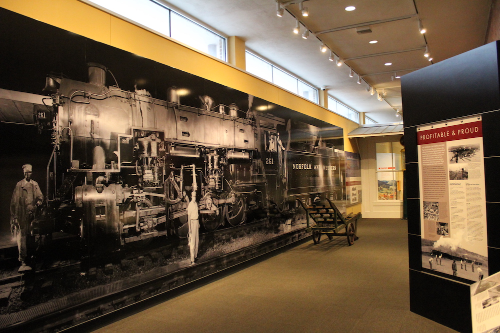

Have you heard of O.Winston Link? If not look him up. But you probably have seen his photographs. He used a 4x5 Crown Graphic to photograph Steam Locomotives at night with a gazillion light bulbs. His pictures are in the Roanoke, VA railroad museum. One of the (from memory) is of a life size large locomotive and tender. Huge. Anyway you should get yourself down there to see it. Failing that I would call the museum and ask them how they mounted it.
O. Winston Link Museum​
  • 101 Shenandoah Avenue NE
    Roanoke, VA 24016
  • Phone: (540) 982-5465
