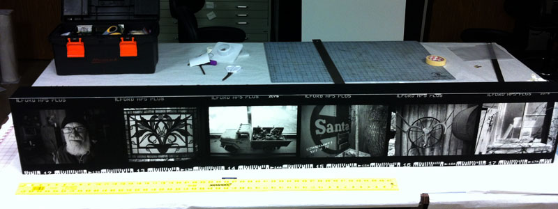

Update from original post. Print is 10" X 60" and was mounted on a box made of 1X4 lumber and masonite. Sides painted black. Print stuck to box with either a gloss or mat medium (Golden) and then weighted down to dry. Looks great. Was not intended to be archival. If it lasts 20 to 30 years it will outlast me. It is a piece in a show to give context to the other work. There will be two other similar presentations in the show. I will try to remember to post images here. Bill Barber

As I was the one who stated this thread I'll post a couple of images of my nearly completed mounted print. Frame build of 1X4 lumber. Masonite top. Sides painted black. Golden gloss gel cut with water. 80% gel/20% water. Brushed heavily on the masonite. Print applied to masonite. Rolled with paper protecting the print to even gel. Weighted down overnight. Edges trimmed. I still need to run a black marker around the edges to get rid of the white line from the paper trim. Image is six consecutive frames of 35mm to give context to 18 other images about this person. pano3.jpg

As I was the one who stated this thread I'll post a couple of images of my nearly completed mounted print. Frame build of 1X4 lumber. Masonite top. Sides painted black. Golden gloss gel cut with water. 80% gel/20% water. Brushed heavily on the masonite. Print applied to masonite. Rolled with paper protecting the print to even gel. Weighted down overnight. Edges trimmed. I still need to run a black marker around the edges to get rid of the white line from the paper trim. Image is six consecutive frames of 35mm to give context to 18 other images about this person.View attachment 85160
Looks pretty good, I'd say. Great idea! :smile:
thanks for posting this !
that's impressive, and must be something-else
in person ..

Thank you for your kind words. The exhibit is of three individuals I have known for some time. Each, in their own way is a collector as am I. Some might say hoarders. Each of the three is printed in a different alternative process. The three used are cyanotype, kallitype and ziatype. These long pieces are used to give context to the person and their stuff. I'm not complete with the printing however expect to have about 50 images in 20 X 24 frames in addition to the three context pieces. Although I had no intention of making these three as archival prints, I imagine with the gloss gel between the masonite and the image, they should last for some time. They also were not made to be sold. I began this thread looking for answers and have included the answers of "How to do it" should anyone else decide to undertake this relatively easy project. Pretty sure I may do this again in the future. Bill Barber

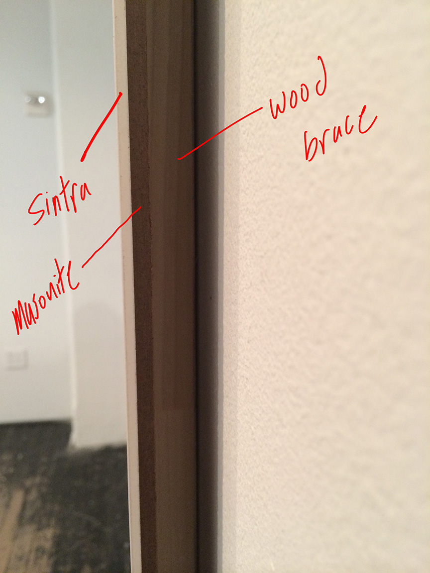

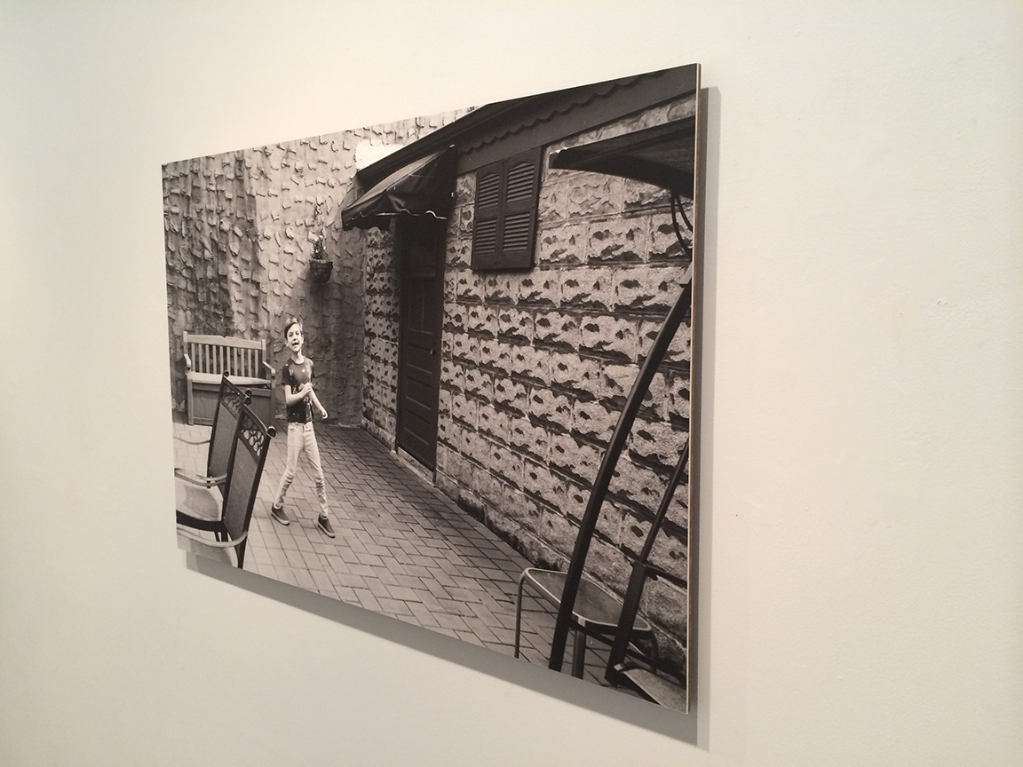

I was looking into masonite and a friend of mine has forwarded this solution he saw at a gallery in NYC (sintra on masonite). Printed and mounted by Laumont. He said it looked great. Laumont have confirmed it was their job. But generally it looks like mounting shops avoid masonite for some reason.

If the term "archival" happens to come up, masonite is a big no-no.
