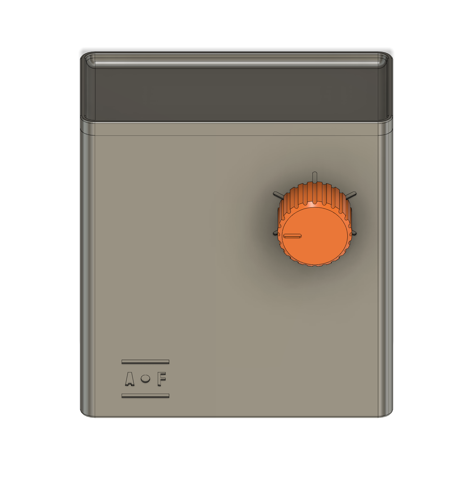

I have solved the problem with a 3d printed solution. Easy to assemble, easy to mount as it uses the profile on the wheel of the lab box for traction.
The device is only measuring 5x10x13cm and portable because of the AA battery pack implemented.
It can be downloaded for here for free: https://www.thingiverse.com/thing:6919853
