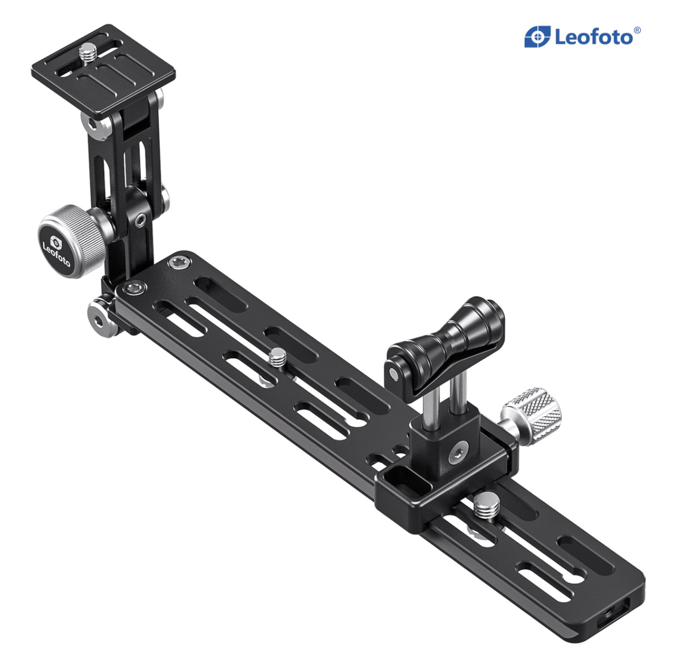

Something like this.
Manfrotto Hex plates have set screws which could help. There are a thousand and one Arca-Swiss type plates and some have multiple mount screws with adjustable position. Or there are elaborate contraptions like above which can help if you don't have appropriately placed mount points on the lens.
