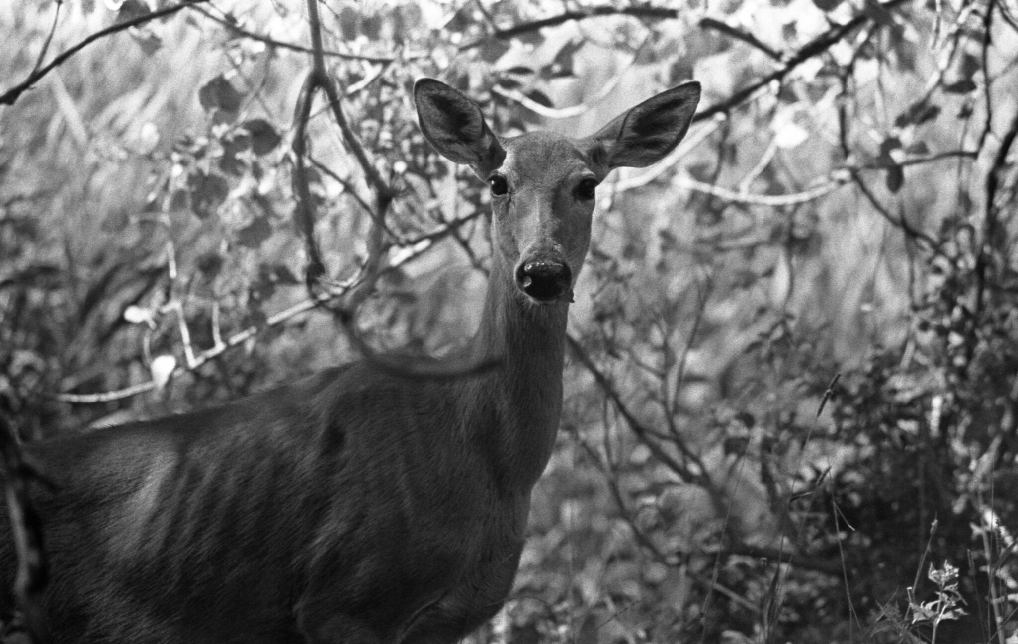

I don't think so, I'm using tripods/monopods, 1/1000 shutter, and minimum focus distance for some shots, the 500mm Kimunor also suffers from very heavy chromatic aberration so I only use it with black and white. Even with f/16, it achieves about 2 megapixels of detailed resolution, maybe good for a 7 inch print. My cheap Epson flatbed outresolves it.

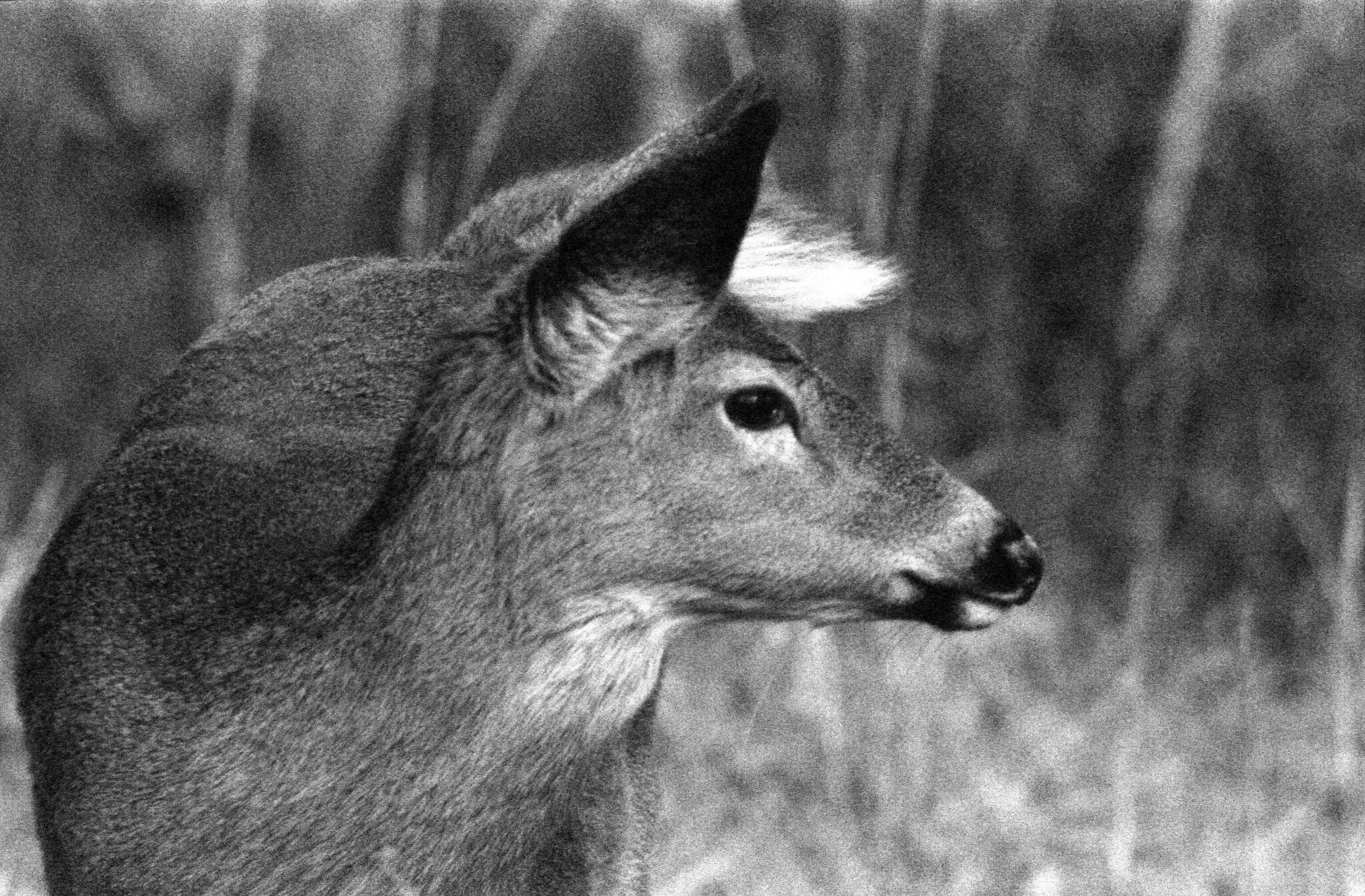

Here's an example 35mm frame, this is about as sharp as it gets. I compared it with an off-brand 70-210mm f/3.8 lens and at f/8 that lens is achieving around double the dpi even though it's nothing special.
Compared to 70-210mm f/3.8 @ f/8:
