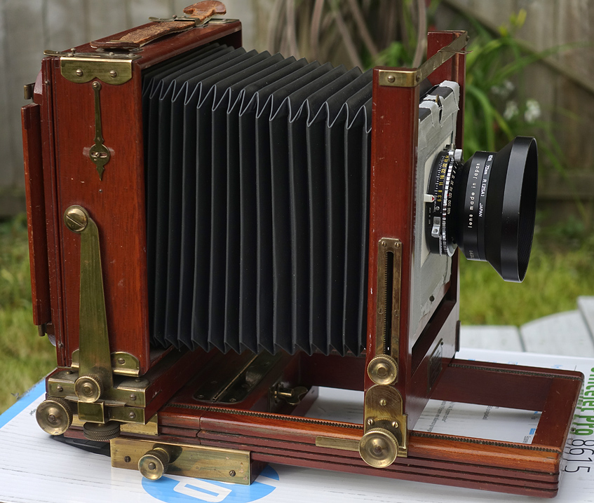

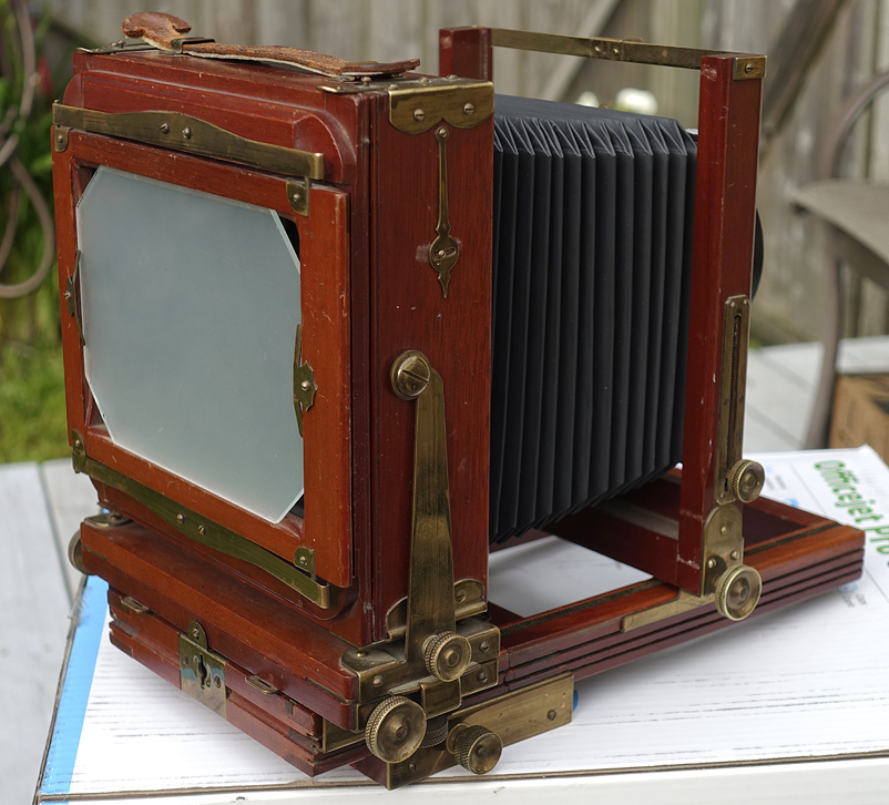

Eastman View No.2. Just rise/fall in the front, but I can get what I need via back tilt/swing. I do not have the back extension rail, but the longest I use on it is 250mm, so no issue there. I have the sliding block .. which is very nice to have -- and on the 2D, also, if you go that route. It makes the whole camera a bit more stable by bridging and stiffening the hinge...and centering the weight over the tripod.
The second photo shows how it bridges the hinge nicely.
The geared movements in the back (tilt and swing) are sweet. Light camera, 7.75 lbs (add another pound and an ounce with the FujiW 180mm and board)...but then I am use to 8x10 and 11x14s. My 4x5 weighs 2.5 pounds with the 150mm/5.6 on it.
I would like a modern version of this with front movements...the new Chinese offerings come close (non-folding 5x7) but either have no back movements, or are horizontal only or some other deal-breaker for me. Saving me money, though!
