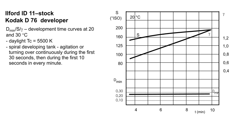

No wonder. Check out foma's tables. At 6:45 minutes in D76 straight, you're developing for a very high gamma. The film is effectively being pushed. Did you print those negatives? Which contrast grade did you use?
Real ISO of this film in D76 is about 160 (check the curves).
MassDevChart has wrong info in some places.

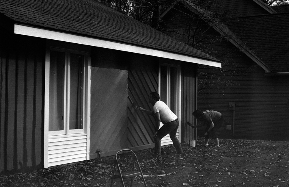

I have no way of wet printing, yet. I've only made scans. I'll post one tonight.
This is a jpeg from the TIFF scan, no modifications. Not a great photo, but I can see detail in the shadows.
