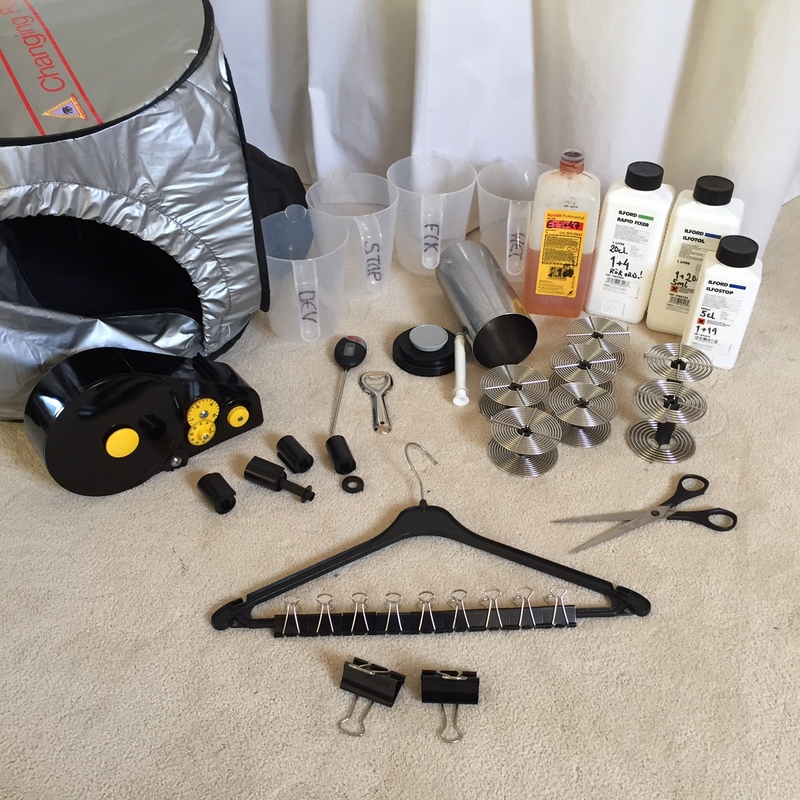

This is what I use and I think it is a pretty basic setup.
Dead Link Removed
The cost (excluding the changing tent) was less than 100€. I got the tent because I don't have any room where I live which I can make sufficiently light-proof. I hang the films in the shower using a hanger and simple metal paper clamps. I use the big ones as weights at the end of each roll. The thermometer is a digital one because I want quick readings. I've used analog ones too but find them a bit tedious.
The bulk loader is bigger than may be needed. I bought this one (Alden 200) because I wanted to bulk load Kodak 5222. The cassettes are simple plastic reusable cassettes but one can also re-use ordinary film rolls.
